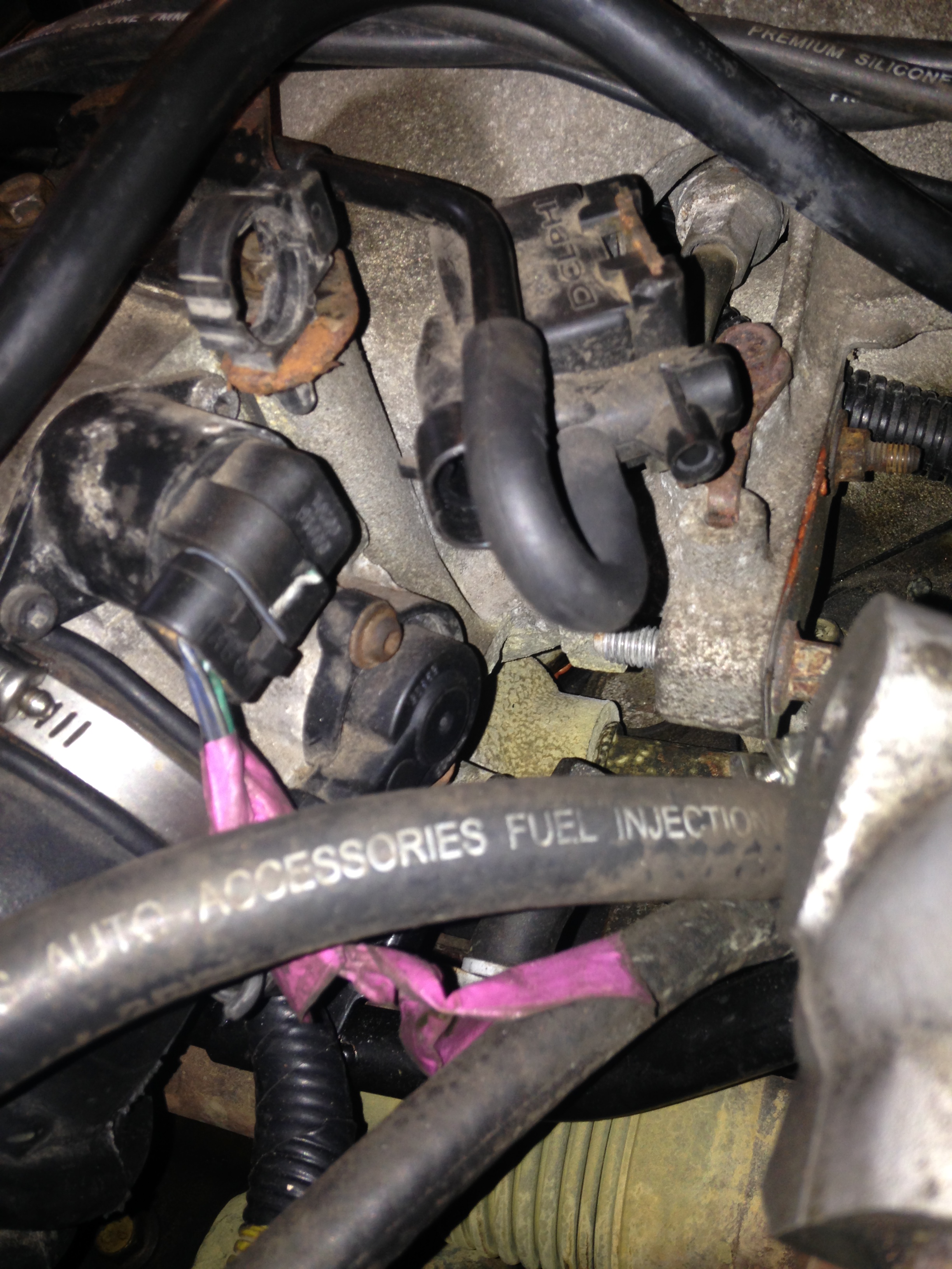

Here are some quick pics i snapped this morning of the throttle body area, what exactly are you looking for I was unaware of any changes to this area for a 3400 swap, but would not be surprised if i missed something.

Those pics do nothing for me.
If you can and should be able to post of the pictures of it not attached exposing the back side of the TB and the face of the UIM mating surface I can better explain anything should I see something.

First off, the fuel pressure regulator nipple should go to a vacuum source... its NOT supposed to be 48PSI constant, it should drop at idle. Second that solenoid you have just sitting on the back of the intake is a newer purge solenoid... you need to re-run the line that's there to where ever you have your current purge solenoid, (if it's a stock MPFI car I believe those were on top of the canister)
