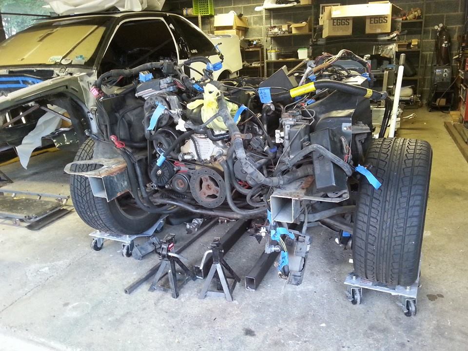

Just more cutting .......floor and front wheel wells of the camaro narrowed down to 48" ....camaro front rad support and frame rails next to go under the knife

removed rad, and overflow bottle, battery tray and air filter to clear some room up front........ front rad support and frame rails cut.

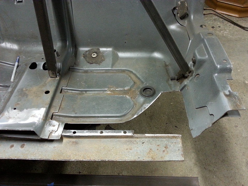

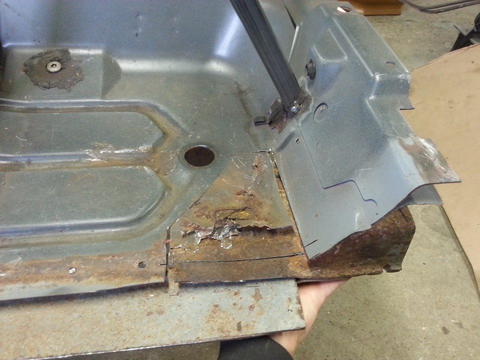

Cut out all the rot on the rear floor pan and cut the rest of the old rusted rear subframe out from under and replaced the new floor section ......almost ready to set in the body rails

yeah.....rust sux!!!! but its gone now .......got another spot/spots to touch up on the front floor pan too but over all i think the rest is fairly clean........ either way im not gonna let it stop me

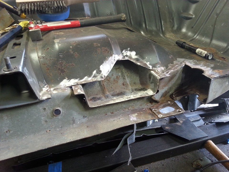

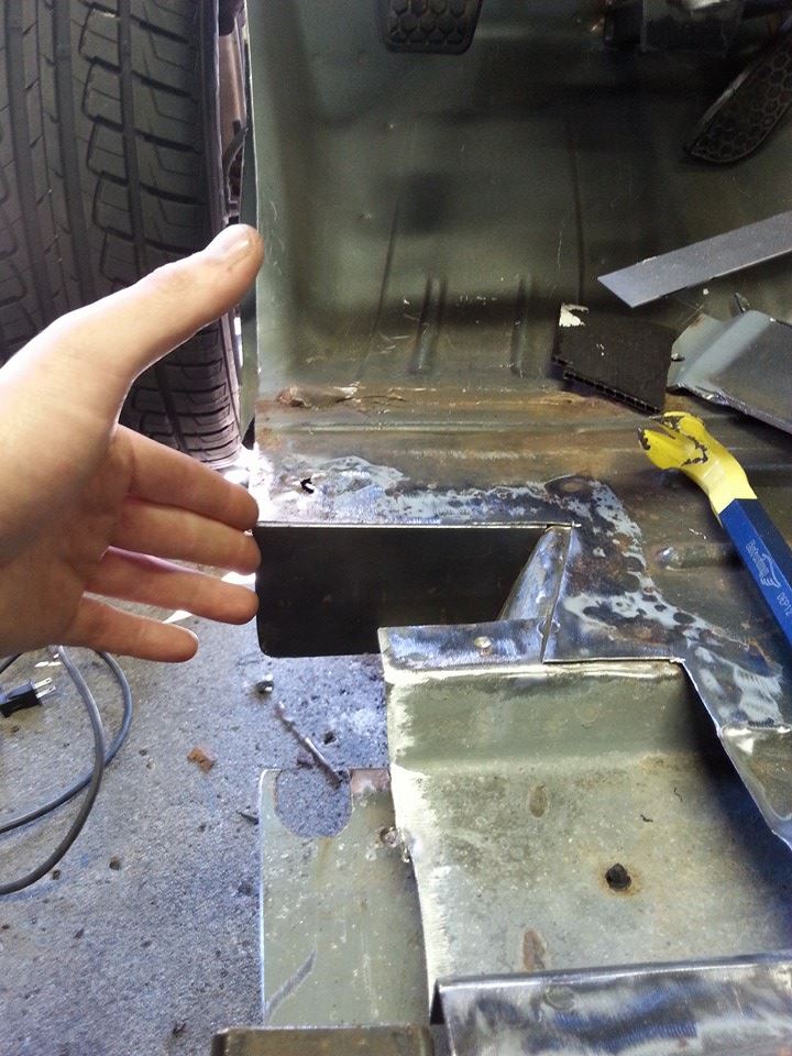

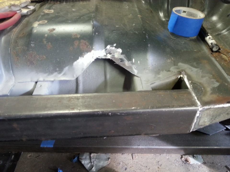

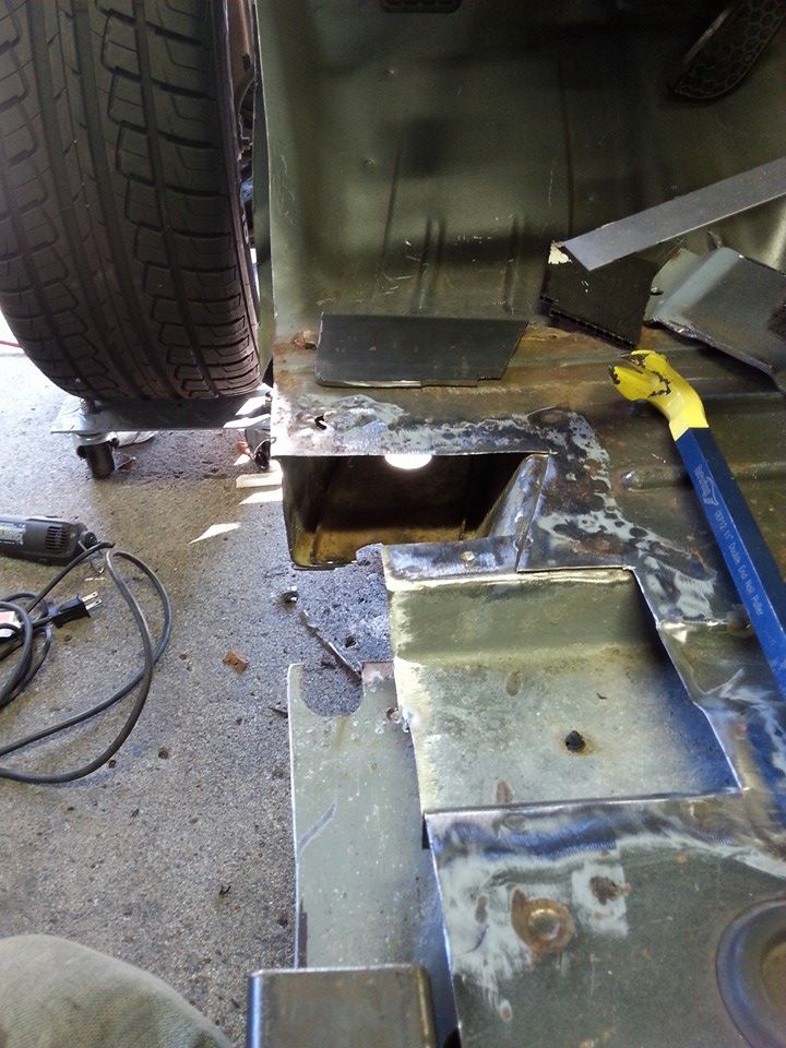

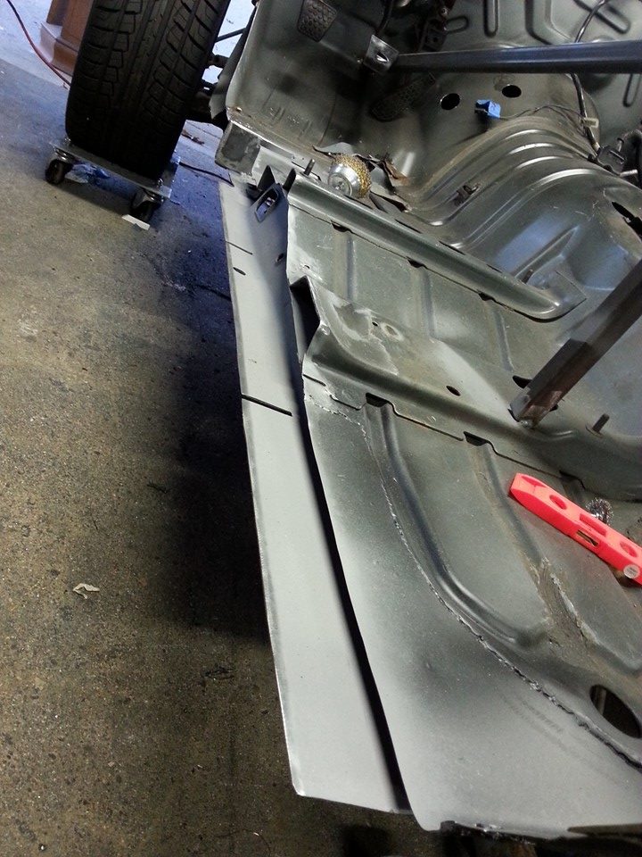

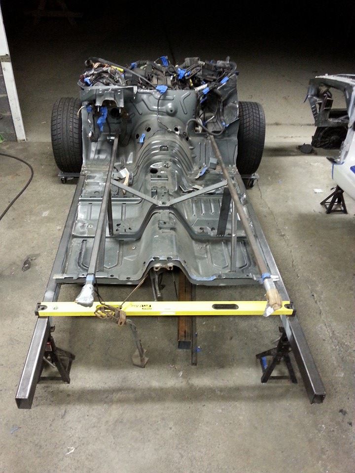

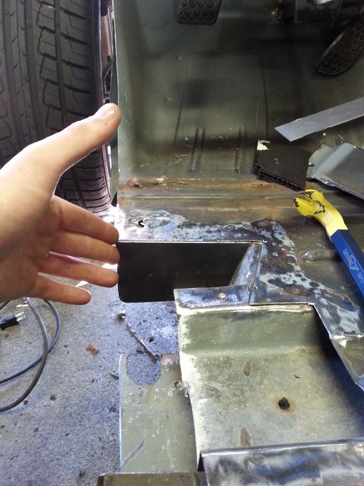

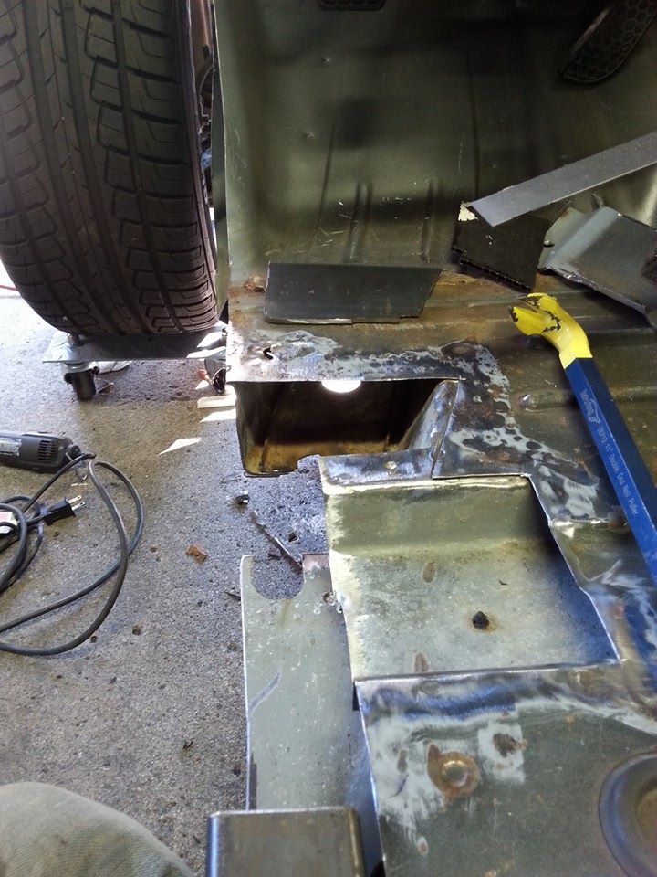

Front frame rail block off/tie in plates mocked up and final fitment of body frame rails. opened up the little windows on the floor pan so i will be able to weld the cross members into the rails for extra strength too.
driver side
jjanke
Posts: 425
Re: Beretta Z28
Post by jjanke »
passenger side

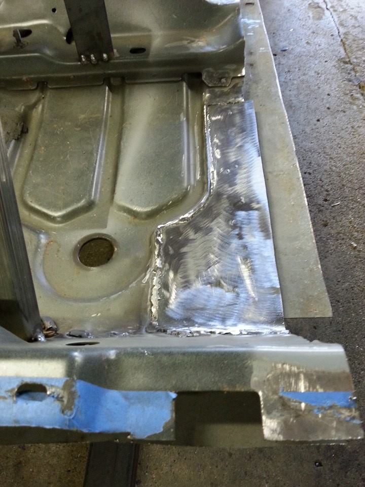

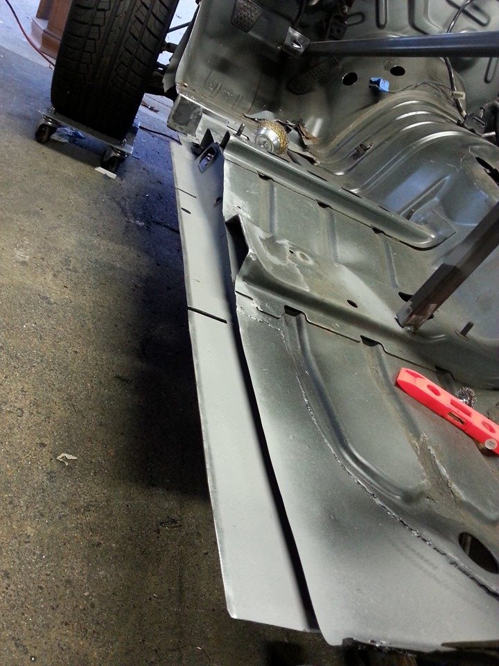

Cleaned up the old rail inners and welded in new body rails on floor pan....
