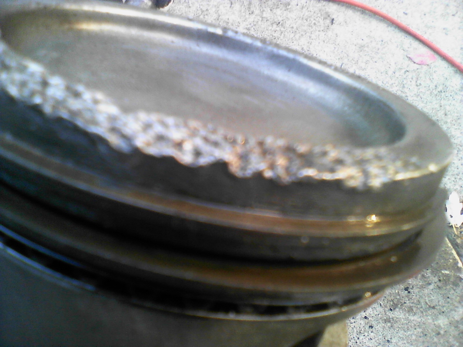

the pistons are already pulled out and their rings replaced. signs of detonation?

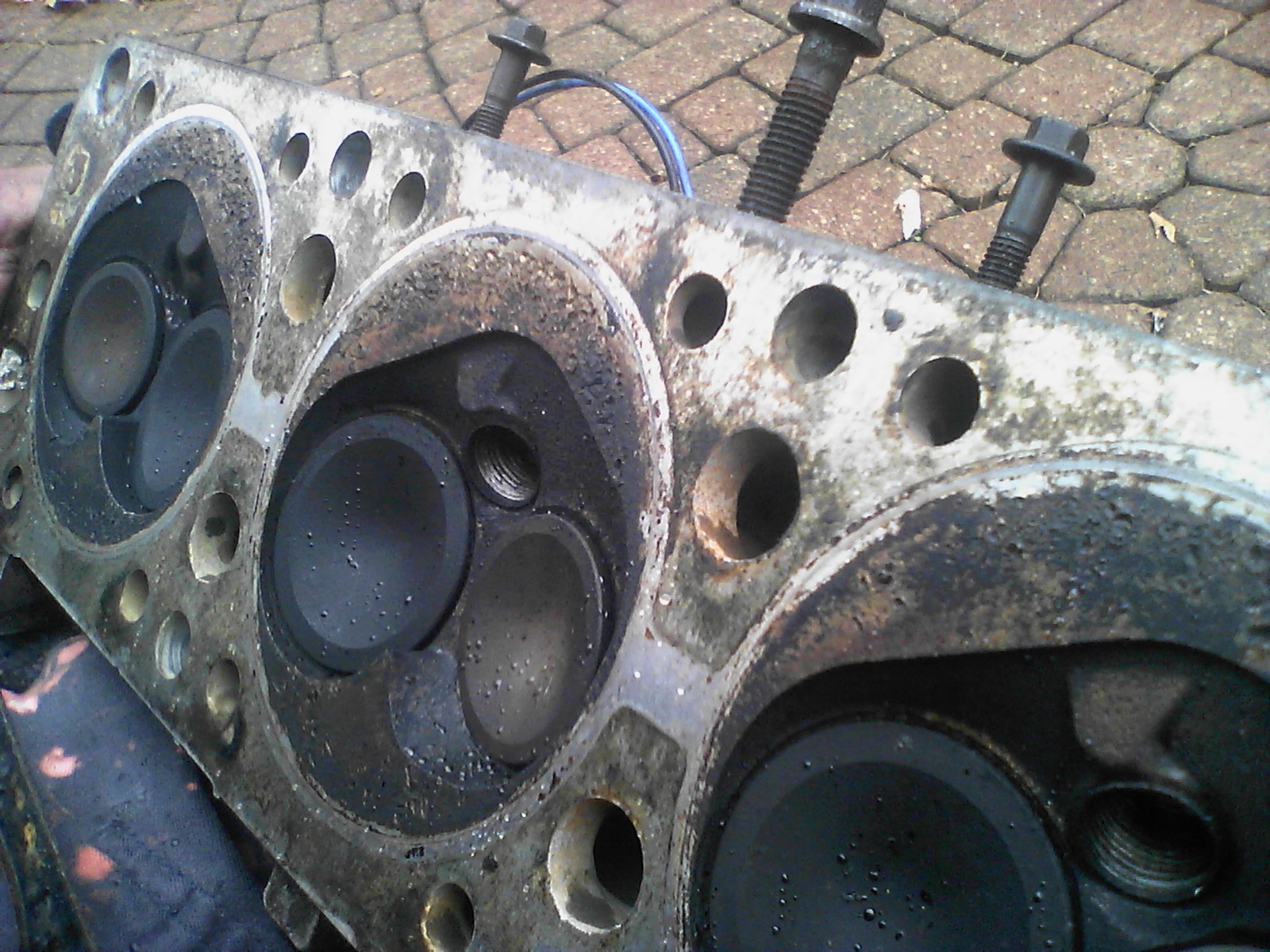

the valves have carbon accumulation. i will post pics soon.
the three damaged pistons are all from the same bank. the other three pistons have no damage.

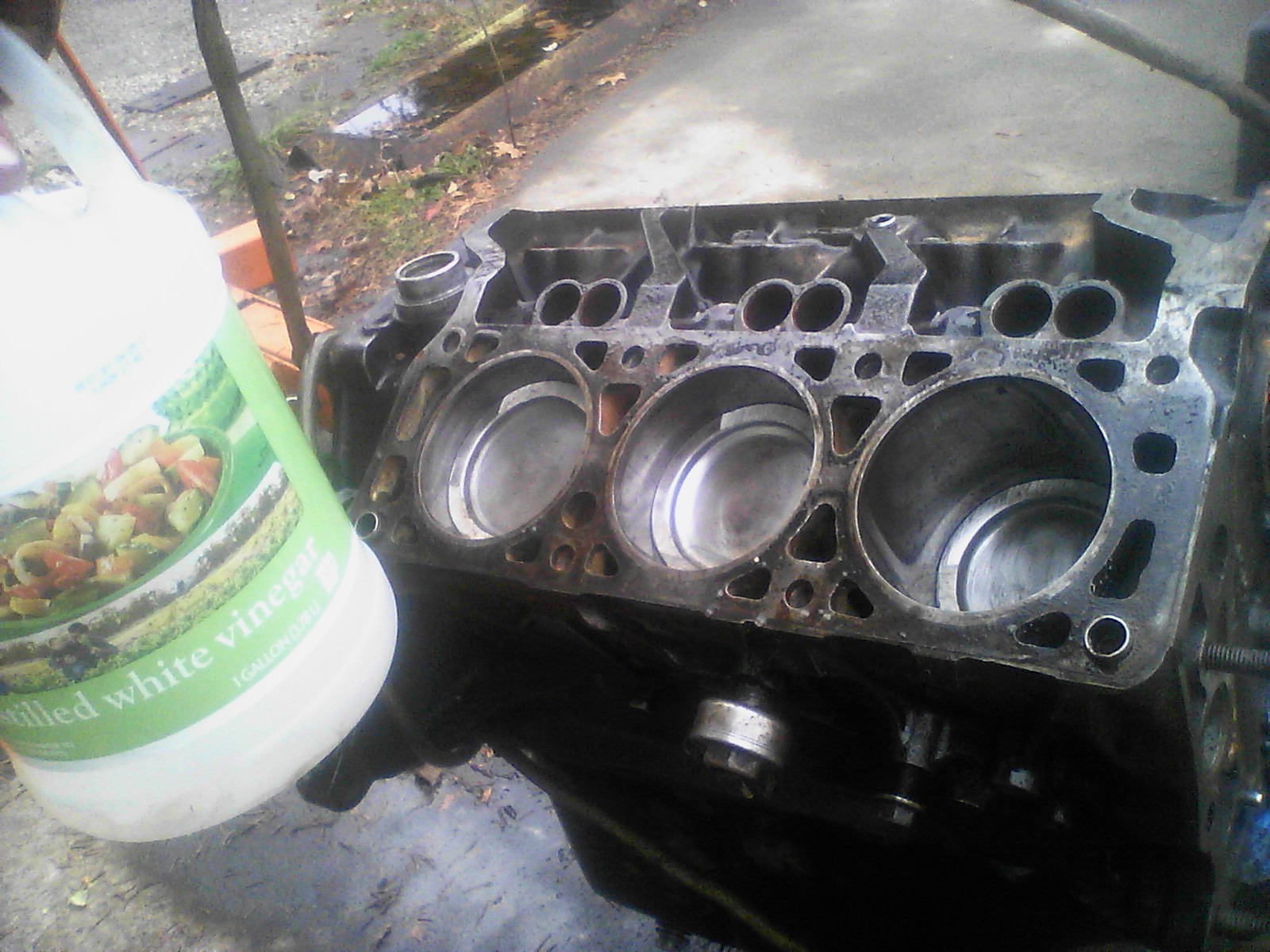

the water jacket needs to be scrubbed out. distilled water should be used, and i never did. mineral build up is present, the rubber hoses' innards are coated with a thick white substance, probably calcium. this impedes normal cooling of the engine.

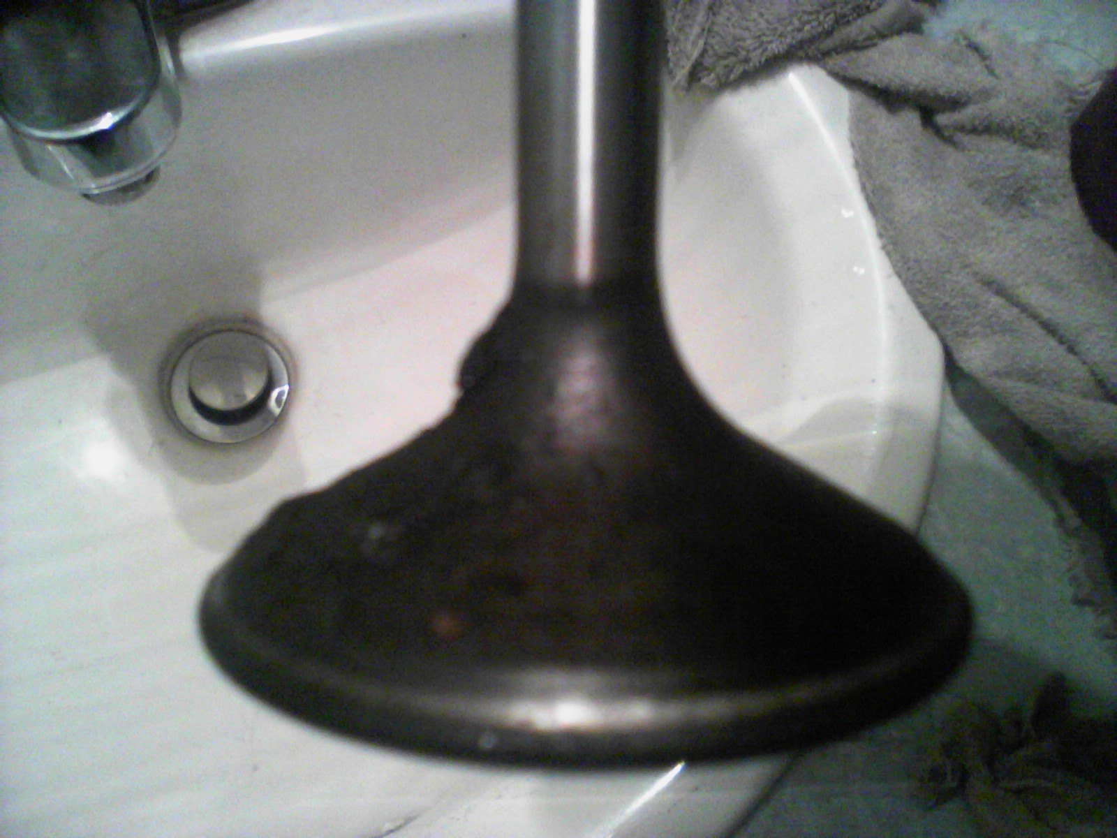

today i removed the valves and springs. brand new springs have been ordered.
wish i could have used my expensive tool set, but it was just too hard. so instead i
used my ten dollar tool from Harbor Freight. that was slow and tiresome, but
now all twelve springs are removed.
the valves have a bit of carbon accumulation, the pic is showing the worst case.

So you are going to restore the whole car?
Are you going to replace those pistons?
They look pretty beat. Strange how one side is beat and the other
look okay. Do you think the overheating was worse on one side and that
is why one side is so beat up?

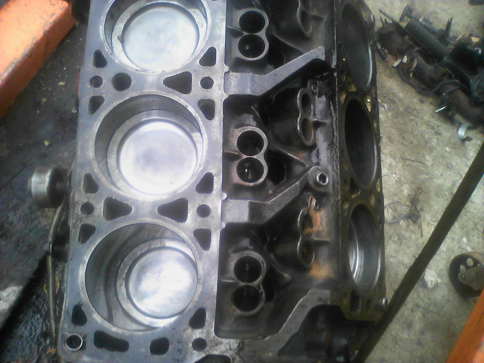

How do the cylinder bores look? Do you have a large ridge at the top?
Usually, you just can't replace rings without bore and hone of the block.
The rings will never seat. (ask me how I know)
Anyway, good luck, you have a lot of work ahead of you.

the pistons have no cracks, so i used an angle grinder and shaved off
the rough areas. the damage was very shallow, maybe one millimeter
in depth. only one bank was damaged, along with the head shown above.
the other head had no damage at all. maybe the cause was too low of a coolant
level?
also for the past five years, during cold weather, i have noticed steam arising
from the engine just after start-up. but the head gaskets are in good shape,
with no cracks in the heads.
the bores had no ridge on top, and i hope the new rings seat okay.

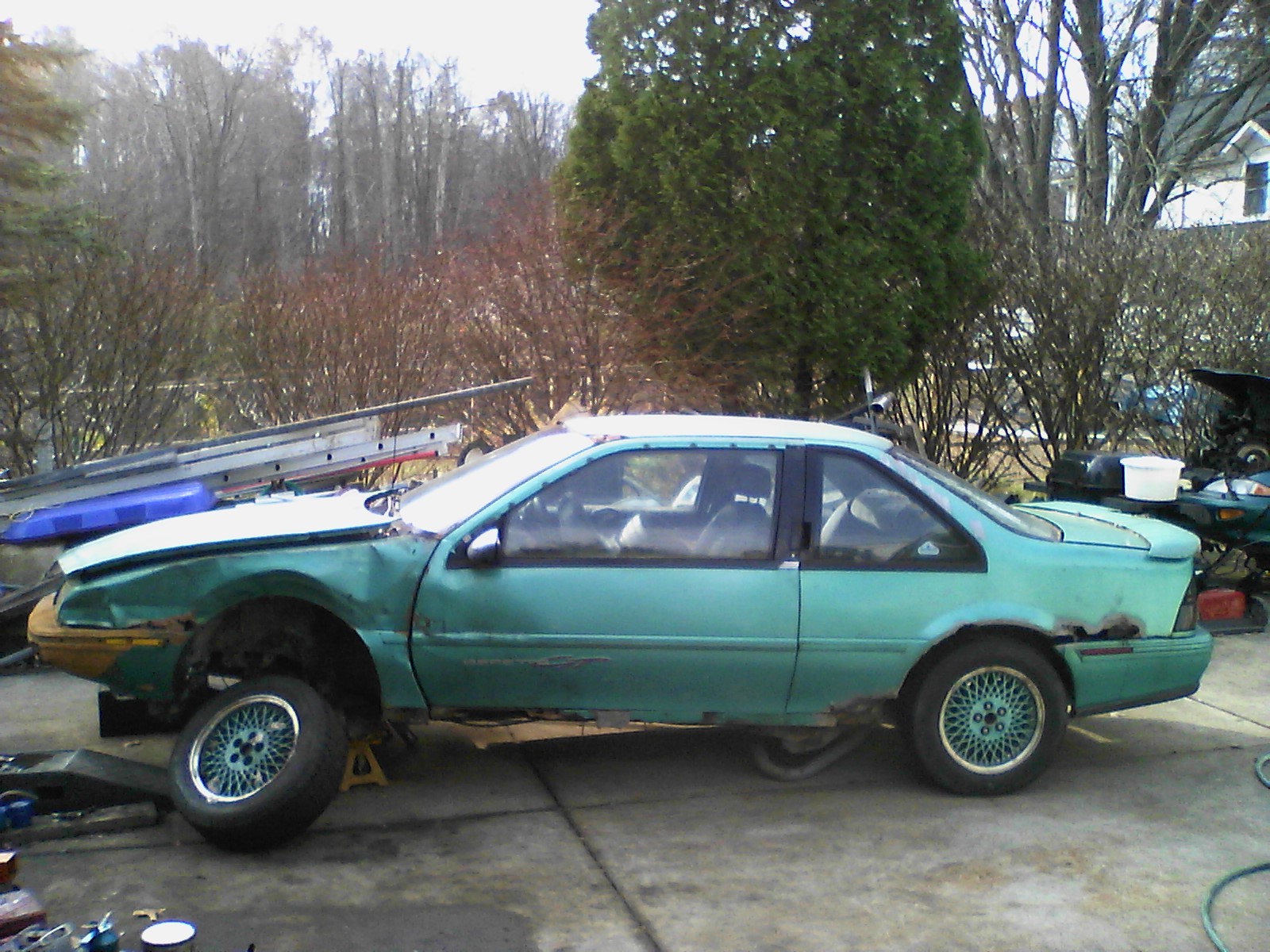

the car body is beyond repair. wish i was a body man. too much rust.

some close-ups. the white vinegar is used to clean out the water jacket,
and it will soak overnight.

Looking at the photos of the pistons in the block did you just grind down the tops of the pistons where the pitting was? If so that was extremely stupid because now they are all odd weights and totally out of balance of each other and you also shortened up the top ringland which could result in a cracked piston.

This whole thread is a joke right?
At 200K the rings will never seat without at least a hone, and yes taking a grinder to a piston is pretty stupid from someone who proposes to know what he is doing. (He obviously doesn't have a bloody clue!)
