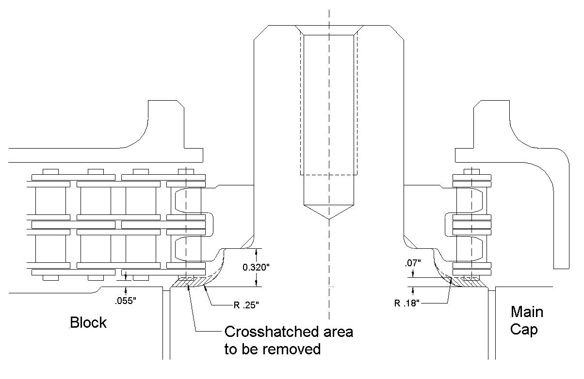

I did send it back when everyone else did. I haven't looked at it beyond seeing that the gears appear to be heat treated now. What do you tell your machine shop so they machine your crank for the new sprocket?

Also the TCE sets were always heat treated... He just had them black hard coated before sending them back. Flip over the cam gear and look at the slots near the center hole, those were originally not there. And regarding the crank machining, just give them this print.

Thank you very much for the diagram!
