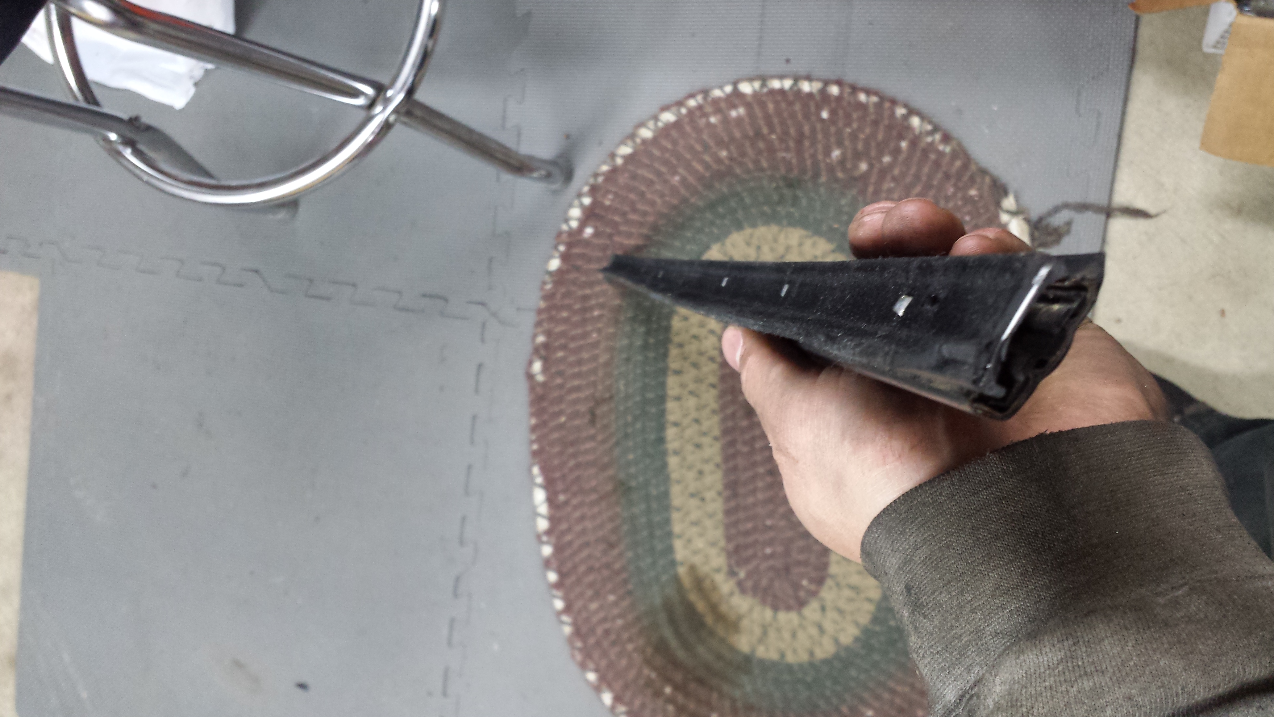

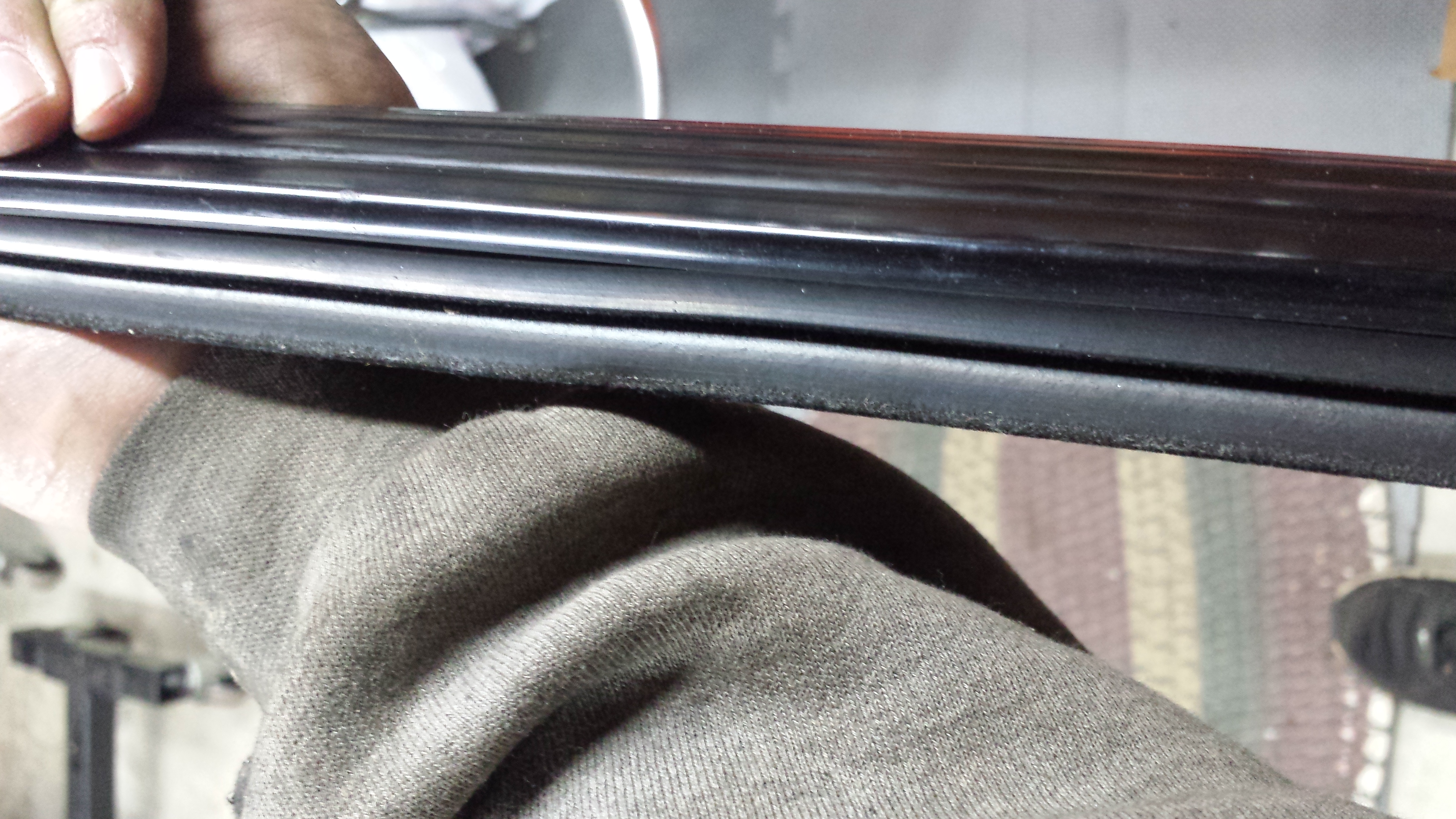

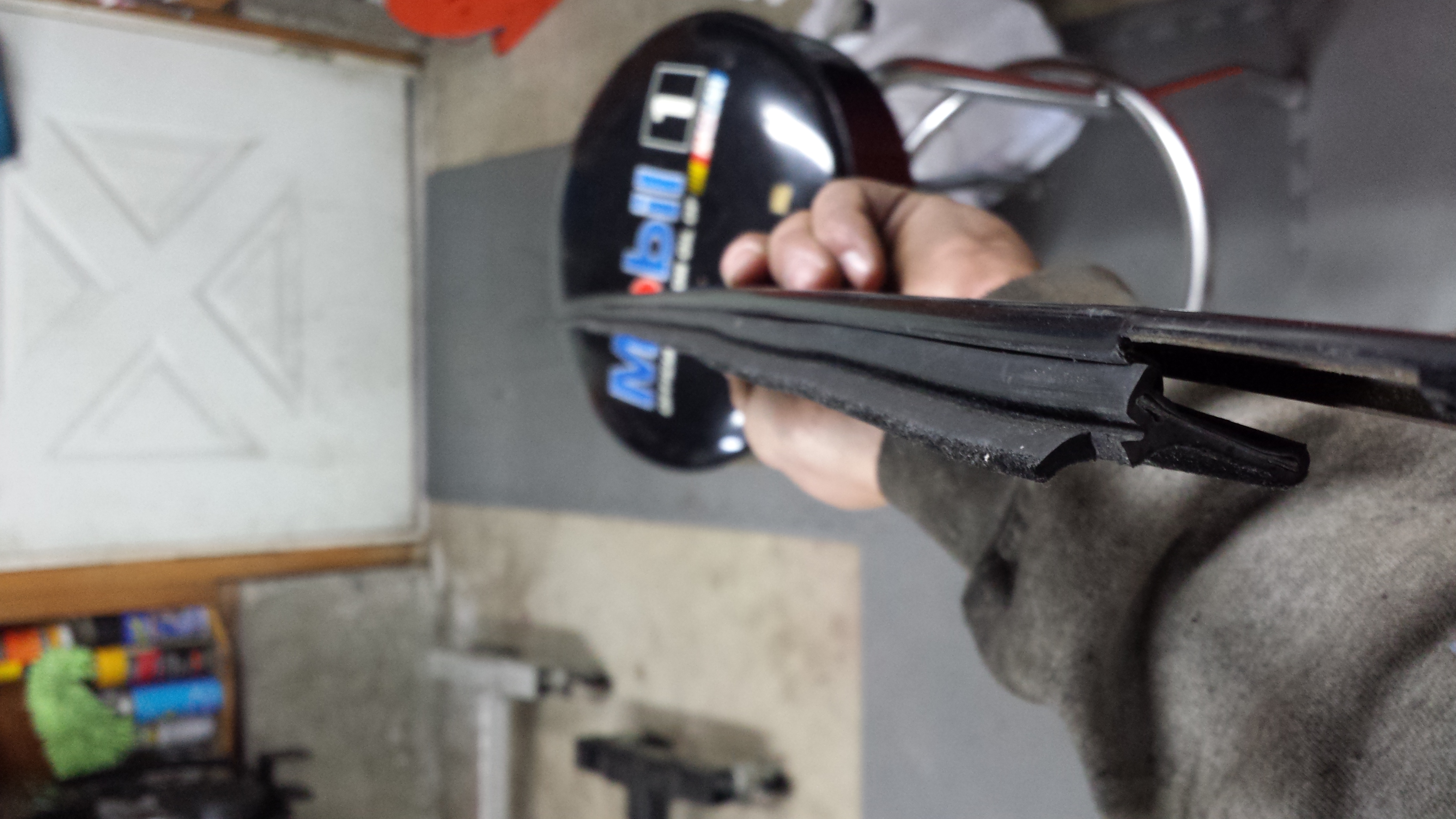

My strips installed on a trim piece.
I have two different versions ordered and I believe the first set I did was with the MR172X pn on their website I ordered that back in 2012 and never did anything with it and lost the receipt... It's a bit thinner and I believe it may work better, but I wont know till I try to install both versions.
The YMR260X is also another option, It has a longer flap but I'm not sure if that is better or worse... Once again I'd have to have all three made up to test them and I may just do that this winter.
Pics are of the MR87X Piece installed.

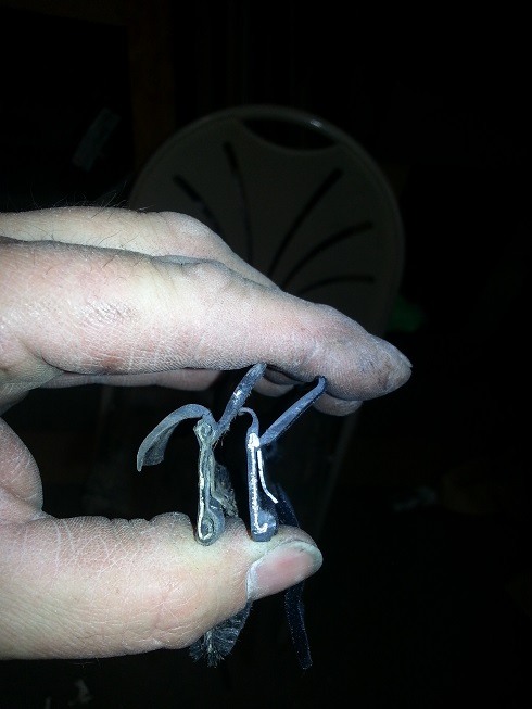

The Toronto Fiero guys have this profile available in any length you want.
Any good??
Original on the left. New on the right.

One on the right may work, but that extra tab of metal that sticks out in the center area just makes it harder to cut and make space for the tabs, it may end up too thick...That could also be an optical illusion because That looks very similar to the cross section of the YMR260X. It's a longer flap which may fit better, the ones I'm using are shorter but would still touch the window.
