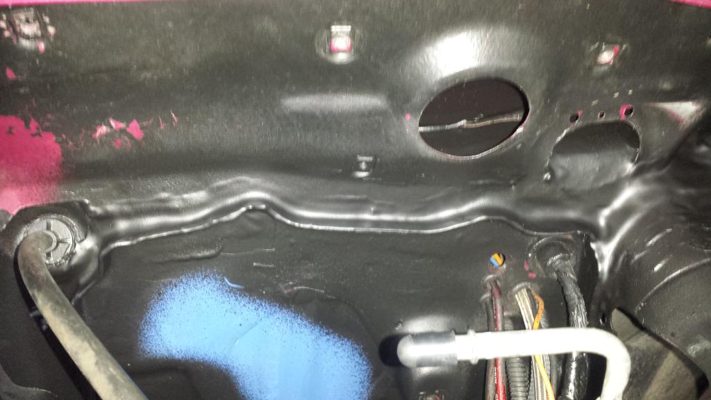

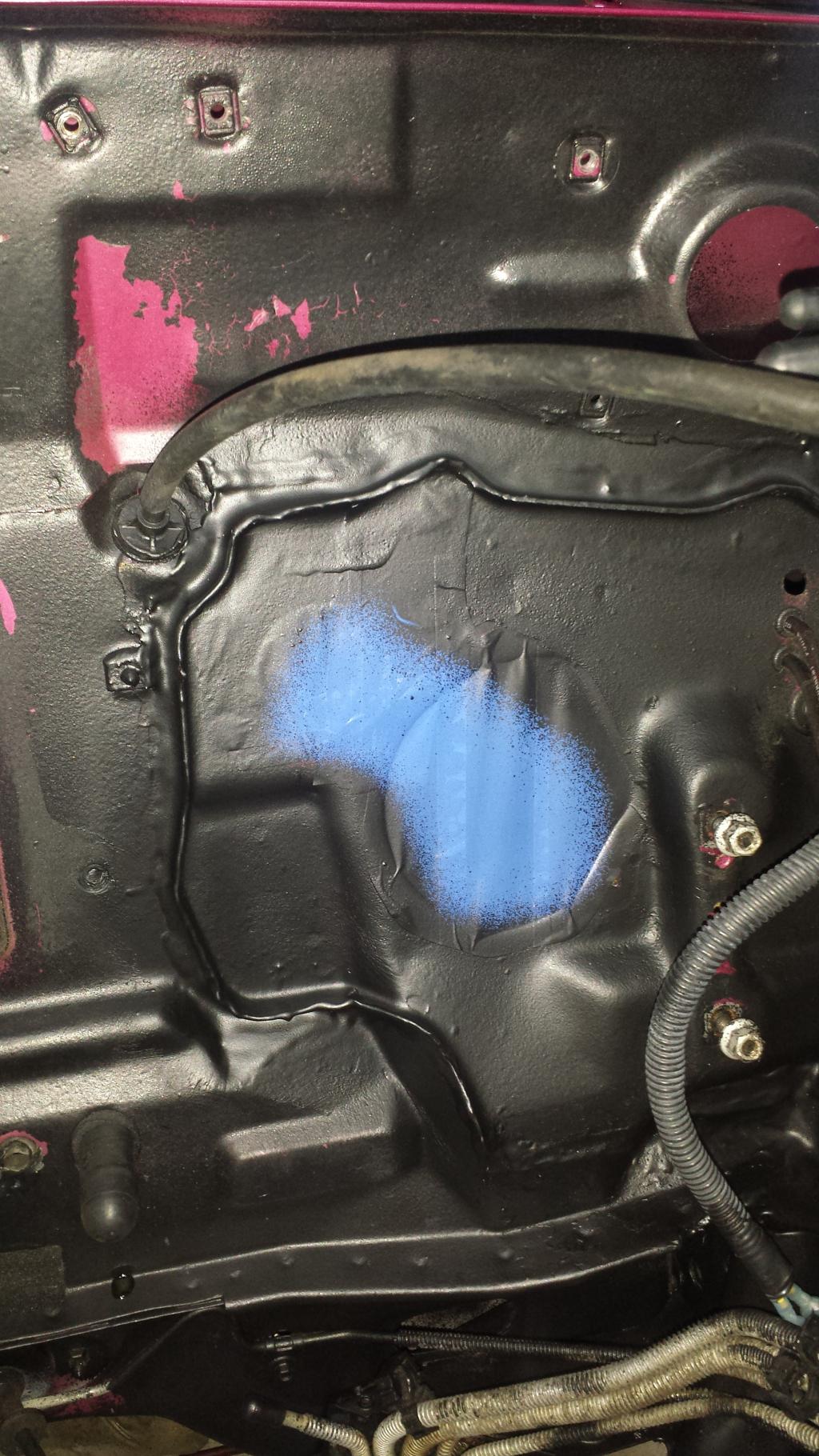

I re-sealed the firewall with the napa sealant, did two thin coats this time so no areas cracked on me. I then sprayed over that coating with the Leak Seal stuff from rustolieum... Seems to work good. That also dried up nicely and didn't stay a tacky mess like some rubberized undercoatings do. I still need to clean up and spray the rest of the bay with the bed liner I got.
Here is the older fresh air vent cover in place as well...

I've wondered how the Leak Seal works, good to know. May coat mine with same after I re-seal mine this season.

Posts: 4742
Re: 1996 Mr.Pink
You didnt scuff your engine bay before you painted it last time?

Posts: 10916
Re: 1996 Mr.Pink
Didn't think I had to scuff it with using the bed liner and actually I didn't in some areas but my biggest issue was it not being clean.
