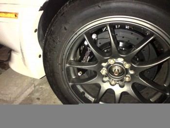

Wilwood fit's some 15's but the offset is the issue. Will not fit our stock 16s either. Very nice kit tho and worth every penny I spent on it.

How wide a spacer would you require to fit a GTZ or GTU wheel on?
Or is it even possible/safe to do so?
88_GTU
Posts: 474
Re: Any large brake kits still available?
Post by 88_GTU »
I know for my GTU wheels it would've required too large a spacer to be safe but that was due to the wheels design. Can't really speak to the GTZ wheel.
