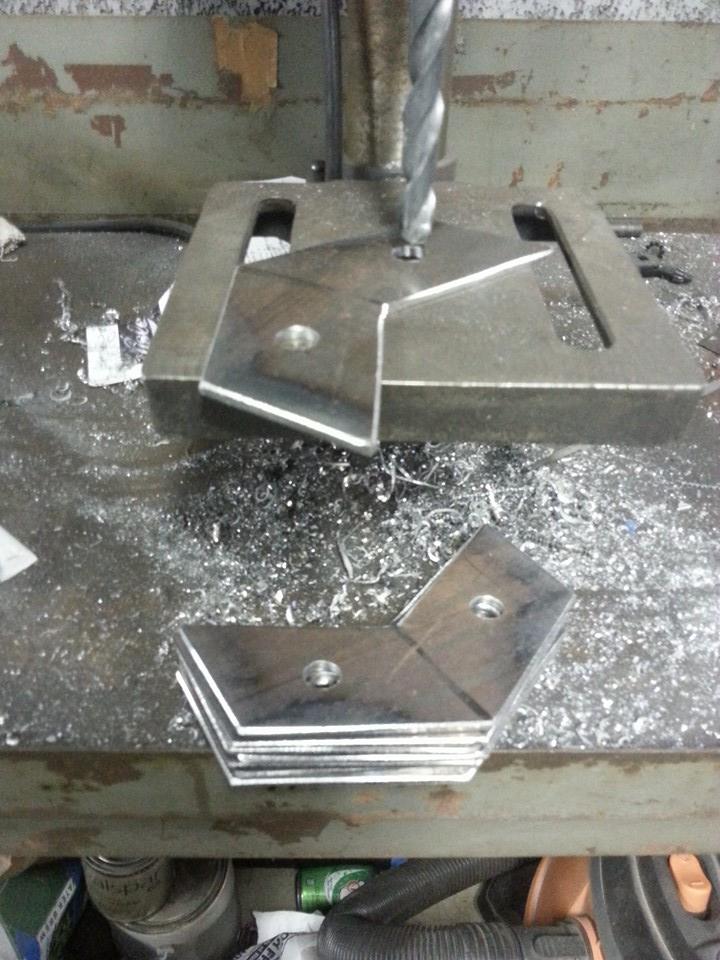

jjanke wrote:yeah i will seal up all the box ends.......gonna start adding the gusset plates spanning all the butt welds soon too.......
Remember to add in some sort of water drain-ports... Another idea might be to coat the inside of the tubes with hot boiled linseed oil -it might sound stupid, but that is the approved anti-corrosion method used in general aviation for steel-tube structures. One of the last things you would want is for this framework to rot from the inside out...

main frame rail gusset plates and rear axle bump stops welded in..... still more plating to do......

yeah i will have to look into some ways of sealing up/coating the inside of the tubes...........this car isnt gonna see any salt but better safe than sorry
Posts: 10919
Re: Beretta Z28
If they are welded shut then the odds of anything starting to eat it from the inside out is very slim... You would have to dunk coat it and have holes in the rails, OR you should have primer/sealed it before welding. They actually sell a sealer that can be welded through for rocker repair and such.
