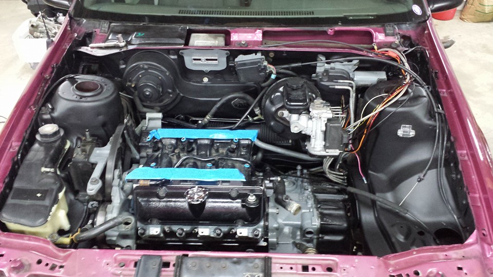

Got it out of the basement rather easily... Fit through the doors and was able to lift it up and out of the side door with ease.
And it's made it's way back into the car... SO much room doing this with no wiring harness in the car... I may just pull that every time to make this job easier.

How exactly did u get it out, I have tried to carry a quad engine, 2 of us failed.
Posts: 10916
Re: 1996 Mr.Pink
My basement is only 6"-8" below ground level so I rolled the stand all the way to that exit door and the lifted the front of the motor to get the wheels of the stand up and on the driveway pavement, and then I went around and in the house trough the front door and then lifted the back of the motor up and to ground level, so in reality I wasn't lifting the whole thing at one time. My bigger concern was fitting the stand through the two door frames in the basement but I lucked out by about 1/4 inch.
