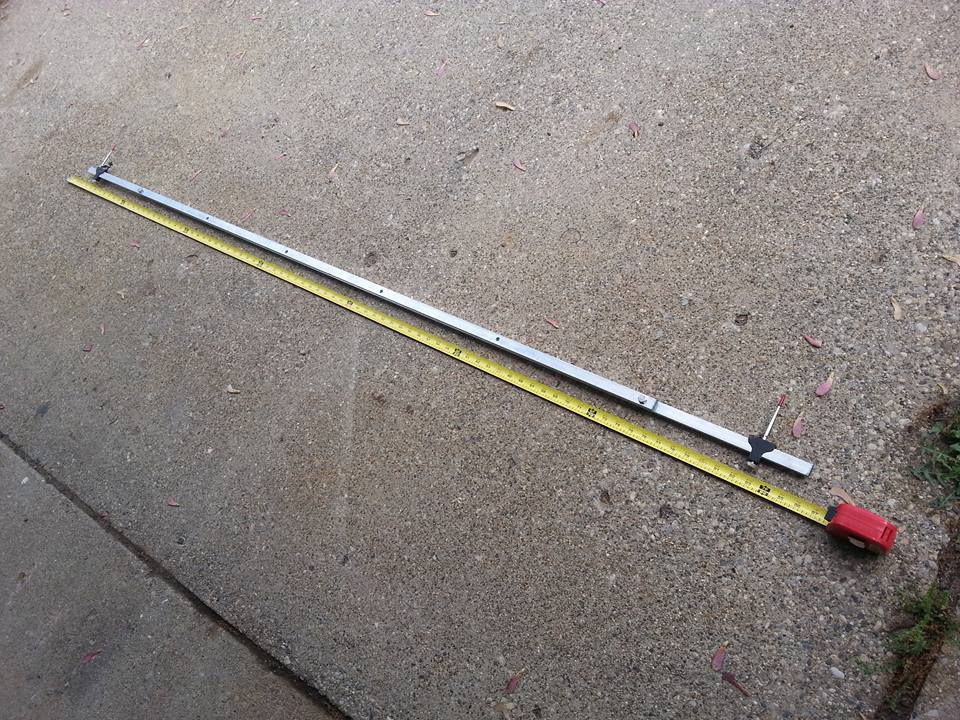

prob should have done this a while ago ....... but made an adjustable trammel bar gauge for measuring and mirroring points so I can make sure my rear subframe is as square as possible when welded to the body rails......I made it so it can adjust up to 11 feet in length if need be for checking those Long diagonals.....i gotta square this frame up and weld it already.........

Centered fromt wheels in front Welding table by extending some antennas ......and cut out some access holes to get ready to weld body rails to rear sub....... both parts are centered and sitting level...... I have been using the trammel gauge and the wheel base is set to 103.5" and have been checking diagonal points and found that frame is within 1/4" of square......so good enough to move forward and weld soon......
