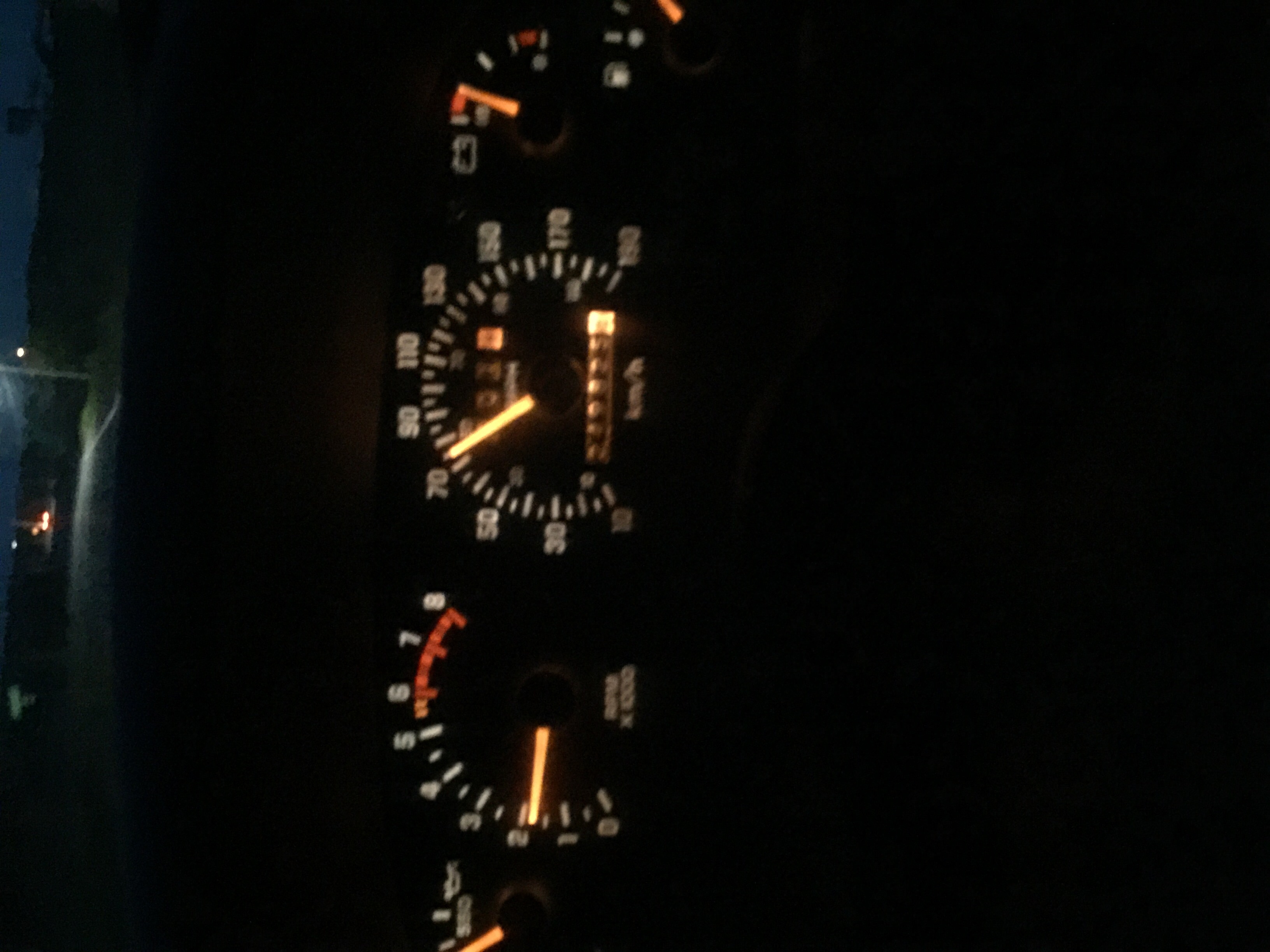

5 hours to remove but SUCCESS!

Re: Don't mess with texas - 3400 swap project
So according to that cluster 12v is still 12v in Canada... and F still means Full.. LOL
I thought F meant really fast :)
