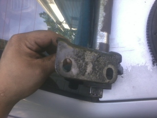

87-93 j body had a stamped steel bracket 94 sunbird and cavalier are the only ones with the thick bracket like what Jon posted. I'll look through my phone to see if I still have a pic of the stamped steel bracket.t

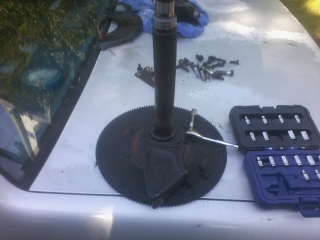

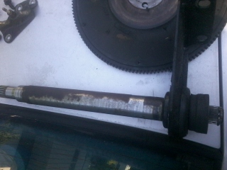

Found some pics of the stamped steel bracket one. Also iirc you can swap bearing mounts between the 2 shafts.

That aluminum housed one also uses a weak aluminum bracket to attach to the block. I have fount many of them are cracked.
Yes there is a bare shaft with a stamped steel bracket. I have found this on both berettas and j-bodies. It is better than the aluminum housing one but not as nice as that cast bracket. Mine failed on me once, but after some gussetts it seemed fine.

that's the stamp steel POS that was on my car, I wish back when doing my 5 speed swap the 1994 cavalier shaft was acquired. Its so much beefier!

Just dont do right wheeler pealers with the wheel turned too far or the stamped bracket will pretzel and the bearing/axle slides apart. Some guy I know did that :roll:

Barry wrote:That aluminum housed one also uses a weak aluminum bracket to attach to the block. I have fount many of them are cracked.
This is one of the reasons mine has a fabricated steel bracket now...

Yep, that housing was FUBAR after that.
