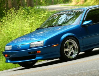

Thought I'd throw up a couple pics that I'd posted a while ago on the Facebook page. A teaser shot of the new wheels... they're growing on me but I still might wind up painting them to take some of the shine out. The pic with both cars was taken when the wife and I drove the Dragon a few weeks back.

Those wheels are sic man! What are they?

Weight is a bit porky at ~21lb/each.

Re: 1993 Quad4 GTZ: Project WTF
What wheels are they?
Well if that means that the tires are 14lbs or so then they are the same as z26 wheels. Really don't know what the weight of tires are. Never had time to check.
