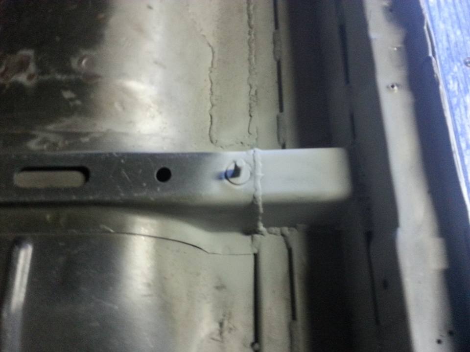

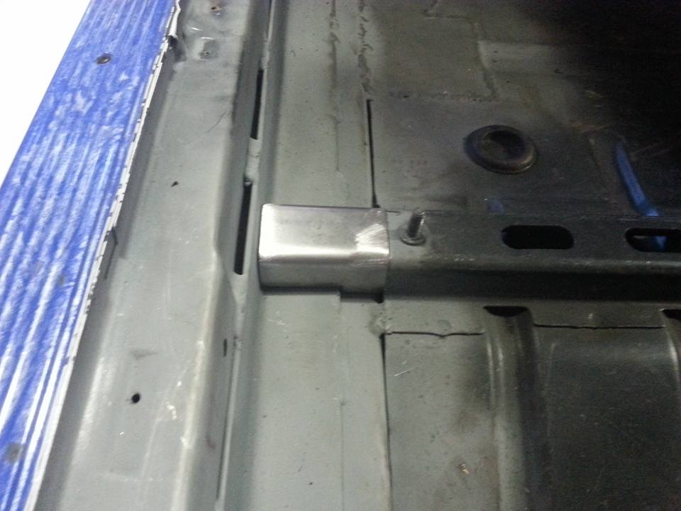

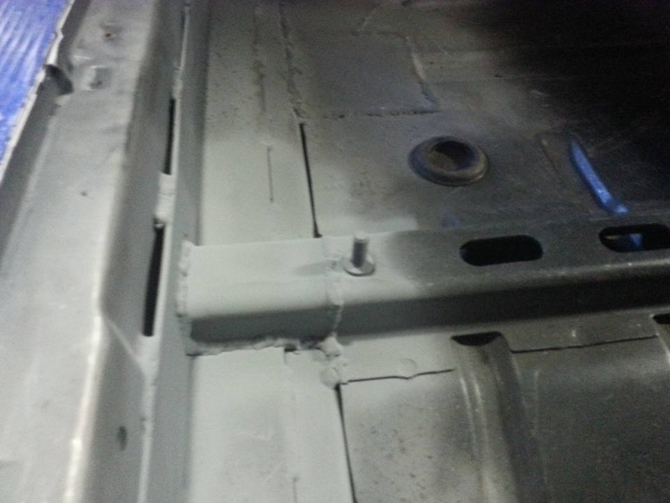

Bent up on the brake and welded in the missing sections of the seat rails. Also stitch welded in the back of the wiper cowl.
