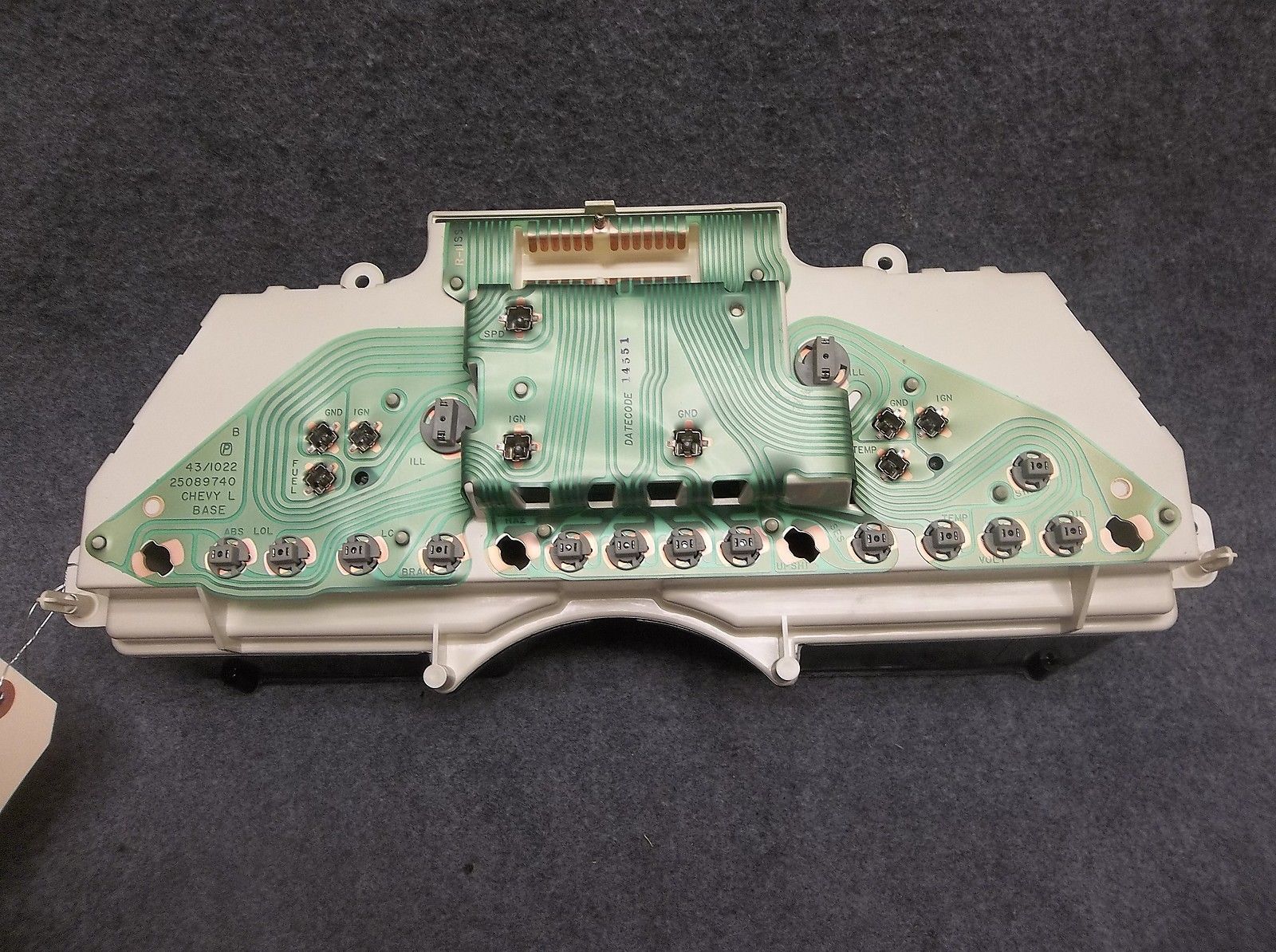

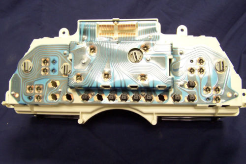

Hi All,
Looking to do a gauge cluster swap from base to the Z26 or GTU (something with a tachometer).
I'm not really able to find a 94-95 available, but I noticed that the 91 looks very similar to the 95 both physically, in the way they mount up, and the electrical connector looks the same. Does anyone have a wiring diagram for the 91? Just as a comparison, I have a couple of photos as well of the rear of each cluster, attached below.
Thanks!
95 base:
91 w/ Tach

you need the full cluster from 94-95 its obd 1.5. Someone on this board must have one they can sell you!

I don't think he does. I replaced my partially dead 91 cluster with the one out of my 95 and it was a direct swap. That's opposite from a 91 cluster in a 95, but I think it would be fine.
Re: 1991 Gauge Cluster vs. 1995 Gauge Cluster
give it a rip and see what happens!
The only year specific cluster is 96, and you can actually use a older cluster in the 96 if you really needed to... you would just have to re-wire the Tach signal to come from the ICM and not the ECU.
