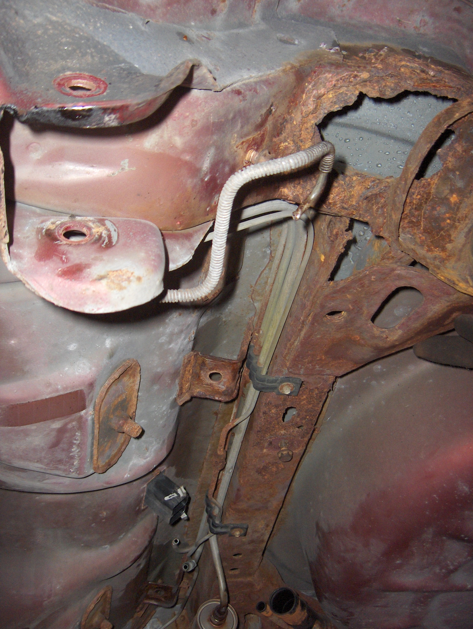

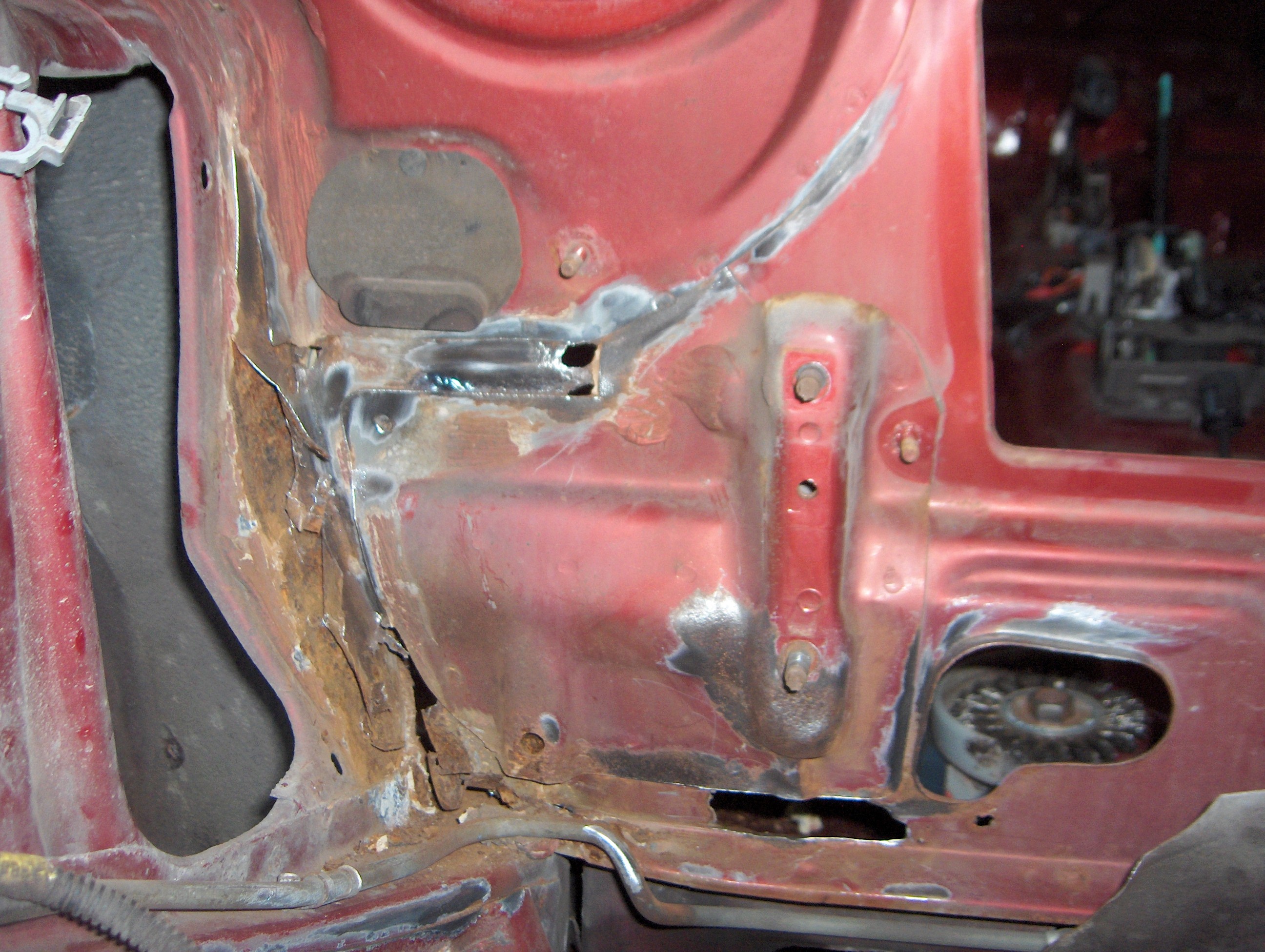

I had a body shop do the rockers because they were the part I was most afraid of at the start. $1700 and some less than perfect work and I had something that looks acceptable. As I pulled the interior and engine I discovered the cause of the wet carpets. The lack of cowl sealing led to extensive rust and leaks in the cowl and firewall. The passenger side behind the steering rack mount and reinforcement was the worst, but the lower driver's side was bad too. At this point I was in over my head and "The Plan" was out the window, but I just figured the only way out was forward. I cut as much as I dared out, and started welding. I should mention I am not a welder, but I just dove in.
With new metal in I sealed everything with SEM 2 part seam sealer and moved to the rear. The car was now on a makeshift cart with casters and I started looking into the rear spring perches.
Yeah they were bad. I thought about starting the fabrication, then I got nauseous. Changed course and bought a $300 95 Z26 with 56,000 miles and a blown engine from Vegas. $800 for shipping and I had a parts car. I needed the doors, fender, and parts to repair the rear. The donor car was very clean, and I considered just building on it since it was so clean. The Wife beat me for my insolence and I fell back in line.

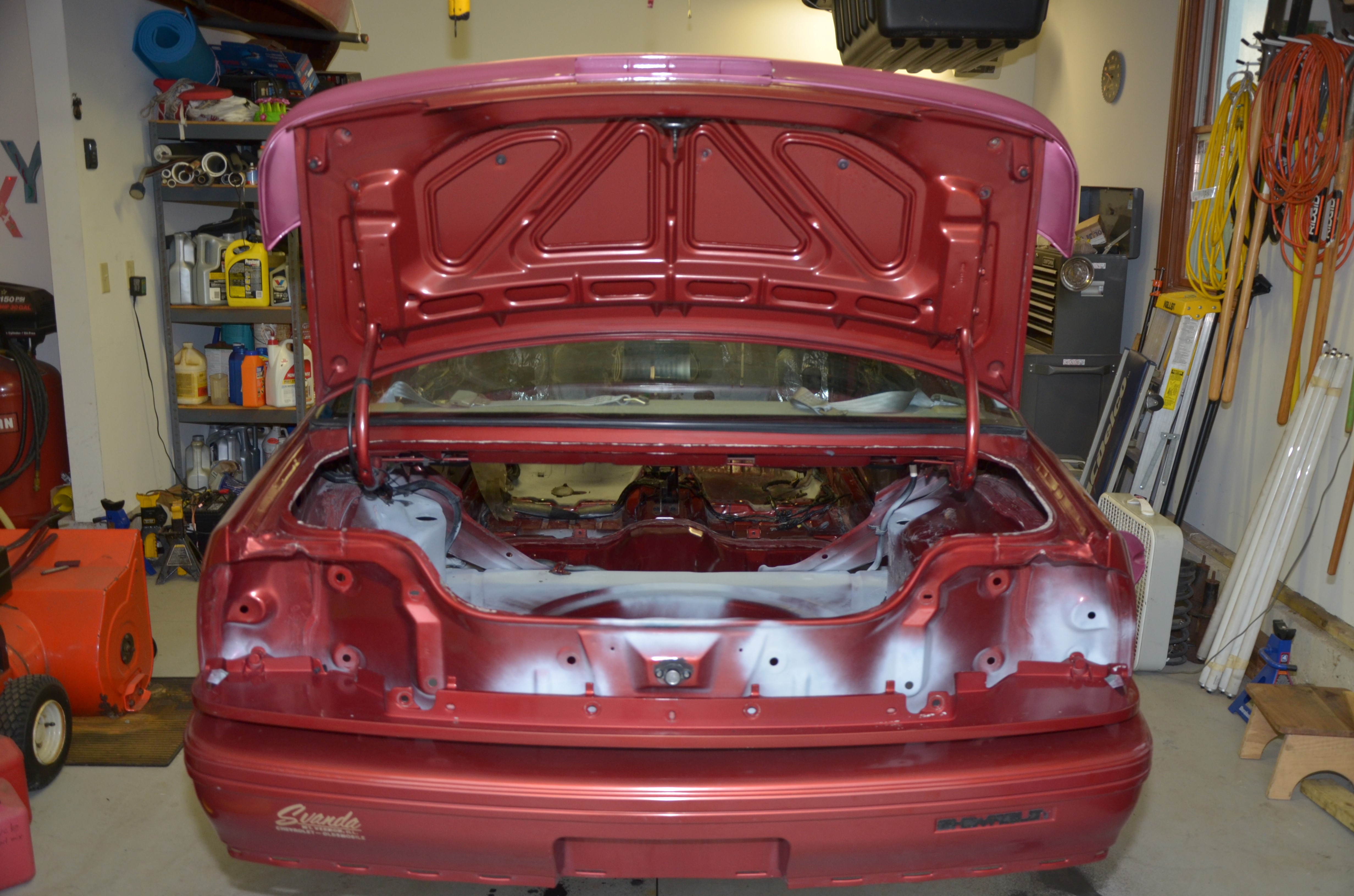

I started cutting spot welds and got the entire rear frame assembly out of the donor and had it blasted and powder coated. From rockers to to the rear, both sides. I also took the doors, fender, driver's rear inner wheel well, shock reinforcement, and back panel of the trunk out of the donor due to rust on my car. It was a terrible thing to do to such a nice car, I will spend an eternity in Beretta hell for what I did to that Z, but these are the things we do for love.
Lots of welding, seam sealer, and primer. Doors off the donor, hood from a junkyard I had laying around and other stuff and I was ready to have this thing painted.

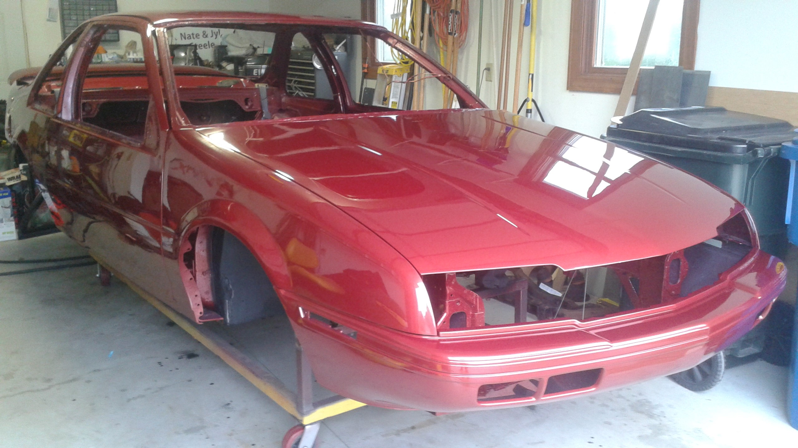

Back From Paint (Nov 2016)
The paint shop did an amazing job. Only one decision I slightly regret. I had them patch the passenger side fender antenna hole. I replaced it with a hidden antenna under the dash, the reception is ok, I just miss the old school look of the whip antenna.
Getting the car back together started with plumbing the fuel system, wiring and finishing out the engine bay. Dash install and drop in the rebuilt original 3100. I had a little issue getting it to fire, that was all my fault, but the factory service manual and Scan9495 software got me out of a jam. She ran sweet at that point and all I had left I thought to myself is" suspension, brakes, steering, glass, interior. This will take no time"

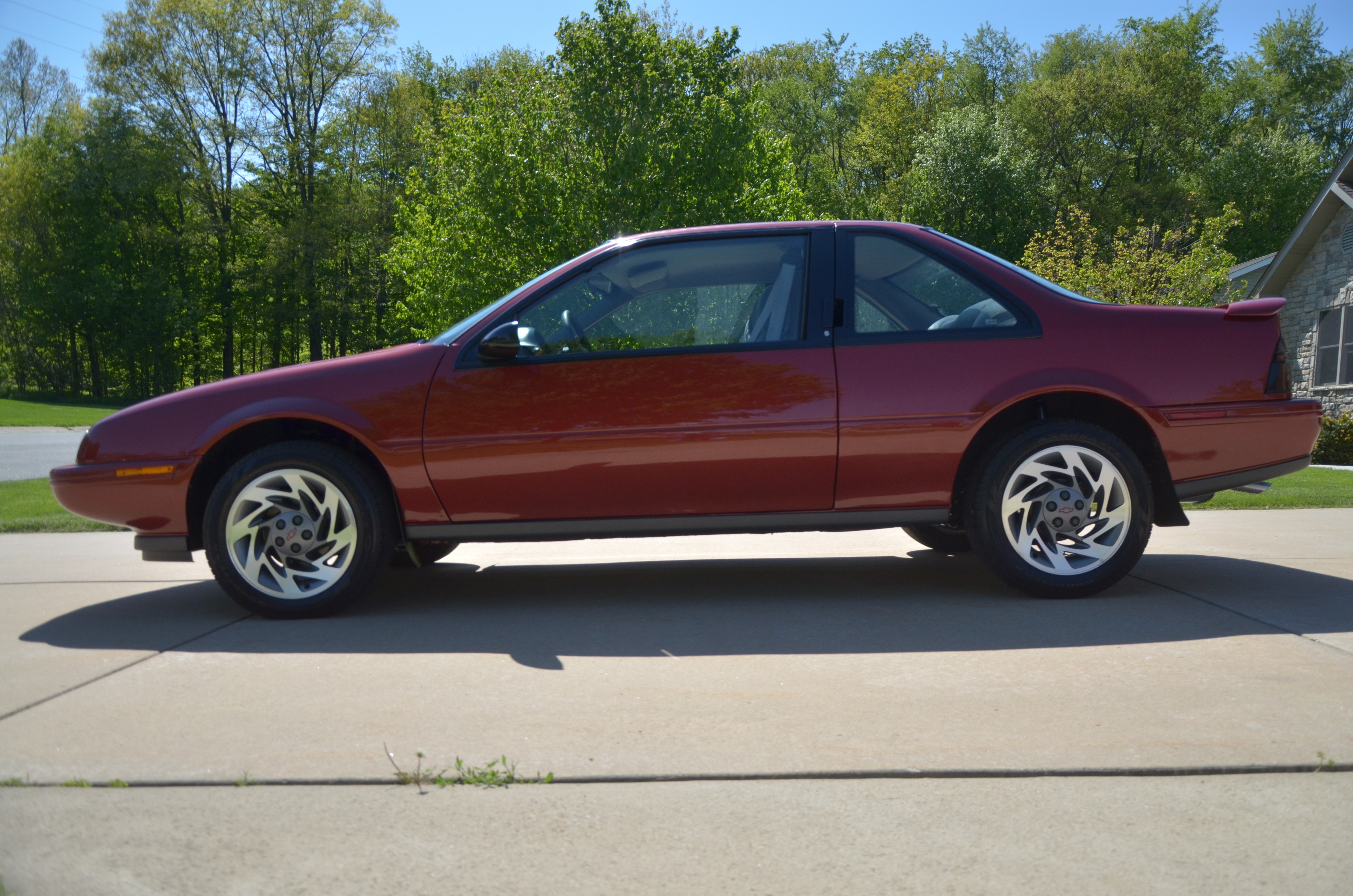

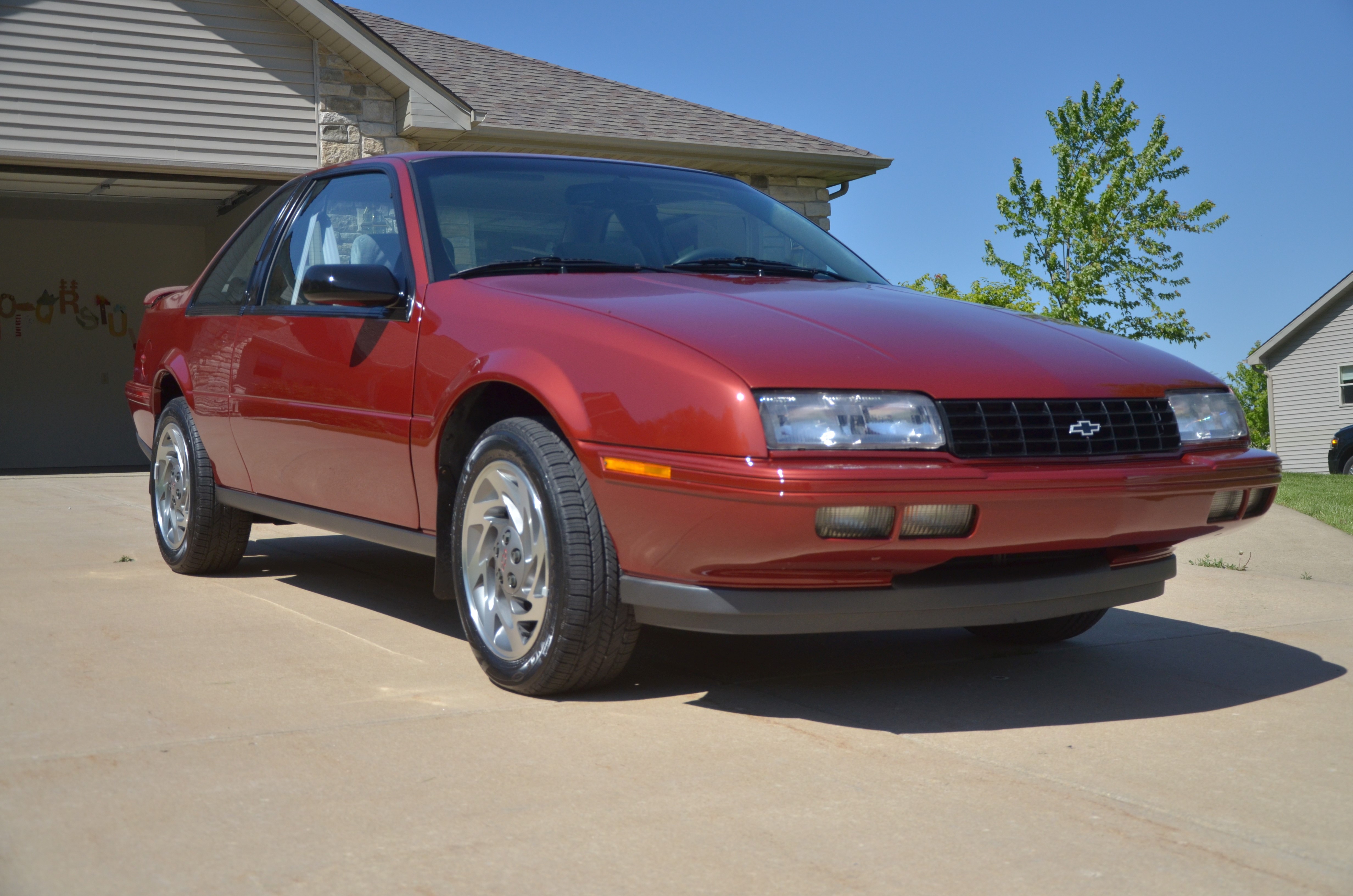

The Finished Product
And 1 happy wife on Mother's Day when I presented it to her. Hopefully the daughter will drive it in 11 years when she turns 16.
