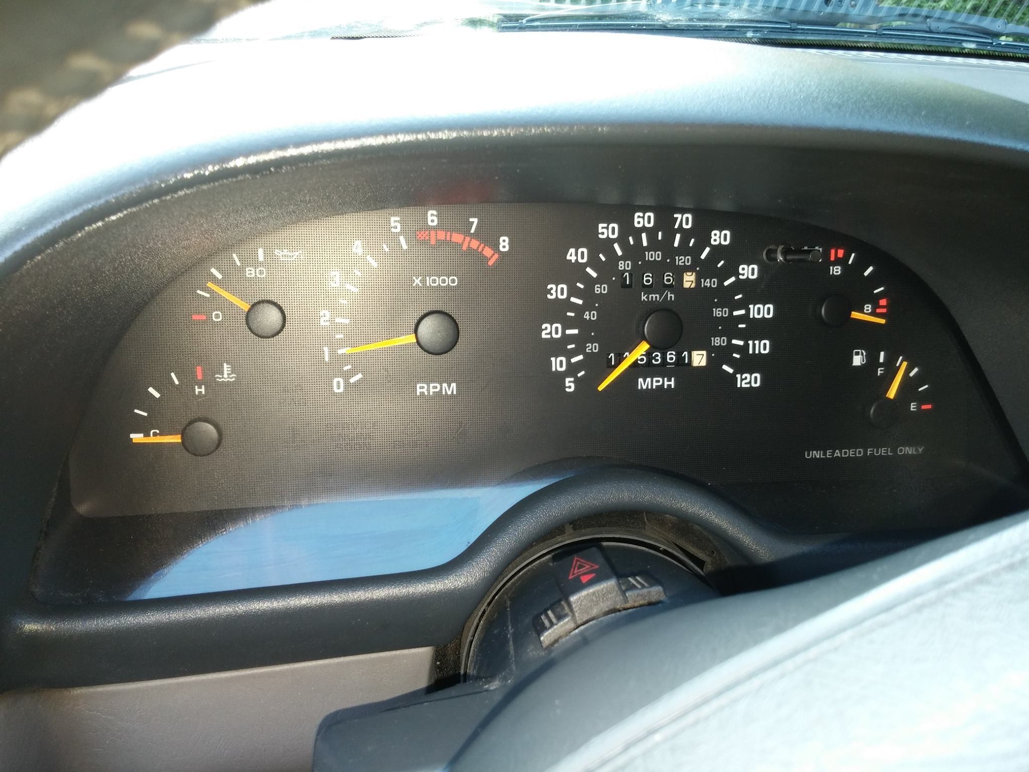

The easiest way would be to buy a 96 Beretta OBD2 factory tach cluster and swap it into your vehicle, then buy the Oil pressure sensor for the gauge (not the light) and swap that in, the odometers are swappable too however the speedometer dial needs to be removed to get the odometer out of the tach cluster. 99% plug and play.
Just make sure it is a 1996 OBD2 3100 v6 auto cluster, if its the 4 cylinder or 95 and older it will not work.
Here is a photo as an example of what a factory cluster looks like:

I talked with someone when I went to a classic car show and he told me that the most accurate and easiest way is using the adapter, at this point I'm just waiting for having the money to buy the tach adapter. Recently had to repair my parking brake line.
Posts: 10919
Re: Tachometer Install?
I think your wasting your money, but I already said that when I stated exactly what GT_Indy did above telling you to just do the factory cluster since it would be way cheaper and plug and play. But whatever, hopefully it works for your sake but I do not have a "tach adapter" between the ECU signal and my progressive controller so I'm not sure why that guy you spoke to thinks you need it.
