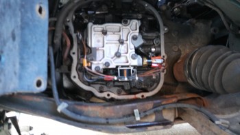

Idle in P and N, dies in D and R.
This is typically the TCC solenoid having failed.
Try unplugging the TCC connector on the transmission, it is a temporary fix but ideally the TCC solenoid needs replaced.
It can be replaced without removing the transmission, but space is a little tight.
I attached a photo of what it looks like behind the transmission side cover, the TCC solenoid is right on the side behind the cover. Sorry for the blurry photo, my camera wasn't working correctly that day.

The TCC connector is in the upper left corner behind the black wire harness.
You can't really see it in this pic.
You don't have to remove the pan to unplug the tcc connector to see if that is the problem.
These early v-6's seem to have a lot of injector problems. You might want to check those out too.

Yes, unpluging it is easy, my post is more so if you verified its broken and wanted to replace it.
