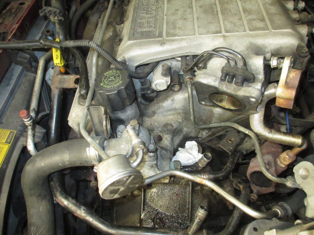

I figured now would be a good time to fix a few other things I hadn't got to. Oil leak at the back of the engine, figuring its the distributor dummy/oil pump drive. I noticed some coolant mixed in with the grime near the oil pump drive so I figure I need to check out the mess of heater hoses there too.
I pulled the alternator so I could get it tested, then I noticed the rear valve cover gasket was leaking might as well do that too. Here's a pic of how much I took apart to do the distributor seal. I even took the exhaust crossover off which I normally wouldn't mess with due to rusty studs, but they actually look OK and came apart easy with my impact. I kind of needed to get all of this out of the way to deal with the coolant hoses. The pic doesn't show, but I believe the one is a quick-connect o-ring fitting from the factory. Someone had ditched this and put a regular hose nipple in the thermostat housing. They just put a short piece of hose on (too short) and 2 clamps.

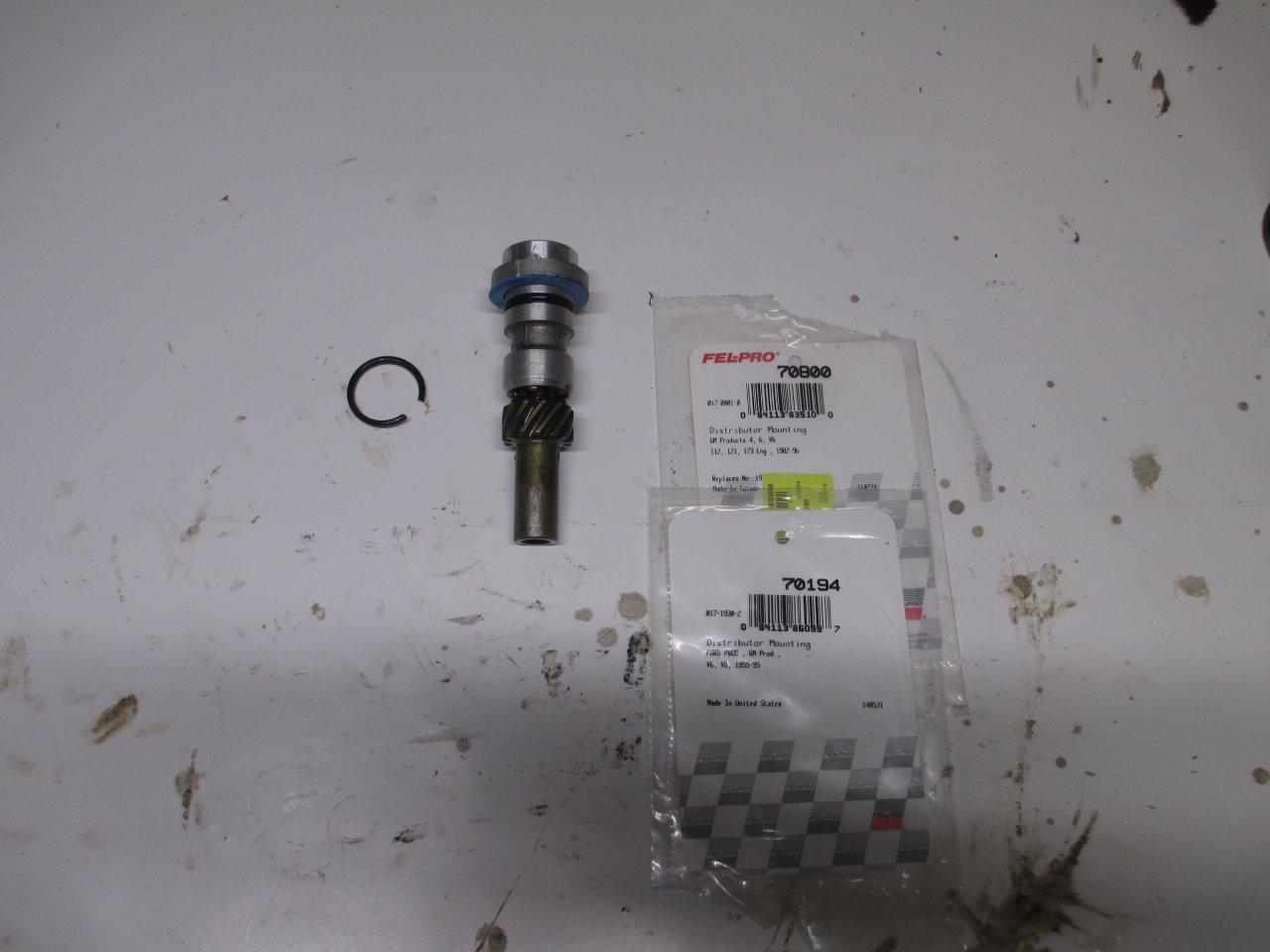

Here's the distributor dummy/oil pump drive and rthe felpro p/n's I used. Unfortunately the o-ring is the black kind so it may be short-lived. I did a search here and found the p/n for the small-block Chevy distributor base gasket and used it as well (thanks 3x00 Modified and Geoff).

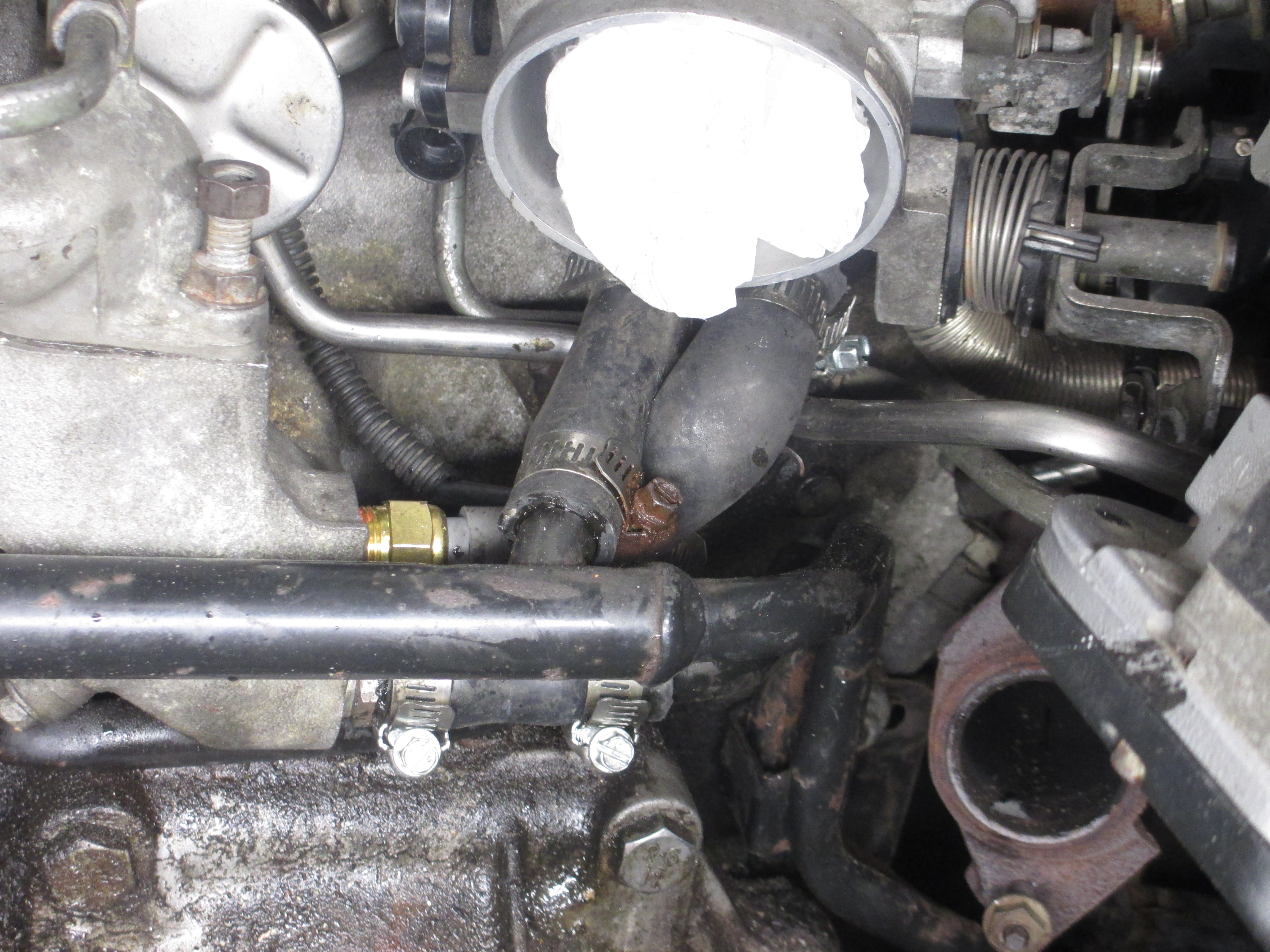

I couldn't find the right heater hose for the throttle body connections. A straight piece of 5/8" works for the one. There's a p/n I found on V6Z24.com for the other, but I wanted to find something locally. I bought the heater hose that goes from the heater core to the pipe (it has a 90 in it) and just cut it to fit. I'm not totally happy with it, it seems like it needs more than a 90 degree bend.

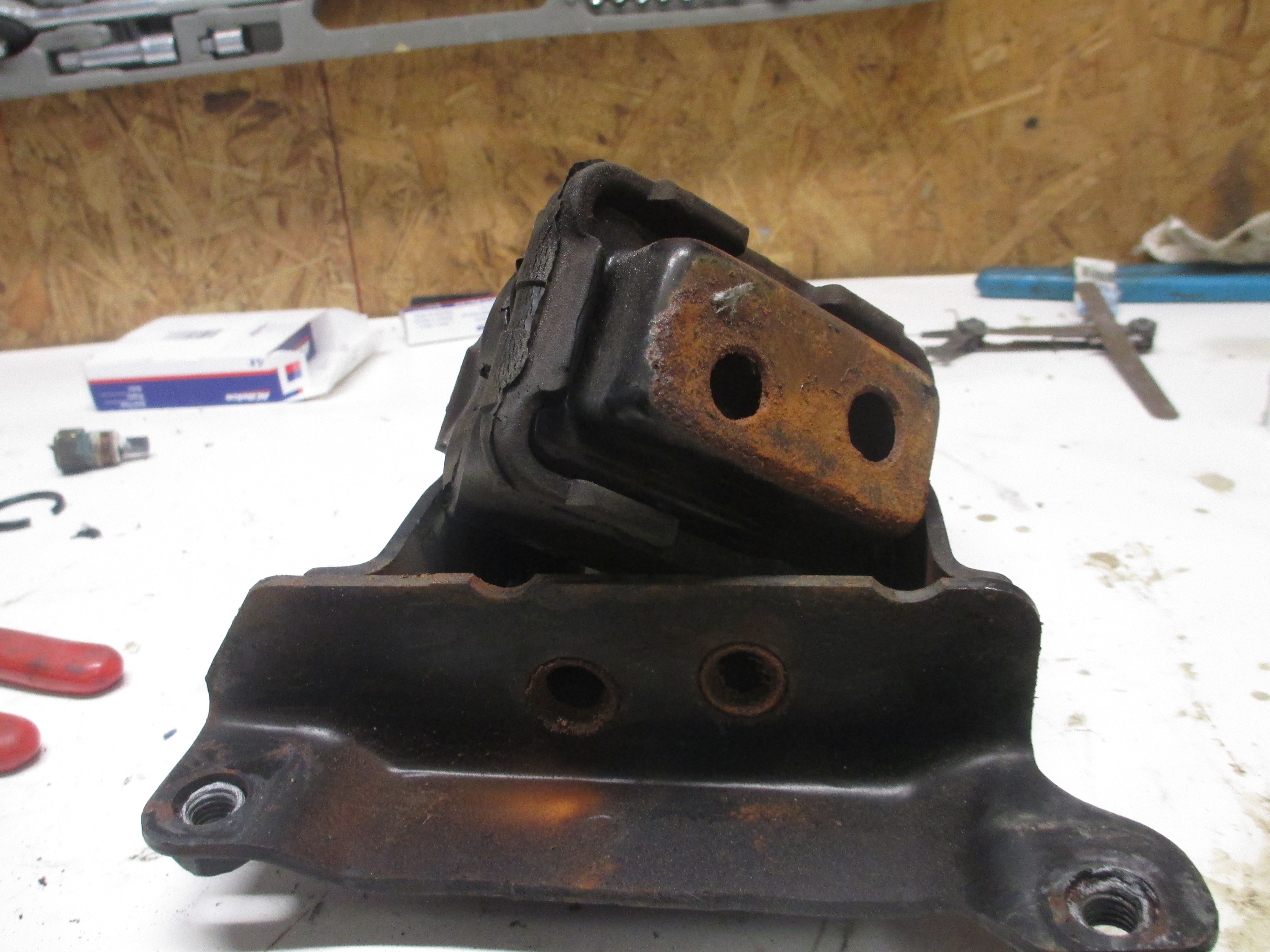

Instead of using the right tool for the job, I wanted to get it done so I took the motor mount out hoping to gain access.
Still couldn't get it, but I found this, and this mount may be so sagged that it was making it harder to get to the tensioner. I do some research and find out that the mount is supposed to be swaged in to the housing! That explains all the orange rust dust, this thing was moving all over. It also explains the shuddering when I would let off the gas, and some random weird sounds when turning in to a parking spot.. I wish there was some heavy duty poly mounts still available, but those seem to be long gone. Rock auto has the front mount insert for like $8, it'll probably only last a year.. I hope not, it just seems like a bad design.
Looking further, I can seen that the inner CV boot is almost touching the subframe! I'm going to replace the dog bone too and hope that it brings things back in to alignment. There again, stuck with crappy rubber parts, but I'll just keep an eye on everything.

Get a new motor mount, then get the polyurethane insert from here: http://www.rksport.com/product-p/rk-507.htm
That should help with your situation!
