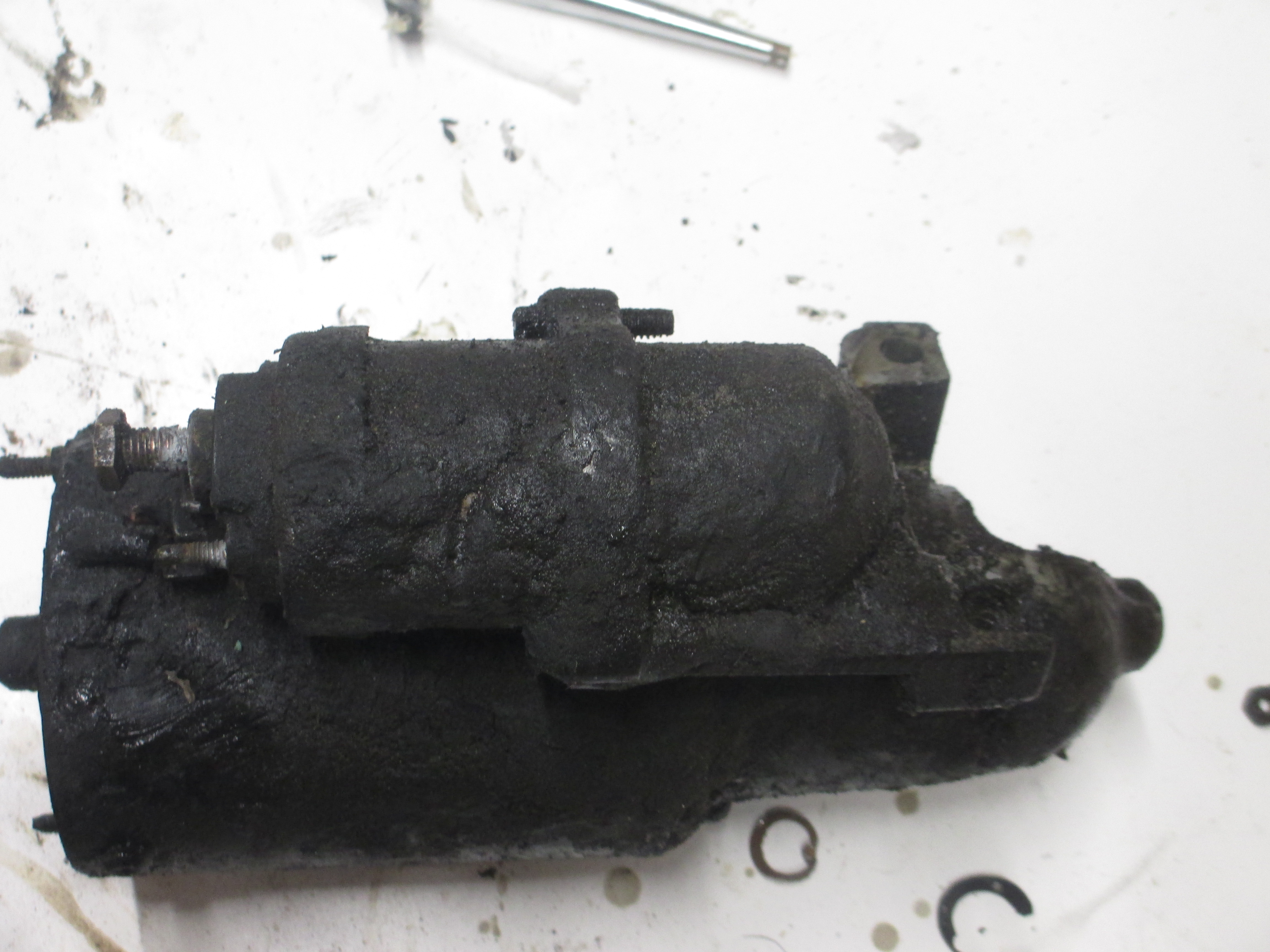

Next was the starter. I ended up pulling it out completely, it was just caked with grease. I wanted to really have access to the wires and connections.

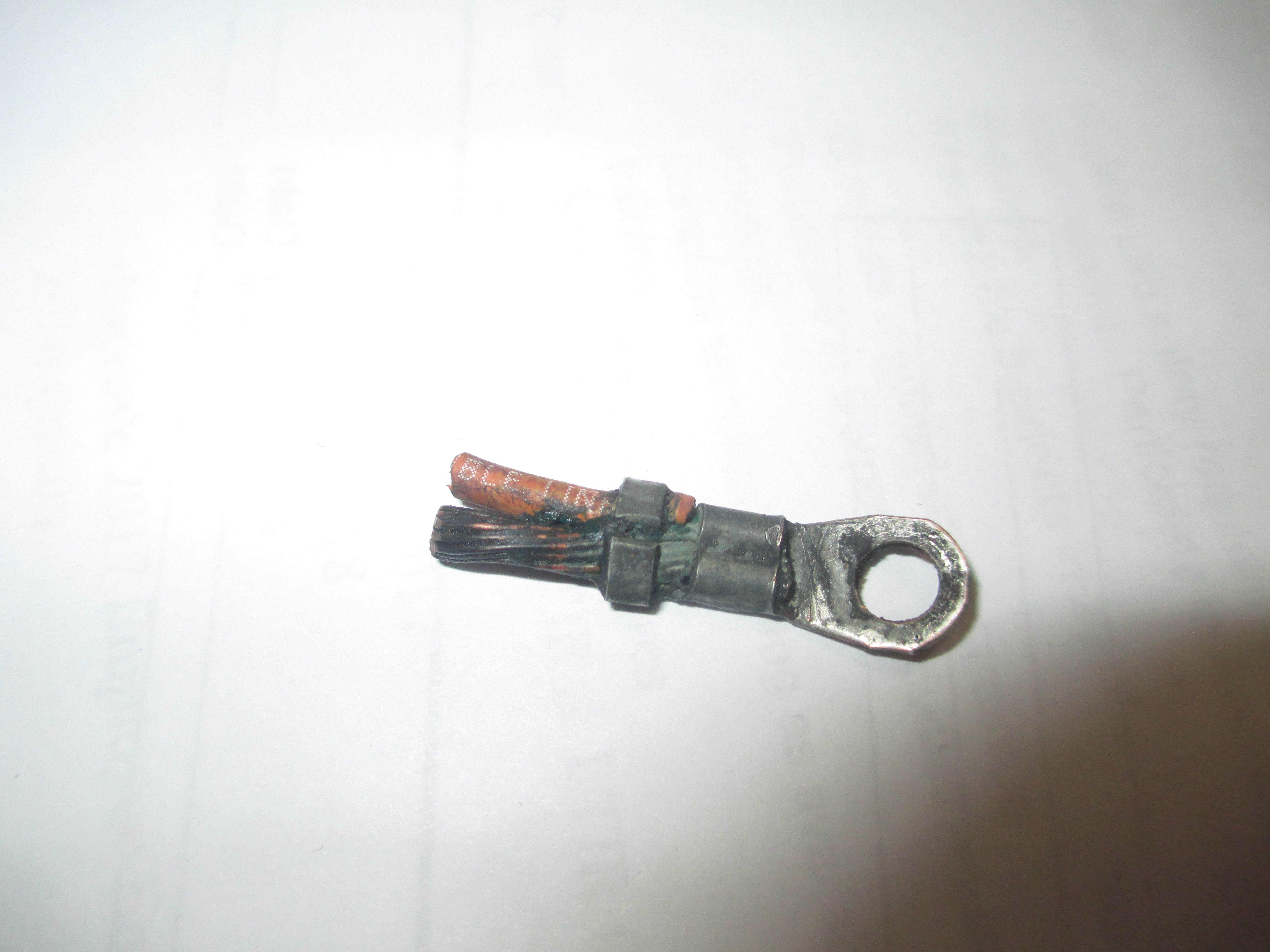

All the connections looked OK, but I peaked behind the shrink tubing on all of them. This is what I found on the small terminal to the solenoid. There's a small purple with a fuse link (I believe this is the ignition wire) and a large 12ga purple doubled up.

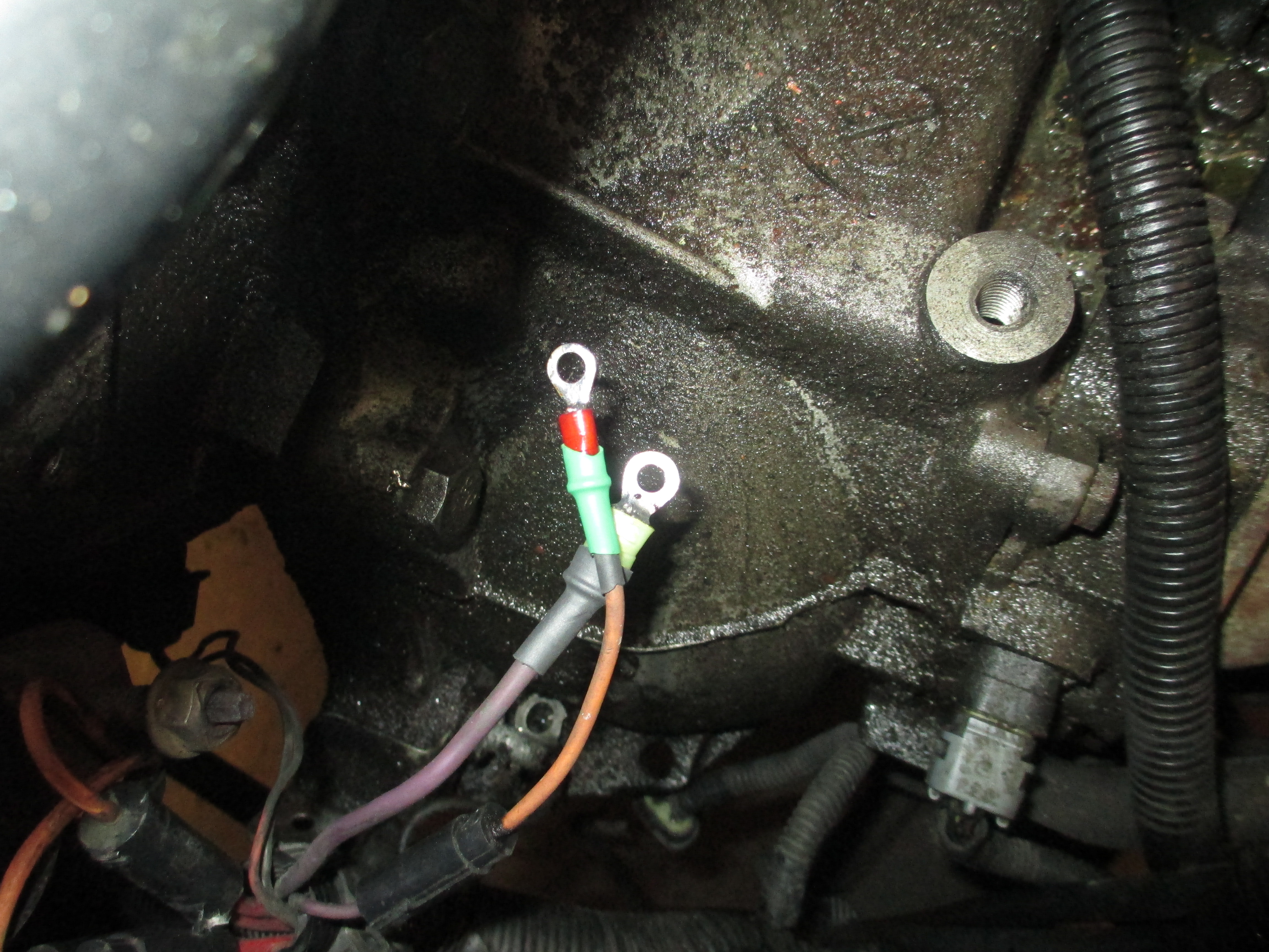

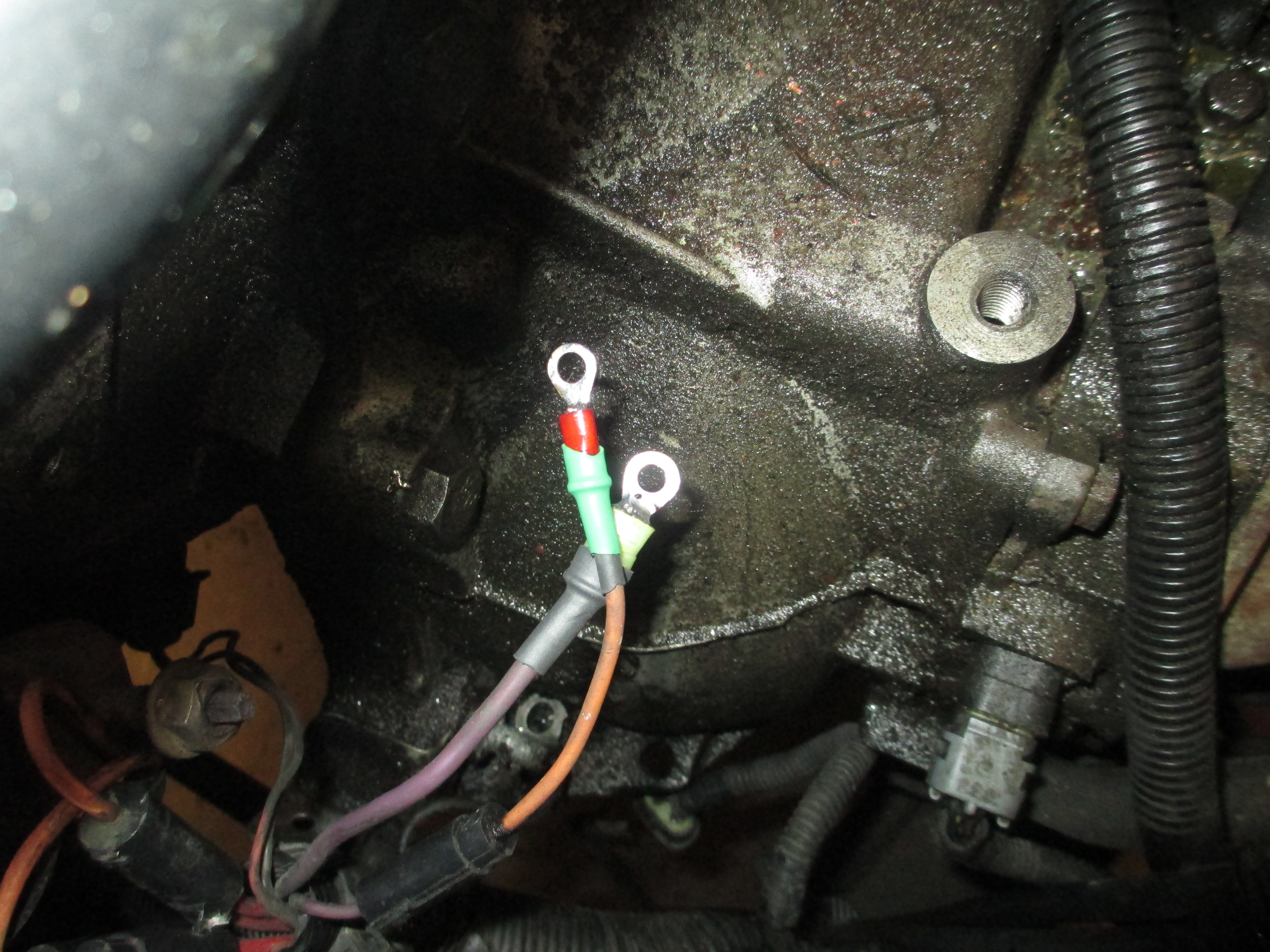

I like to leave well enough alone with factory wiring since they do such a good job, but I couldn't let this go. I'm going to crimp and solder new lugs on, I'm going to do 2 separate lugs since both wires won't fit together in a normal crimp lug.
The car is all apart for other work (see my members rides) so I had room to pull the harness up and pre-tin the wires. Today I will get the crimp lugs at work, and hopefully I can work on it again on the weekend.

Got the new terminals crimped, soldered, and put heat shrink on. One piece of heat shrink is green, "borrowed" it from work so I wasnt being picky. I put the cleaned up starter back in. I had to shorten the 10-12ga purple wire a bit, but it connected to the solenoid OK. I'm just going to route the harness securely so it doesn't have any stress on it. Still didn't get to fire the car up though, hopefully this weekend. I probably won't know for quite some time if its fixed or not since its an intermittent problem.
