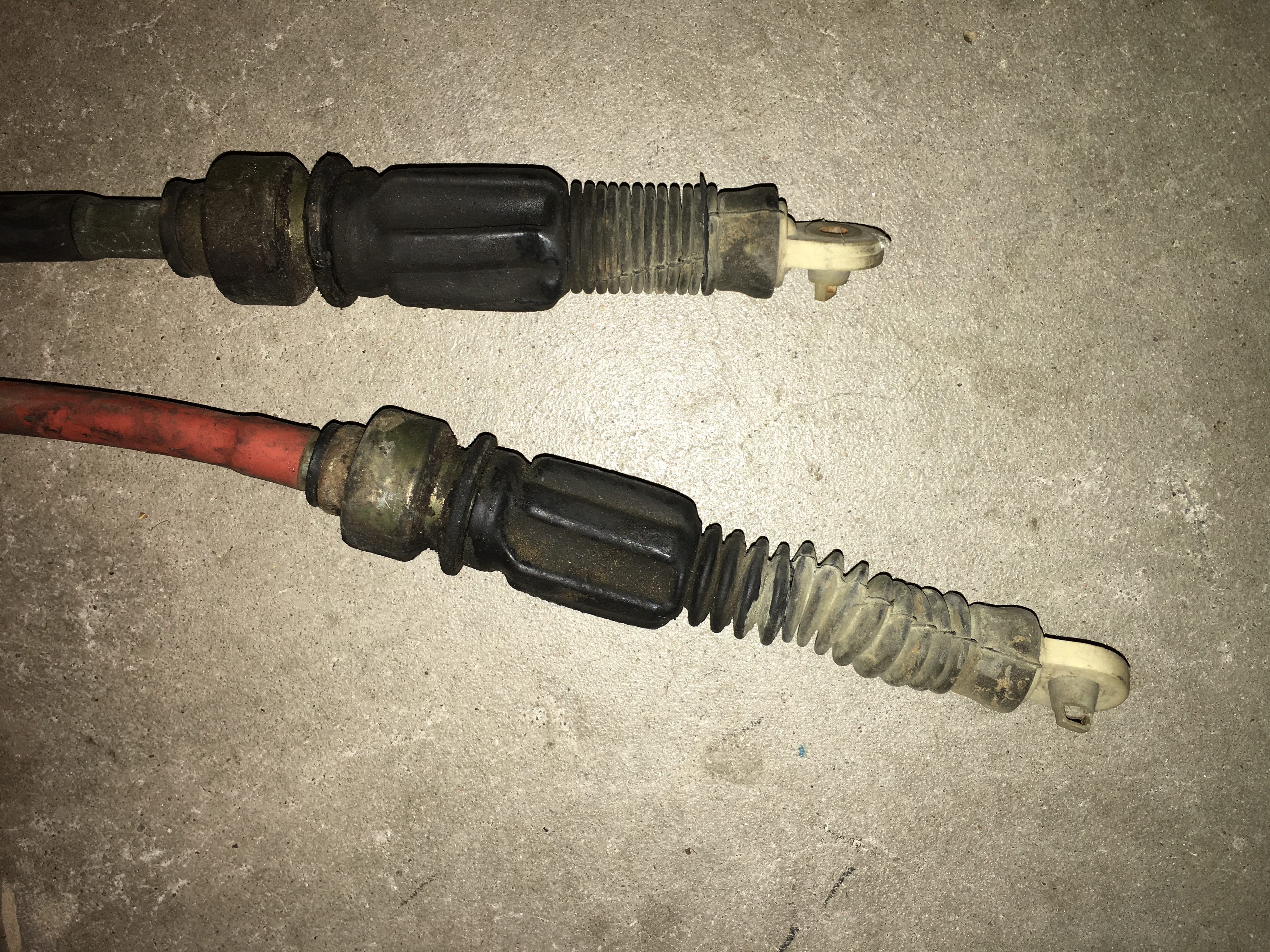

I dug up the old shift cables I still had,
All but one should be from 90-91 Quad4 cars, witch I have also used with a V6 with no issues.
The one with the thicker end is from 93 2.2 Isuzu trans.
I can provide measurements if needed, but again none of these is in a new condition.

Edit: found a picture comparing the 90-91 and 93 shifters I had:

Rodney,
The shift cables in the Beretta's went through quite a few changes from 87-96. Depending on year, and engine, they had a different configuration of ends. Here are a few "facts" that I can speak for from my experience:
87-89 cars appeared to use just about the same cables, no matter then engine.
Shifter design changed in 90, and different cable ends happened.
Shifter design changed again in 91. Different shift cable design was used, but it had the same connector style on it (they were just an updated manufacturing technique).
Starting in 93, they changed the shift cable to be a larger bushing style, however depending on if it was the V6 or the I4, it got a big bushing on one end, but not the other (typically V6 had this), and then I4 used the same larger bushing on both sides. The selector cable remained the same.
I haven't done much work with the old cars, but I do know that it appears that all of the 91-96 cars used the same cable lengths, and other than the manufacturing difference on the cable ends starting in 91 (you can see my pictures, which are of 92 Quad GTZ - the ends are white, but they have the same sort of plug on them and will work on the shifters) all of the years seemed to use the same selector cable - it was only the shift cable that changed. Also, I haven't had any issues swapping cables between years, since the cable points on the transmission are removable and you can swap a shifter in from whatever year your cables are from and it will work.
I think it would be pretty simple to design a cable which would work in all 91-96 years (and likely in the 87-90 as well) which just requires custom end pieces to be added to the shifter as you had mentioned. Hopefully that makes sense.
Let me know if it doesn't.
