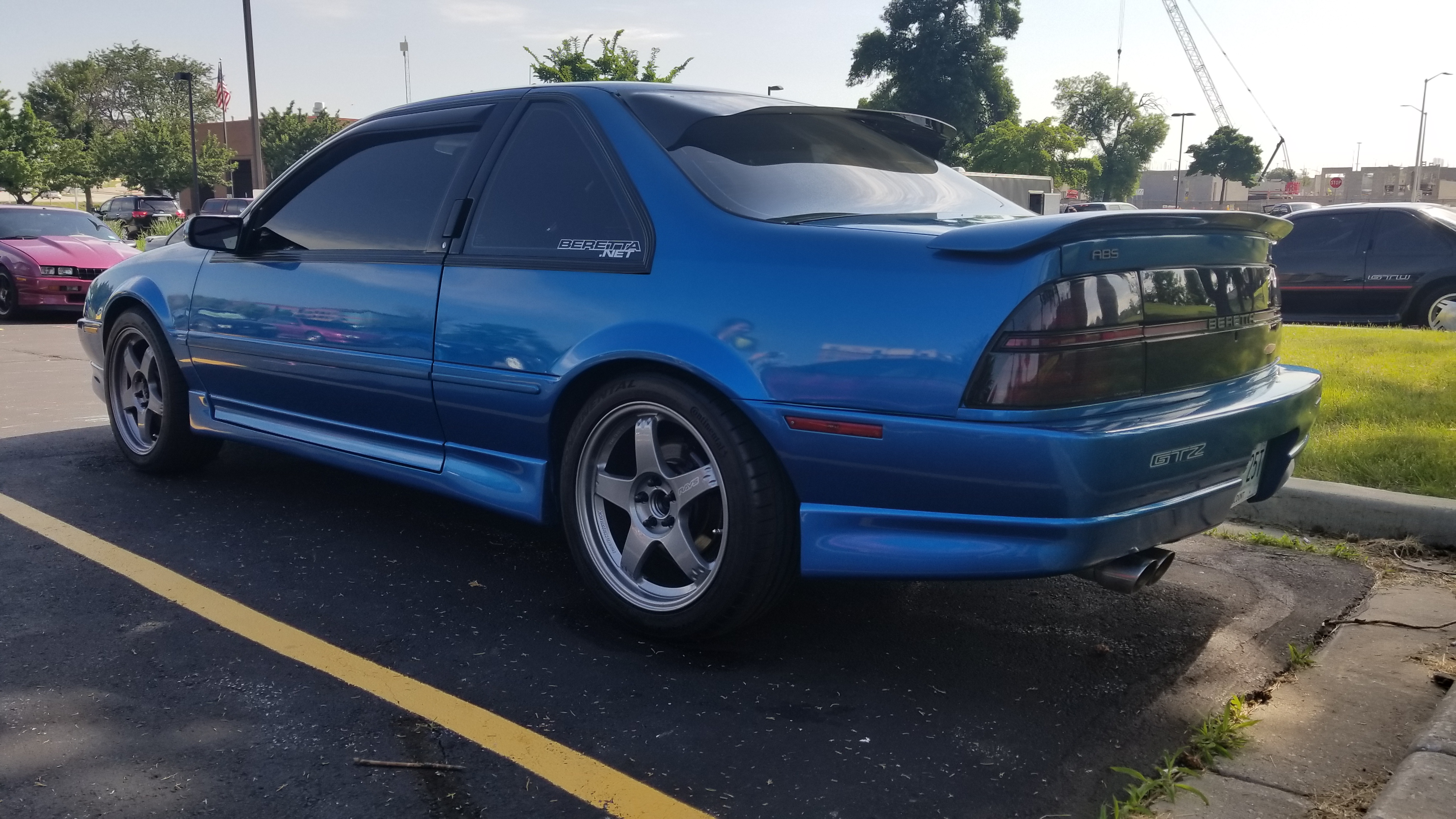

Now that BerettaFest is over, the cat is out of the bag. I bought a new set of wheels a little bit ago to replace my Whistlers that I was running before. The new wheels are Rays RS-Zero wheels which were the factory JDM STI wheel from ~18+ years ago. They are a forged wheel and weigh just 15.6lbs and are 17x7.5" with a +48mm offset. I decided to run spacers to fit out the wheel wells a little bit better. I used a 5mm in the rear with a 10mm up front. I also installed 2.5" ARP wheel studs to accommodate for the spacers up front. Tires are Continental ExtremeContact Sport. I'm really pleased with the setup so far. The setup performs exceptionally well. When I got back from BerettaFest I had another day off of work so I decided to head to the Dragon (US129) and do some spirited driving. The car felt glued to the road.

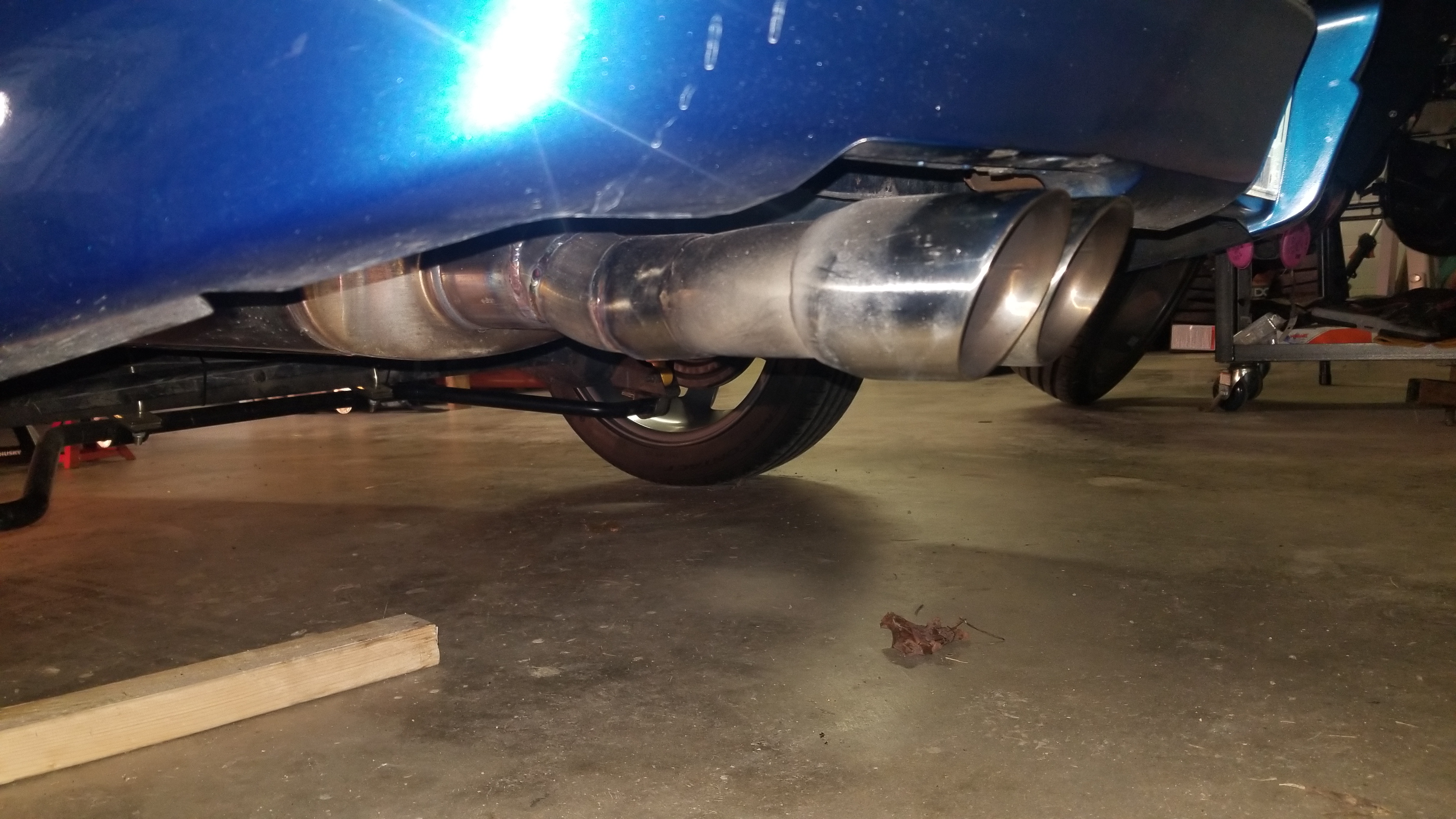

Almost forgot - I finally had my exhaust system fully done. I took the car to a local speed/tuner shop and had them install a stainless 2.5" mandrel bent system complete from the manifold back. Most of the system was part of the cat-back group buy from a couple years ago. To try to keep the terrible Quad4 drone to a minimum, I had them install 2 resonators (Aero Turbine into a Vibrant UltraQuiet p/n 1141) and I went with a Magnaflow muffler (p/n 11256).
Sound is pretty good (IMHO) for a Quad4 and drone is quite tolerable. It could be quieter but I'm still very happy.
The system was much more expensive than I would have thought but it was one of last items still lingering that needed to be done. I probably could have had it done cheaper by an exhaust shop but I wanted everything mandrel bent and wanted to keep everything stainless. Luckily this system should stay nice for a many years to come.
Pardon the dirty exhaust tips... haha

Car is looking amazing! I wanted to go stainless too, almost went with the common (OE type) grade (lasts long enough, but discolors notably), but I currently only weld with mild wire, so why pay extra for the good material and still have rusty joints?
