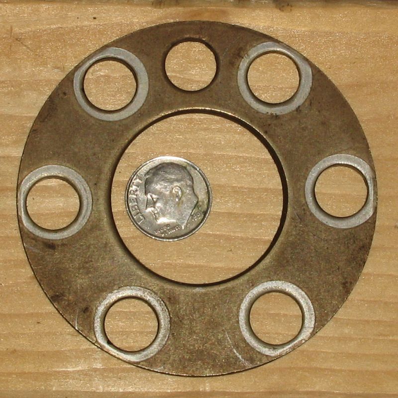

Stock flywheel, no aluminum for me. With the help of heavywoody, we got it all back together this weekend. The bolts were completely loose and required no tools to remove, FWIW.
First off, as best I can tell, the flywheel bolt pattern (at least on a Quad) is 'keyed' in that it can only bolt up one way. I don't know if that's normal for most cars, but on my Quad and (2) flywheels, the holes only seem to line up one way. So, bearing that in mind, let's continue.
When my bolts backed out in Biloxi 2015, I (a) had not used Loctite of any kind when I torqued them down over a year earlier and (b) can't remember what specs I used, so I may have been incorrect out of the gate. When we removed the trans and flywheel, we noticed that there appears to be some pitting (from the flywheel smacking the crank) on the back of the flywheel. We added loctite, reinstalled and it did perfectly fine for 3+ years.
Since I was installing a new clutch, I wanted to have a freshly resurfaced flywheel to go with it so I had a spare flywheel machined. Note: the crank mounting surface of this flywheel was perfect, no pitting, nothing. I removed the old flywheel and bolted this new flywheel up but didn't think much of the crank surface.
FFWD to last weekend. When we removed this 'new' flywheel after it loosened we noticed that familiar pitting on the back of the mounting surface and some high spots on the crankshaft (where the flywheel material had transferred to the crank. Remember how I said the bolt holes were 'keyed' and would only align 1 way? Well, I think that happened was the original flywheel (the one that loosened in Biloxi) had deposited material on the end of the crankshaft, but had aligned properly and the contours on the end of the flywheel surface mated up to the deposits on the crankshaft... When I installed a 'new' flywheel a couple weeks ago, I bet that the high spots on the crank were (a) preventing the flywheel from sitting down all the way and (b) caused the system to be out of balance.
I had the 2015 (old) flywheel machined again and had them also machine the crank mating surface (very very little) to ensure it was flat. We sanded the high spots on the crank down to ensure everything was once again - FLAT.
So far the car is back together and running fine but we'll know more once I get brave enough to get higher up in the rev range (which seems to activate the loosening). Oh, and this time around I used ARP flywheel bolts as well.

I've read about people getting an expert machine shop to machine the crank and flywheel with dowels to help relieve the bolts of the shear forces, that could be a possibility.
Being an aluminum flywheel I wonder if aluminum creep is happening (I know Aluminum can dent easily), where the metal deforms under the bolt heads and it becomes loose enough where the bolts can shear off. (Because the friction between the flywheel and crank gets reduced).
I wonder if he needs something like this made of strong steel to help clamp the aluminum flywheel to the crank:
