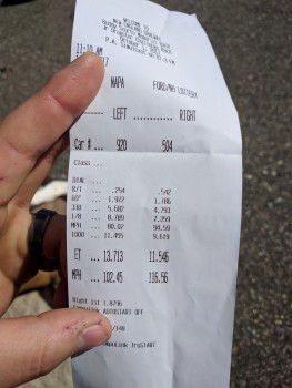

13.57@100
That's with slicks. All else the same as last year.
- Posts: 4788
Re: Beretta 1/4 mile times

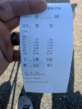

New best MPH, but with a garbage 60.
I see Asylum's 13.47 run isn't listed. Was there ever a slip posted for that? I'd be curious about the incrementals. My 13.57 from last year also isn't updated yet. And I know Jon had a new best last week: 12.35@107

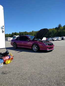

Car lost power since 2016-2017... Tearing into it this winter to investigate. MPH dropped a lot even with getting the trans to shift on spot.
2015 N/A Best for me 2017 runs, N/A and Nitrous .046 jet.
