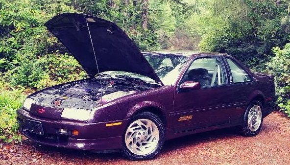

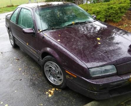

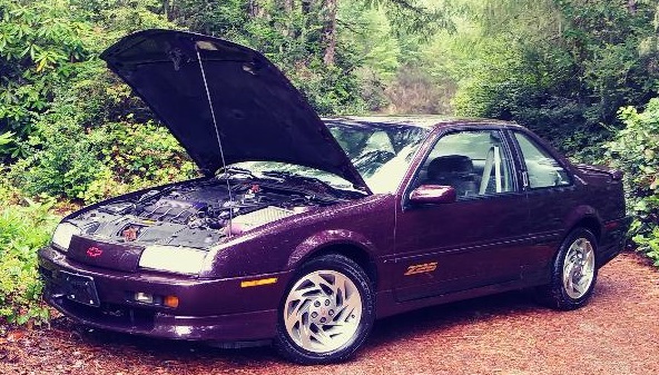

The car: 1995 Z-26, bought with 105k miles for $400 with the all-too-common 3100 rod-knock, courtesy of GM's typically failed LIMGs. Black Rose Metallic (BRM) with grey interior, and typically equipped for a '95 Z; A/C, Cruise, Power Windows and Doors, Cassette Radio, FE3 Suspension and the 16" Saw-Blade Z Wheels.
This was a well-liked, cared-for Z before the LIMG failure. Nice tires, the paint was kept clean and probably waxed, I would guess it was garaged for most of its' life. There are definitely flaws, but they are fewer than expected for a 23-year-old car. Even the engine-bay was kept clean (at least on the top). Virtually zero rust, except for minor surface corrosion underneath the battery.

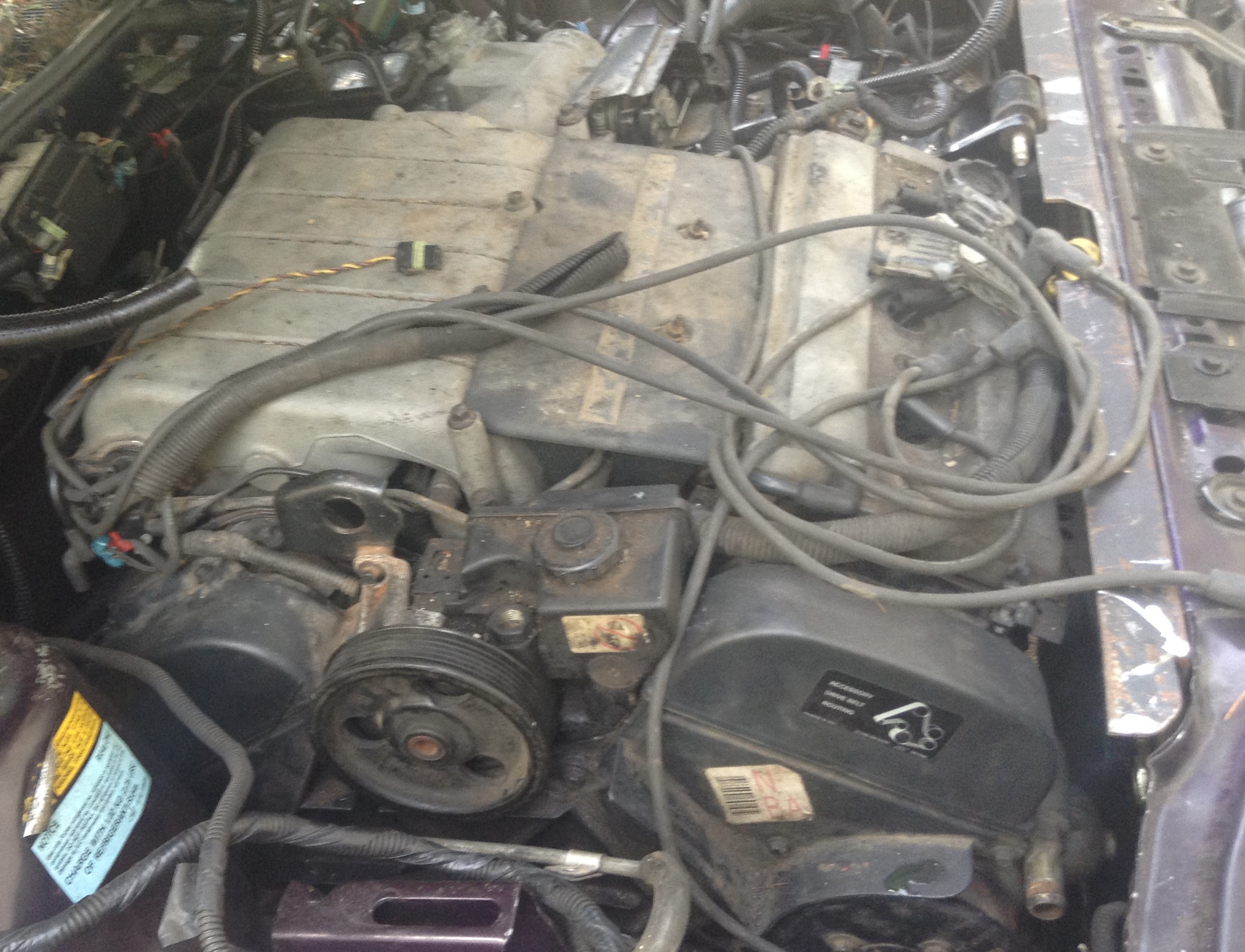

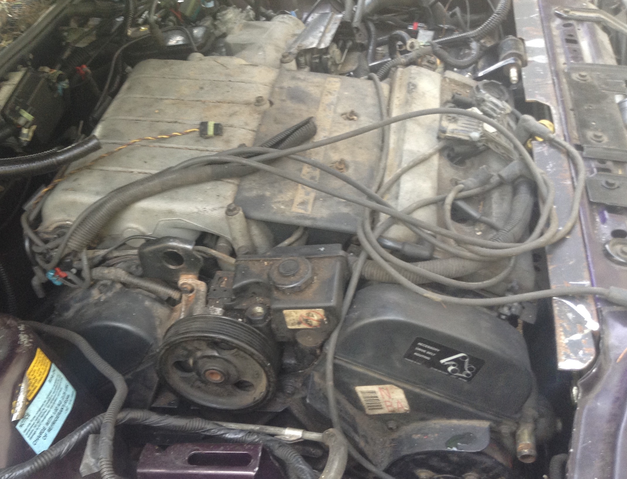

The Engine: 1995 LQ1 3.4L DOHC V-6, also known as the 'VIN X' 24-Valve H.O. Twin Dual Cam engine. This is a full SFI engine, MAF operated fuel management. These engines were de-tuned by GM, rumors persist that it lost ~33% of its' initially design power, supposedly to keep the then-new 4T60E alive for the duration of its' warranty, and in '95 it was rated at 210 H.P. (add five more for the manual transmission models) and 215 foot-pounds of torque. The most interesting note being that the red-line was set about 1,000 RPM higher than the engine's push-rod siblings had. This was a High-Output RPM engine from the start. '95 was the last year with a lower CR (Compression Ratio) and supposedly the last year this timing-belt engine remained non-interference.
I pulled this particular example around a decade ago, intending on swapping it into a Fiero GT, but never got back to that car. The donor was a Chevy Lumina Z-34, wrecked at only ~64k miles. The engine cost me $150 at the local yard, complete from intake to oil-pan, accessories to flex-plate, even included the PCM (the W-Body Luminas placed the PCMs under the hood in '95) and wiring harness.

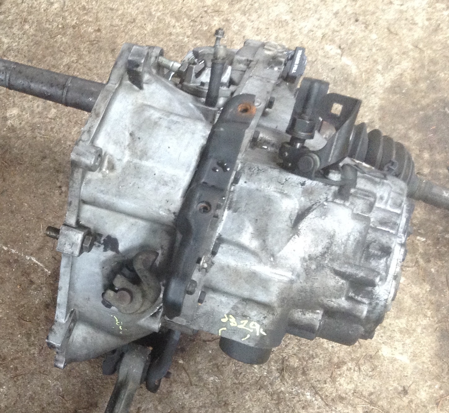

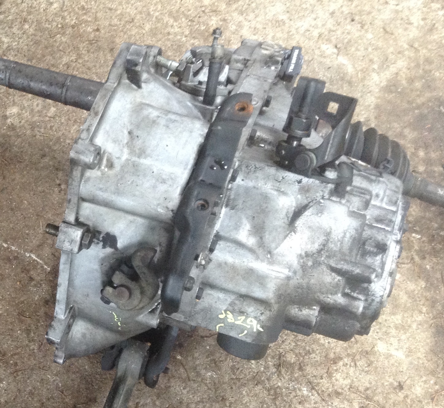

The Transmission: 1988 Muncie/Getrag 282, sourced from a Beretta GT. This is the oldest style of 282 -external slave-cylinder mounted on a steel bracket, and a fully housed jack-shaft. With it, I installed an LUK pressure-plate and the six-puck Stage-3 ceramic clutch disc from my GTU, replaced in that car when it got the 6-speed upgrade several years ago. This was the first clutch-disc in my GTU that didn't slip with the modified L367 3800 SC. Unfortunately, I've found that the LUK does not have sufficient clamping force for the LQ1 under boost...

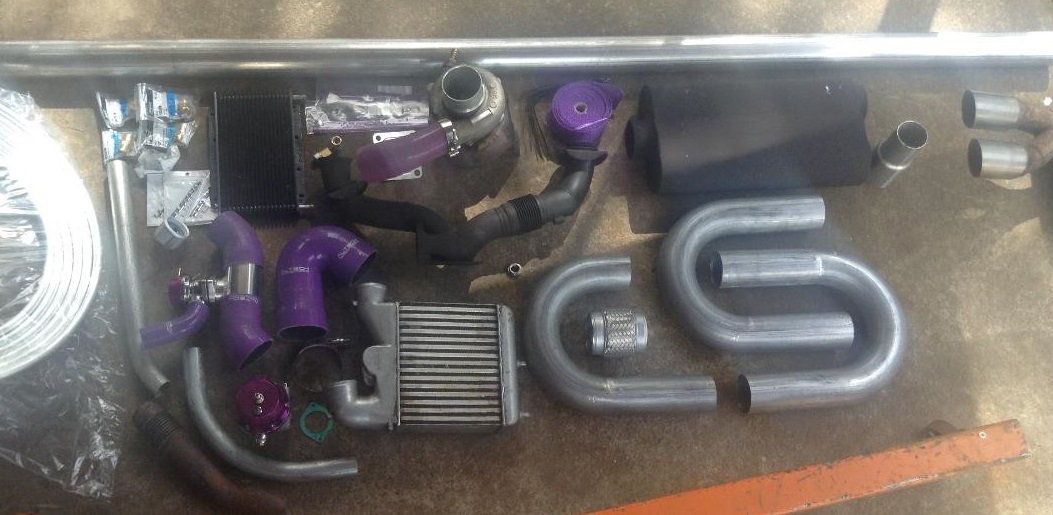

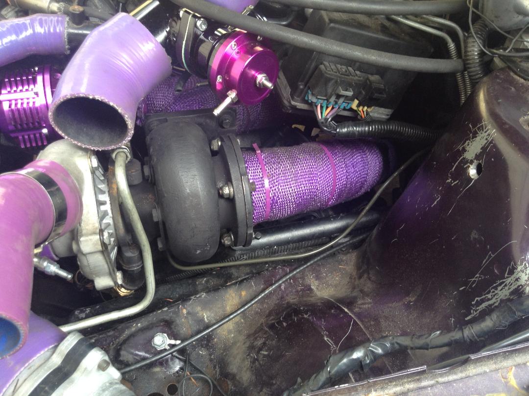

Boost? Yep: The Turbocharger is a Garrett T-04, externally waste-gated unit, sourced from my '90 Turbo 'Retta -the pushrod 3.4 in that car had some troubles spooling that big turbo, so I moved it here. Before that, the turbo was brand new. The intercooler is another Blackstone unit, a very compact one that fits under the hood, where the battery usually sits. A full 3-inch mandrel-bent exhaust system runs back to a dual-out Flowmaster muffler, which then terminates in Twin Dual (see what I did there?) Z-26 exhaust-tips. A high-flowing short cone-filter keeps it fed on the 3-inch inlet side, again, still kept inside the engine-bay. A silver-faced backlit Vacuum/Boost gauge installed at an angle to the side of the instrument cluster clearly displays the 9-pounds of boost the wastegate is currently dialed in for. It will look more at home once I swap in the silver-faced electroluminescent gauge face from my other '95 Z-26...

The exhaust cross-over pipe had to be modified for the Turbo -but that was an optional add-on. Stock, the LQ1 is designed to exhale through 2.25-inch outlets, per bank! That is over twice the outflow given to the 3100, and matches the single 3-inch pipe I used after the turbo almost exactly. Oil supply and return lines were also made necessary for the Turbo, and I opted for a large oil-cooler to help prolong the big Garrett's lifespan.
The Clutch Line had to be altered due to the size and location of the Turbocharger. Plastic generally does not belong in an engine-bay, in my opinion, and the clutch-line is no exception. Mine is now steel, with AN (37-degree) flared fittings and adapters in place.

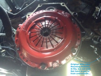

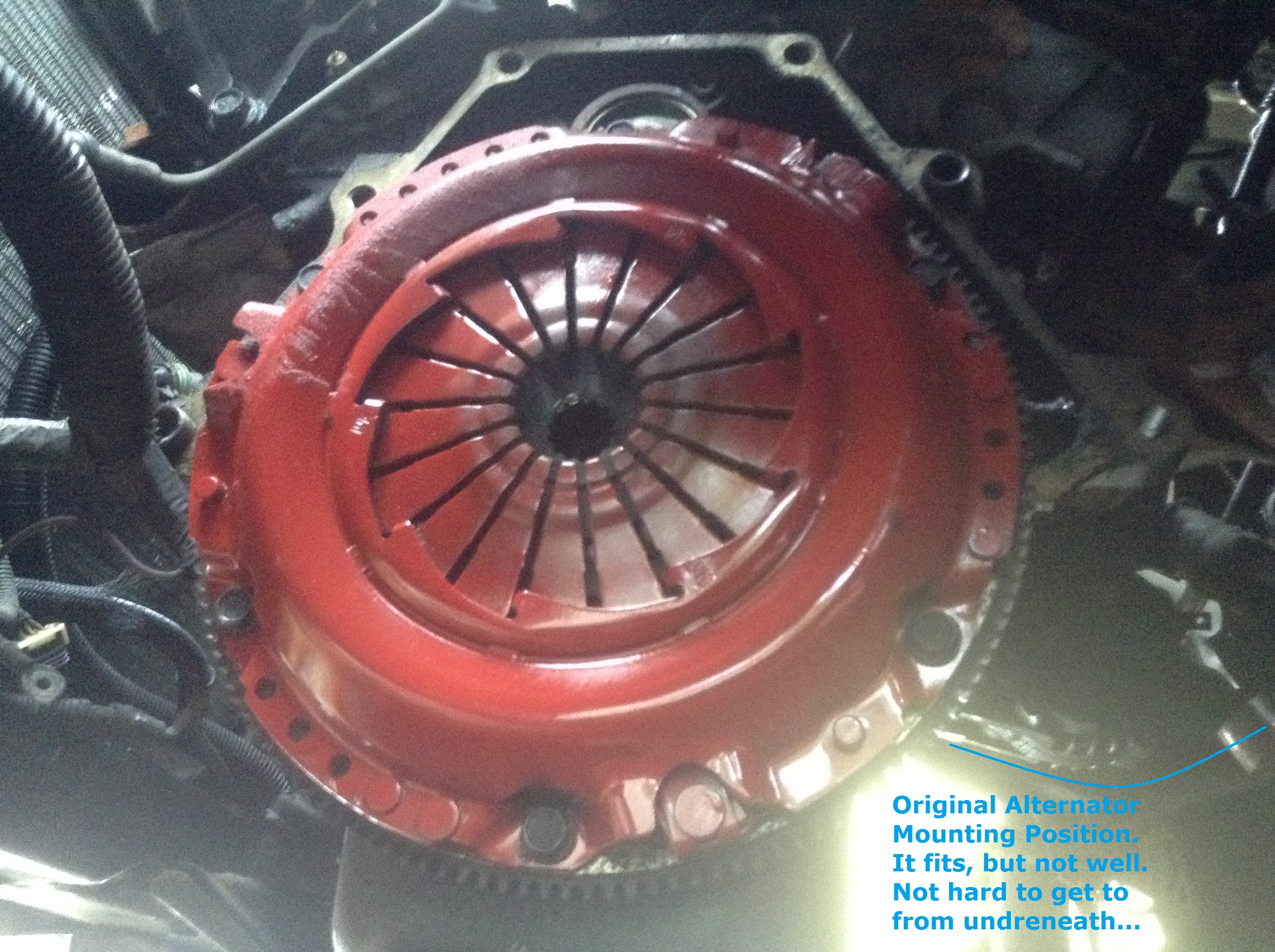

The Big Chill-Less, also known as the Compromise: The alternator on the LQ1 is mounted low, and to the rear of the engine. The Berettas have a frame-rail that arcs inward there, and unless I wanted the engine propped up high, the alternator wouldn't fit. So, I relocated it to the A/C compressor's spot, and deleted the A/C system. I can live with that -I also don't live in Arizona! The engine now uses a shorter belt, and while I've had concerns over the belt's contact to the water-pump which has changed due to the alternator's smaller diameter pulley, the car runs cool and consistent (according to my scan-tool, reading through the ECM).
