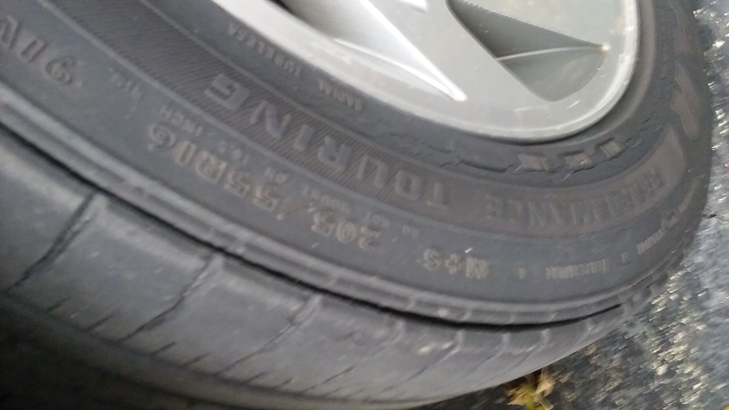

I'm thinking I need some new tires due to dry rot.

ya, those look like they've seen better days. One of my Nankang NS1s grew a huge blister out of the sidewall this fall. The rears on my 17" wheels are origional so.....almost 19 yrs old.
- Posts: 4764
Wow...that looks...really bad. haha I got some old studded Goodyears on my car right now to roll it around and the dry rot is nowhere near that bad. But they leak like a sieve at the bead. They are DEAD overnight.

I bought some Douglas tires from Walmart. They get good reviews and are supposed to be made by Goodyear.
My old tires were Goodyear and about 11 years old. I read they had recalls for cracking awhile back.

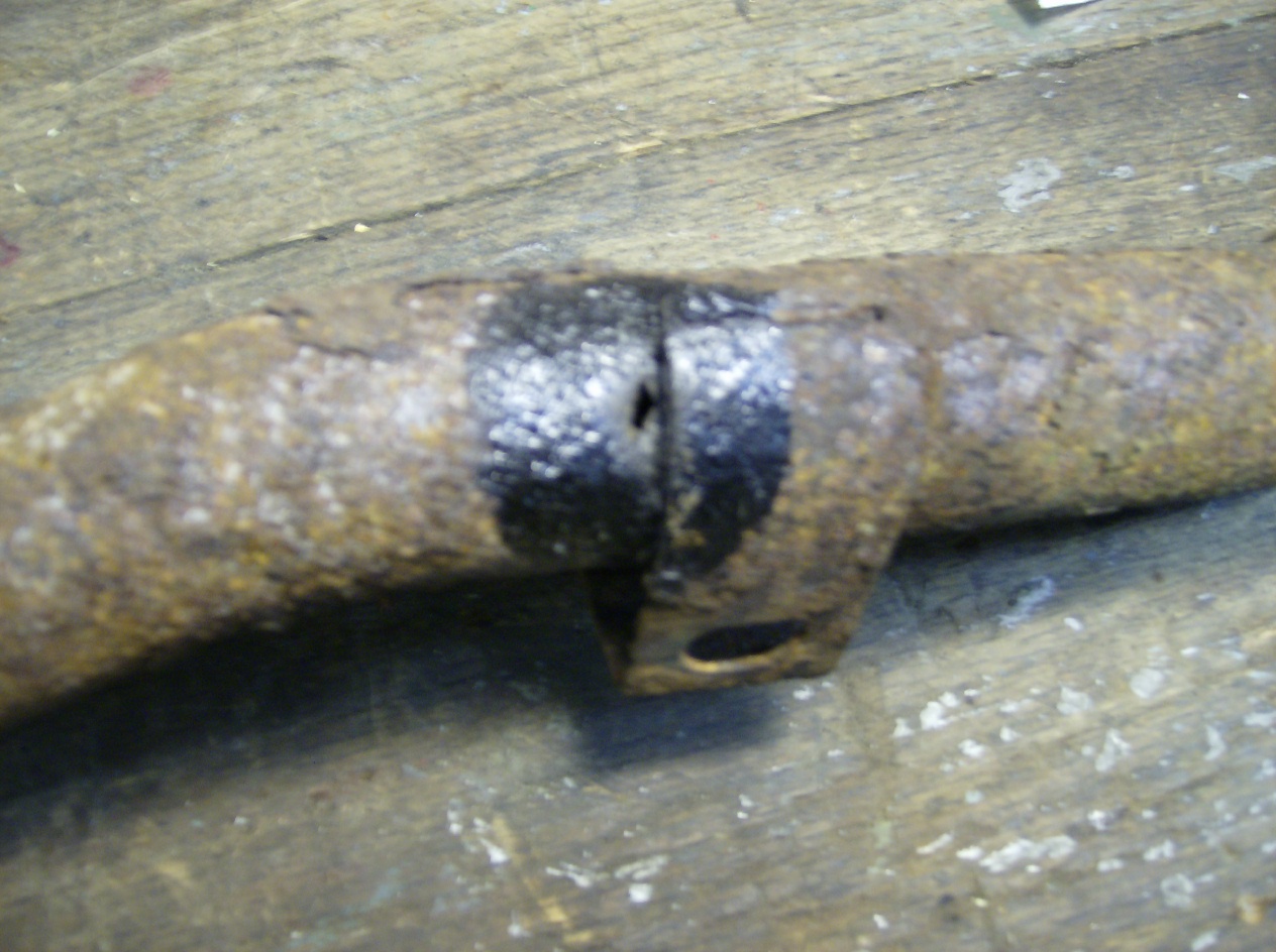

steel wheels back on the 88. Also, here is a photo of my old filler tube. Good thing I found how bad it was before I spilled gas when filling up.

Holy crapola! I've never seen one of these rust before!
I was under the impression that the filler tube was a pretty common rust spot for us in the rust belt, that's why you see many berettas missing the fuel fill door too, the whole area rusts.
Mine was packed with mud when I got the car, but I cleaned the heck out of it, sandblasted, and painted it.
Rock Auto has them I believe.
