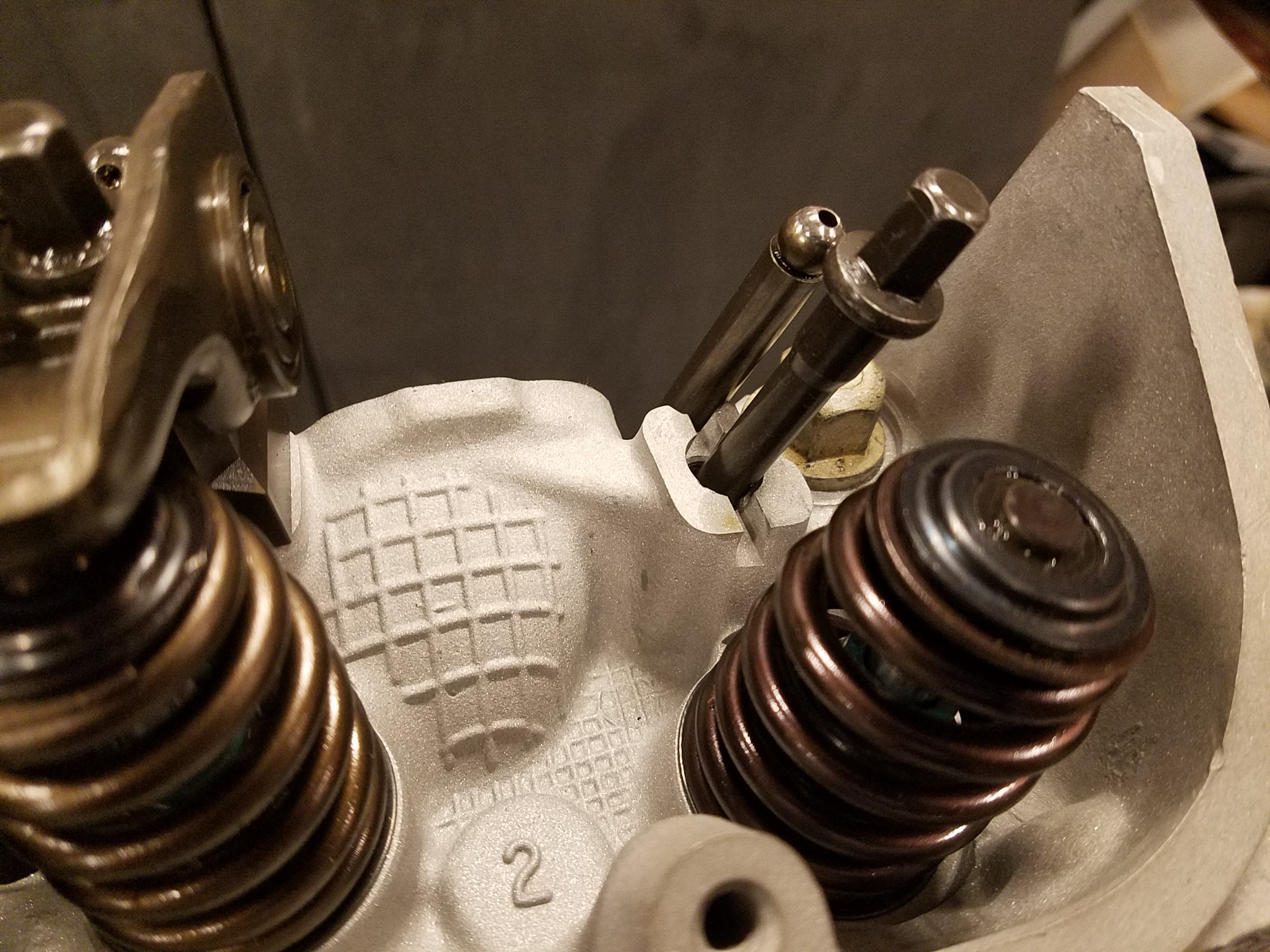

And in other news...the new lifters didn't fix the noisy valvetrain. I measured the preload on every single once with the new lifters and it's great on all of them. So for now...screw it. The exhaust note is clean and it's running fine, so that's how it's gonna stay.
You can see the old ones didn't spring to the top of the barrel like they should. They wouldn't even disassemble completely. I did disassemble all of the new ones just to be sure they were clean and there were no issues. I really thought that would be it!

I had a thought on your valvetrain noise. I had concerns over this in the first place, but you handled it so slickly that I dismissed my concerns, and the lifters were an obvious problem, so... Considering how much trouble you have been having and what you have already eliminated as likely causes, could this be causing your issues?:
On the stock rocker-bolts, the shoulders 'flare out' both to ruduce the stress-riser at the head, also to ensure a snug fit at the rocker.
With the VW parts used, there is no flare, and the entire length of the stud is threaded, which also slightly reduces true diameter on most parts that are not designed as interference fit.
Even IF the rocker cannot shift back and forth at the top, are you SURE it cannot slide back and forth at the bottom? Have you inspected the studs for any indication of impact from the rocker, either at the top or the BASE of the pedestal? Is it possible that the studs are flexing under the loads? What about the top section of the rocker, with the roller-shaft, could it be pivoting at the top and sliding back and forth on the top of the pedestal? The elongated flare on the shoulder of the stock bolts would also prevent that action, so maybe another reason they were designed that way...
It may simply be time to turn up the volume on the radio and put on a louder muffler... :roll:

Yeah, I've been super-skeptical about the step studs since that's the only thing "exotic" about this setup. I've examined them closely every time they've been out and went over them with Ben, too.
There are a few things I'm sure of:
The pedestals do sit flat on the head, so the 10mm lower portion is not affecting the seat of the 8mm pedestals.
There is no visible contact on the threads of the stud, either by the pedestal or the rocker trunnion. (There was on one, where a rocker had loosened, but I caught that the same day and it was a distinctly different sound.)
I cut a conical seat in the nuts on the top side so they will self-center on the stud like the oversize shank on the stock bolts.
A couple things I think:
The diameter of the stud threaded vs non-thread shouldn't really matter, because the pedestal bottoms out on the head and the rocker trunnion bottoms out on the pedestal. There isn't anywhere for it to flex like an old SBC rocker stud would. The 8mm bolts also have a reduced shank for most of the length that is probably similar to the strength of the 8mm threaded stud.
The small variation in preload that I have cylinder to cylinder may be due to mismatched rocker pedestals and arms. Perhaps they are measured and matched at the factory like lifters are. But the small difference is all within spec of what Ben calls good preload.

I saw the conical cuts you made on the lathe, that was the main reason I had dismissed my worries about the VW studs. But I got thinking (often a problem that generates many more problems), and this is what I am saying about the extended shoulder on the OE bolts:
Rettax3 wrote:Is it possible that the studs are flexing under the loads? What about the top section of the rocker, ["trunnion"], could it be pivoting at the top and sliding back and forth on the top of the pedestal? The elongated flare on the shoulder of the stock bolts would also prevent that action, so maybe another reason they were designed that way...
1,000 words in about two minutes of "I hurt my back too much to want to move right now" boredom.
My thought is that the 'trunnion' may be pivoting with the slight side-force applied by the pushrod, which could cause impact noise against the stub, plus whatever vibrational noise as the bottom of the trunnion grinds along the top saddle of the pedestal base, and would change effective distance between lifter and rocker arm. Not much, and I really don't see how it could cause an audible noise without visible damage to the threads of the stud, but valvetrain is a finicky thing. The gap (orange) between VW stud and trunnion (purple) could cause movement. The OE bolt would prevent this movement.
Personally, I never liked the 8mm rocker-bolts anyway -too rinky-dink for an aluminum head IMO. As I've said, I have seen them pull out. I don't even know when they switched from the larger bolts, but it might be worth a trip to the junk-yard for beefier parts that offer stock components. :pardon:
As you have said though, with that cam and other upgrades, you may be stuck with what you have, I'm just surprised in that case that Ben wouldn't expect it too -it isn't like your engine's stats are a new or unusual thing for him.
Bottom line I guess, is that hydraulic lifters are supposed to take out any slop generated by imperfect pushrod length (and change-of-length caused by changes in engine temperature, of course), and they tend to be very forgiving. Using MPFI heads on my 3400 LA1 block with stock Ram-Air H.O. cam (nothing special) and OE roller lifters, I was able to mix-n-match pushrods from both engines to fit the 3400 roller-fulcrum rockers I custom installed -I have never had any valvetrain problems with that engine, and I put that together for the '90 Turbo 'Retta about seven years ago... You are already about six stages of sophistication beyond that build, so I cannot imagine you have a preload or pushrod length problem.

So you're wondering about the rounded bottom of the roller actually sliding. I just looked through my photos and don't see one that would show yes or no, but I would really doubt it. The amount of force it would take to overcome the friction to twist that clamped section with a lot of surface area has got to be exponentially more than rotating at the fulcrum on needle bearings. I would think.
I do have a set of 10mm rockers from my neighbor's 200k Impala that got junked and they weren't any better. But they also sound "clackier" just shaking them by hand than my lower mileage ones. I can buy a set of brand new replacement 10mm rocker arms for $170, but I may also need new pushrods again. And I'm not going down that road unless I get to Bfest this year and Jon's is noticeably more quiet than mine. Because I just don't know how loud this is compared to "normal" for one of these modified engines.

woody90gtz wrote:So you're wondering about the rounded bottom of the roller actually sliding. I just looked through my photos and don't see one that would show yes or no, but I would really doubt it. The amount of force it would take to overcome the friction to twist that clamped section with a lot of surface area has got to be exponentially more than rotating at the fulcrum on needle bearings. I would think.
I am sure it wouldn't rotate as a unit when it could just rotate on the rollers, I agree, but a side-load imposed could cause a pivoting action at the top, near the bolt-head (or nut, in your case). Was just a thought... I would slap-in the extra set you have access to, at least on the front head, before throwing more money at it for a 'maybe' fix -like Jon says, this may just be part of the territory for upgrading the heads -but I have no idea how bad it actually sounds in real life, so...
More clearly what I mean.  Hold the rocker in one hand by the trunnion, and try to hold it 'still' with your finger at the top where the bolt-head should sit, then push sideways on the rocker body -watch the trunnion pivot as the rocker moves side-to-side.
