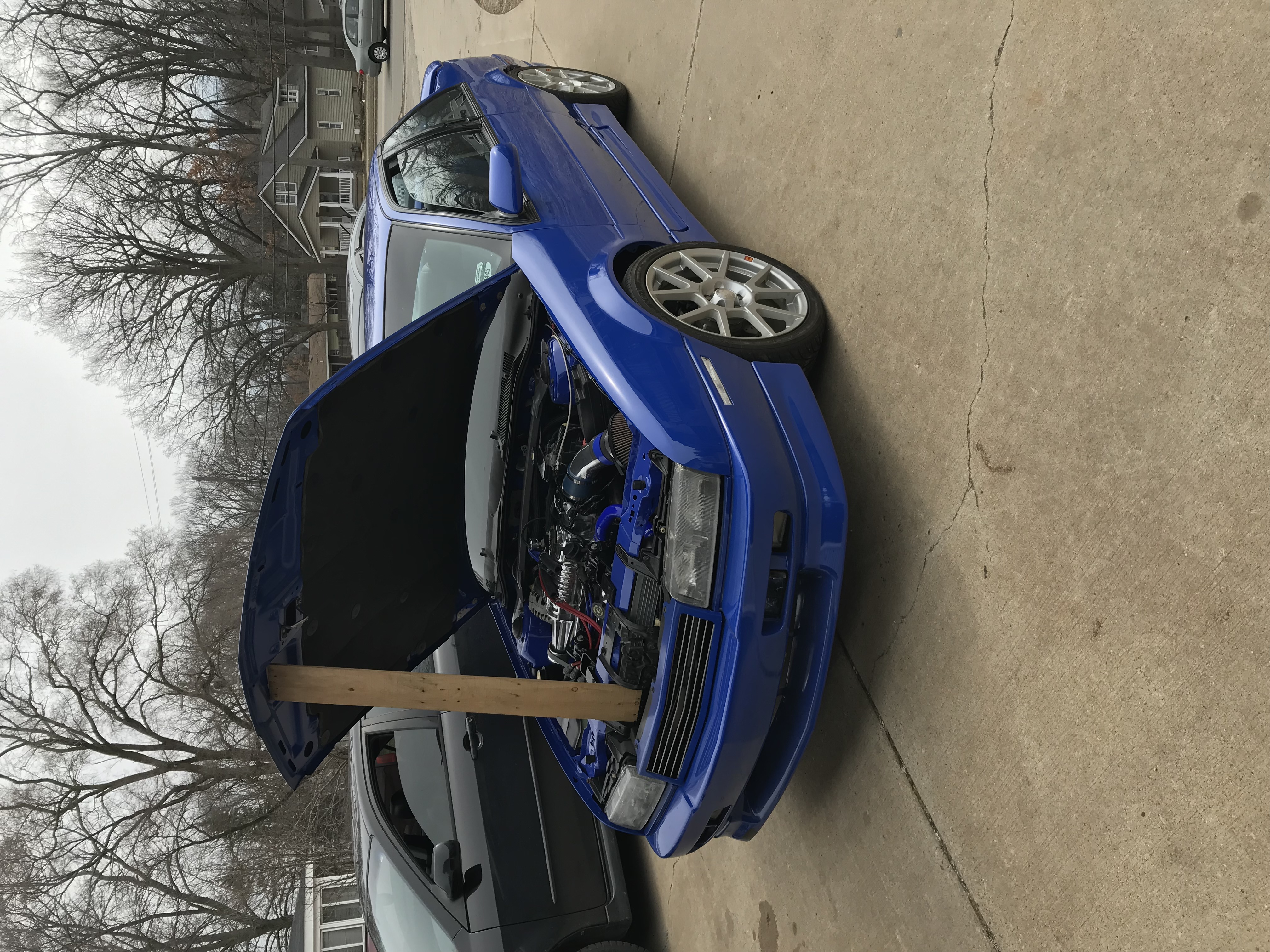

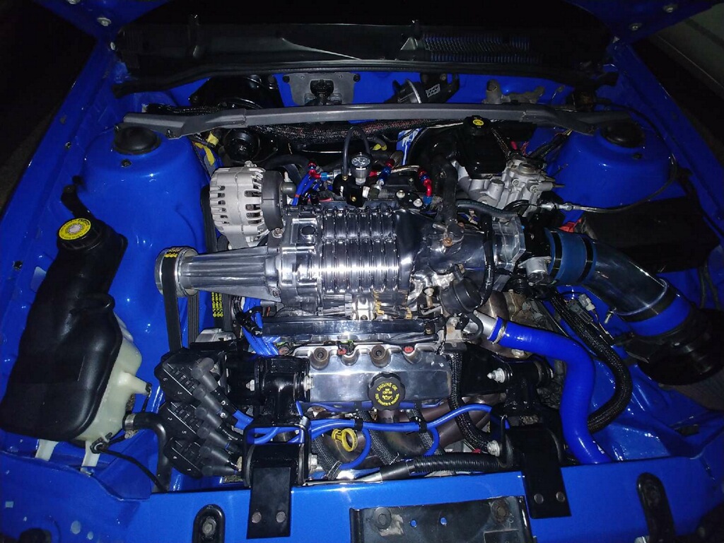

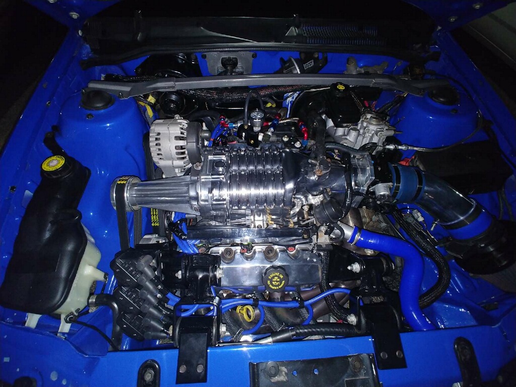

My name is Justin Coleman.New to the site.I have a 1994 beretta Z26 with a 3800 supercharged.Will try post some pics.Looking to attend the beretta fest this year.Will be my first.Hoping someone may be able to help me out.Looking for a rear disc set up off a neon,so i can finish my conversion.Having a hard time here in Michigan finding anything.Any help is much appreciated.

Engine bay
Engine bay

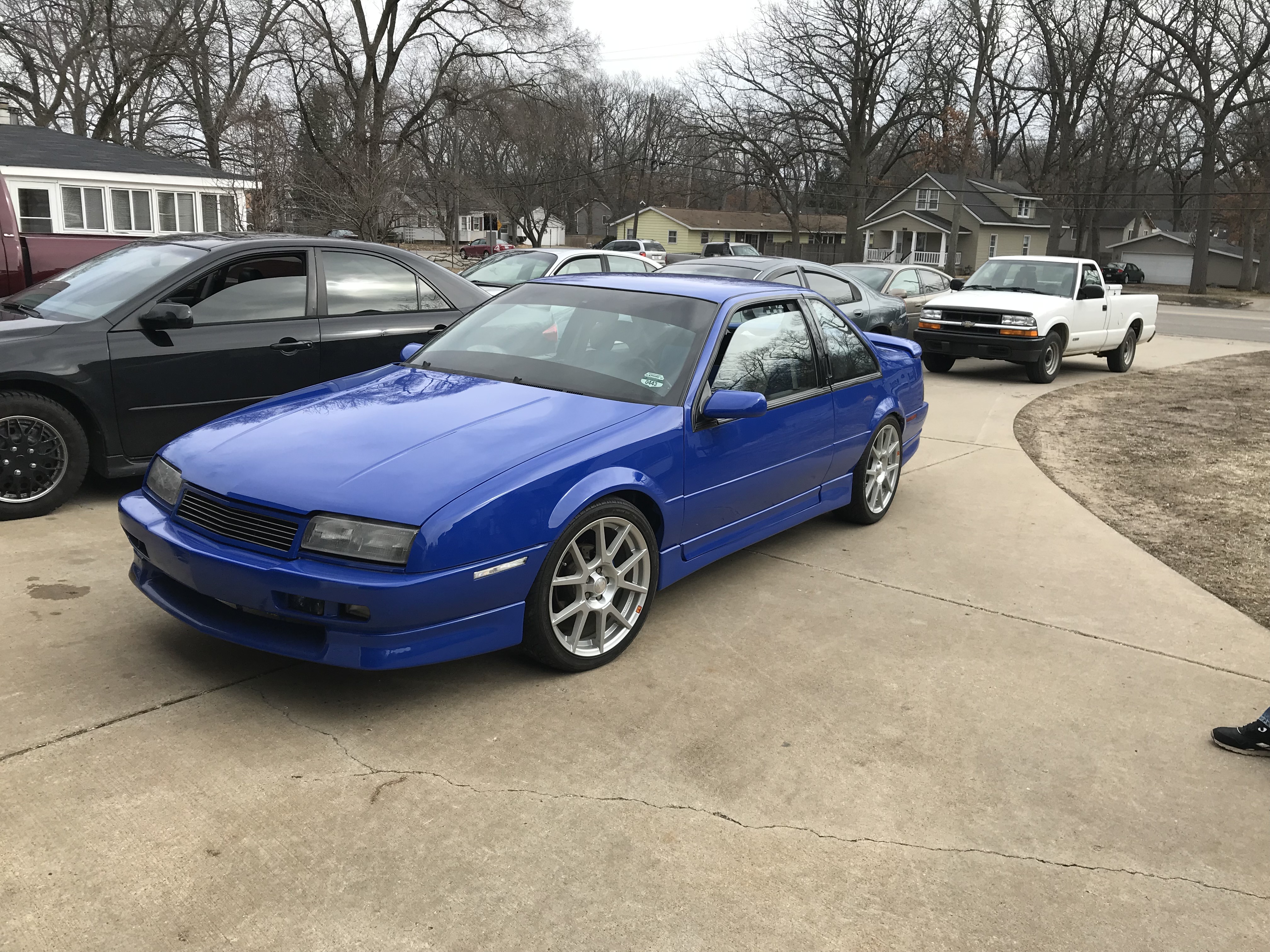

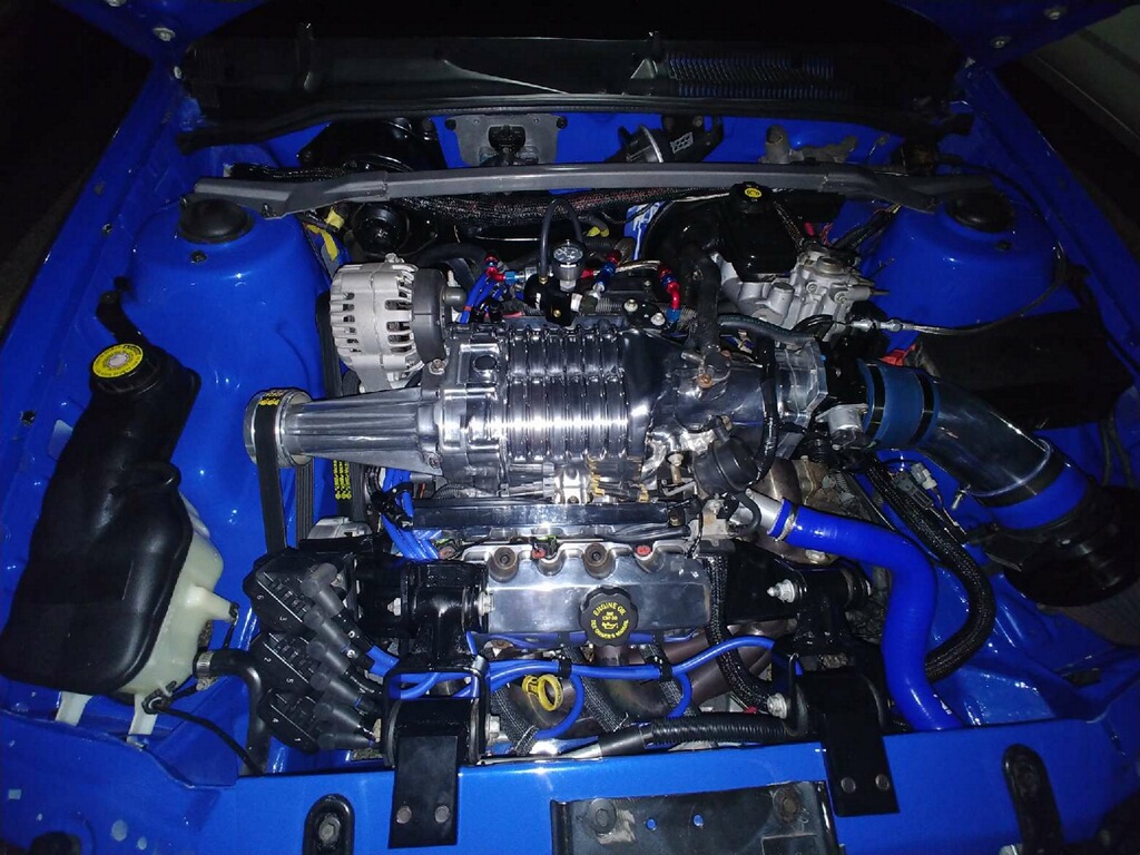

Welcome to the site, Justin! Nice to see another 3800 S/C Beretta. Yours looks like a Series 2 L67? I see you changed your S/C pulley, what PSI are your running? Very cleanly built car, nice job! :good:

Thanks, yeah running a L67 with a gen 5 charger.its also cammed,ported heads and lower intake.Running a 3.2 pulley for now.Still needs to be fine tuned.Around 10-12 pounds of boost.

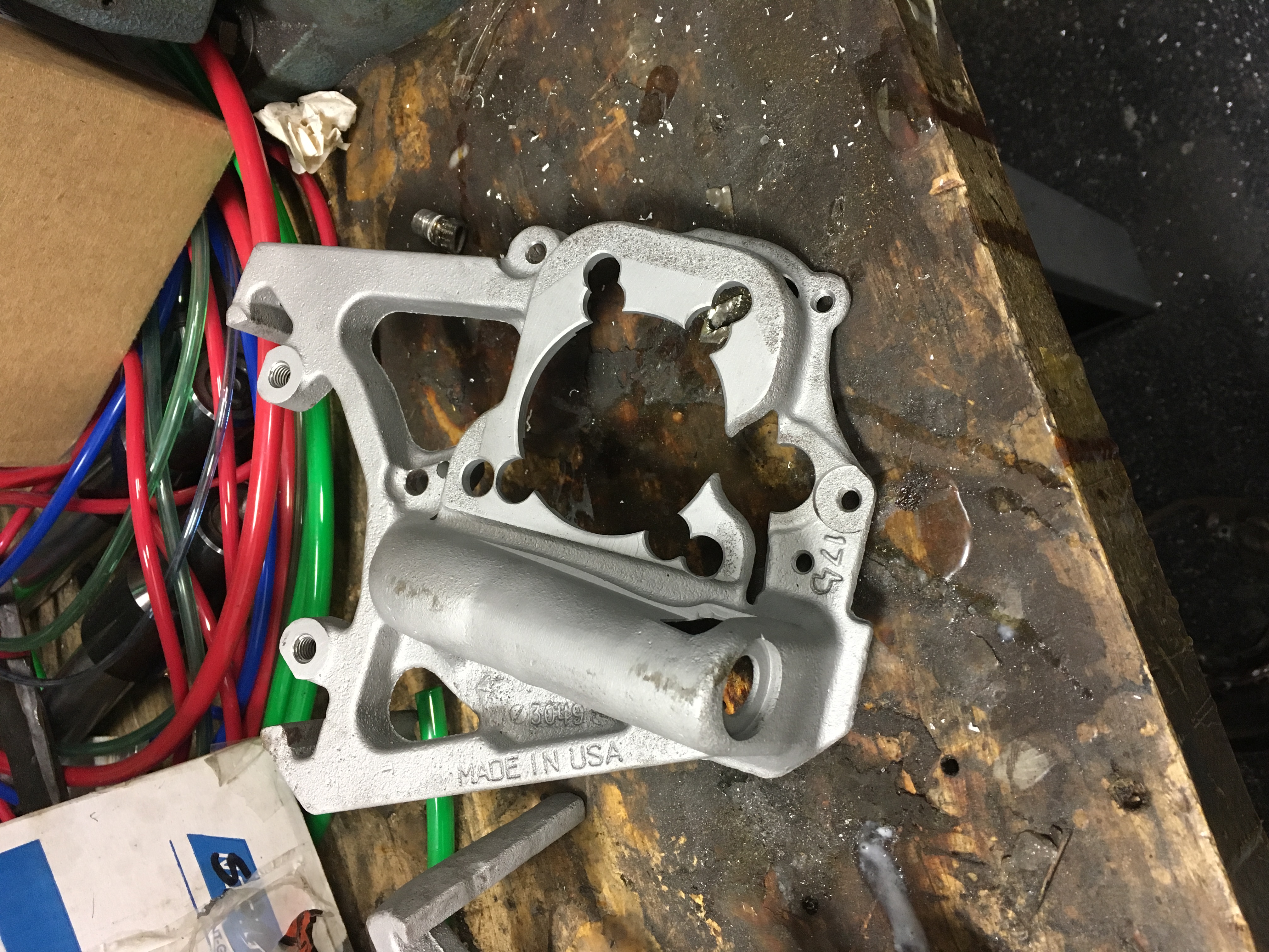

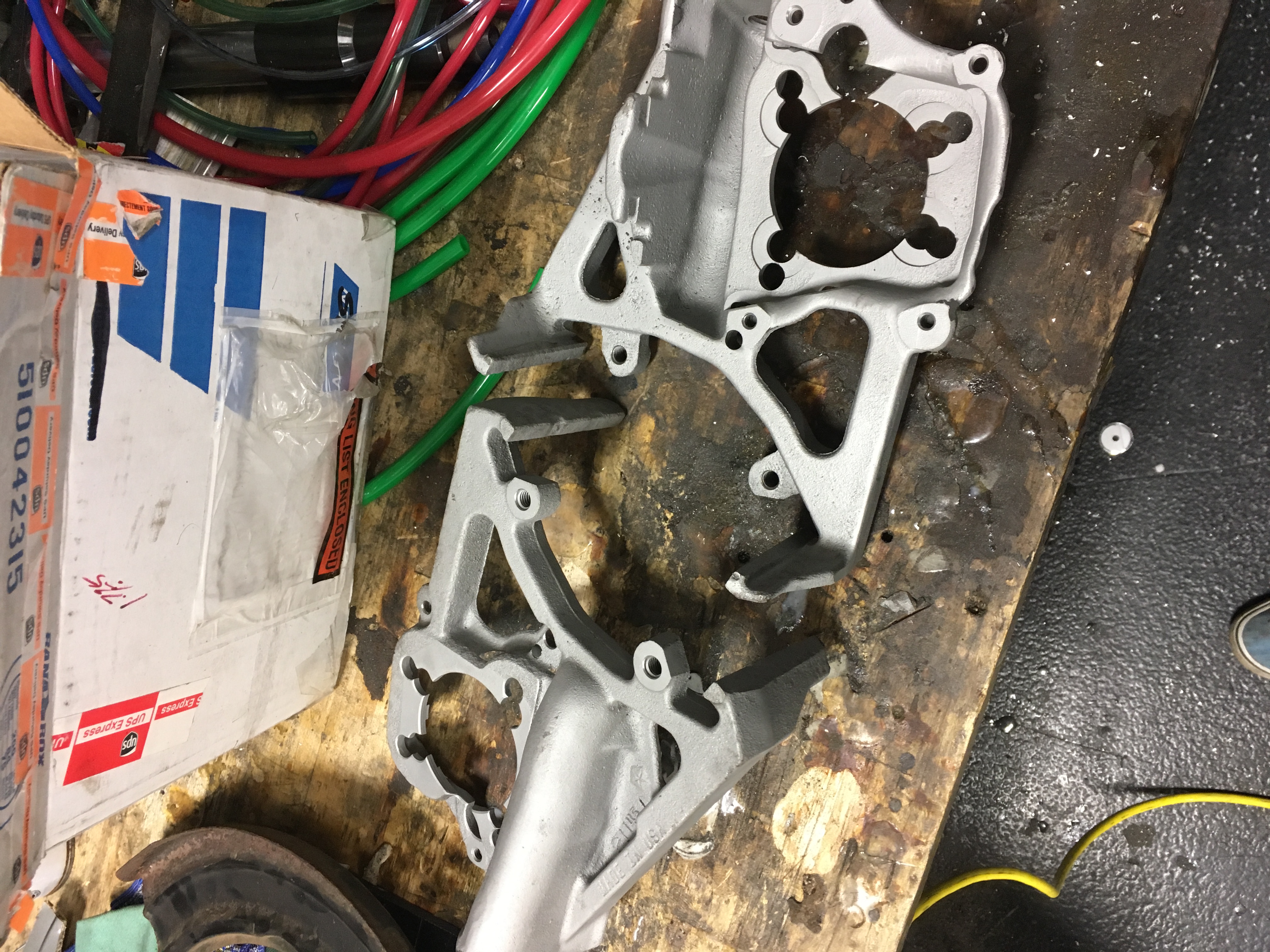

ImageSorry for hijacking, but what were these holes for on the neon bracket? I have modified brackets and thinking to weld them shut, as they are over the rear axle mounting point (dust will get in).
Re: New to the site.Looking for Dodge neon rear disc set up
Those holes were for an ABS sensor on the Neon...

3X00-Modified wrote:Those holes were for an ABS sensor on the Neon...
Ok thanks. Then they are going to be filled :D

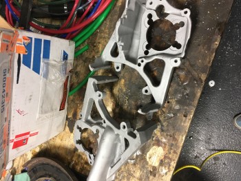

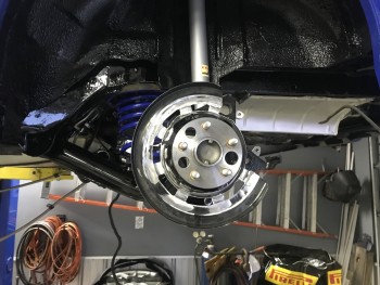

Found some brackets and backing plates.

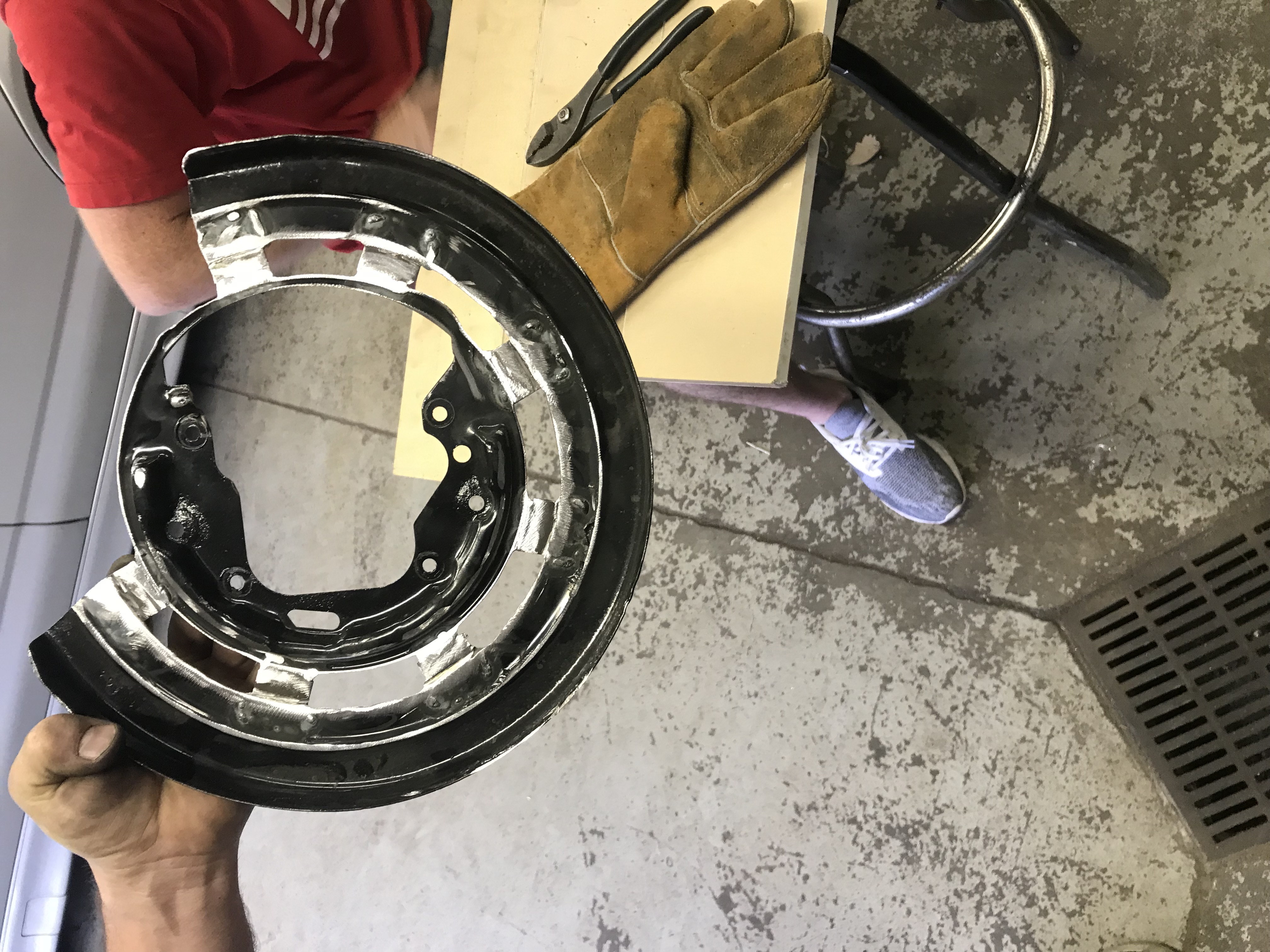

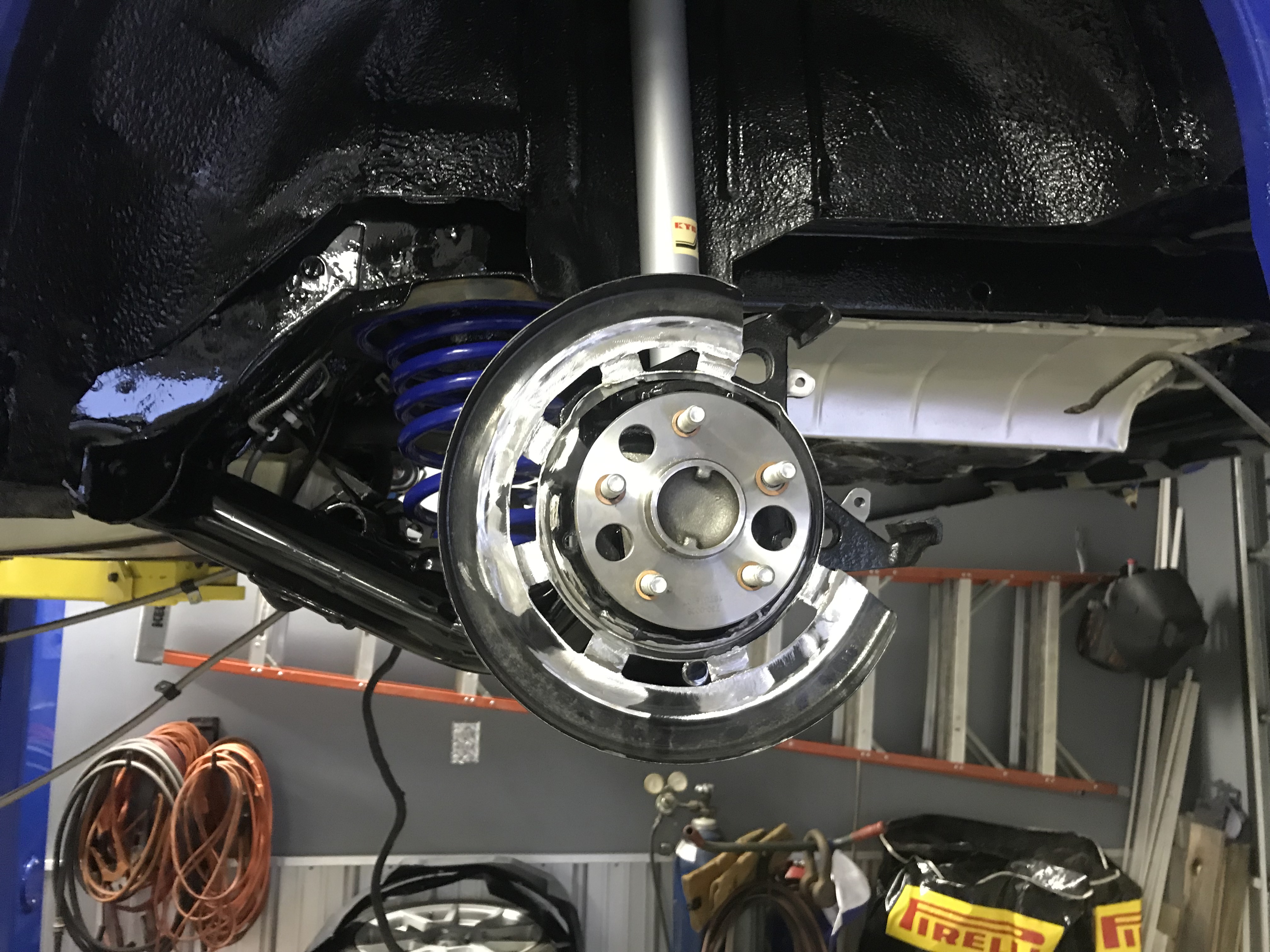

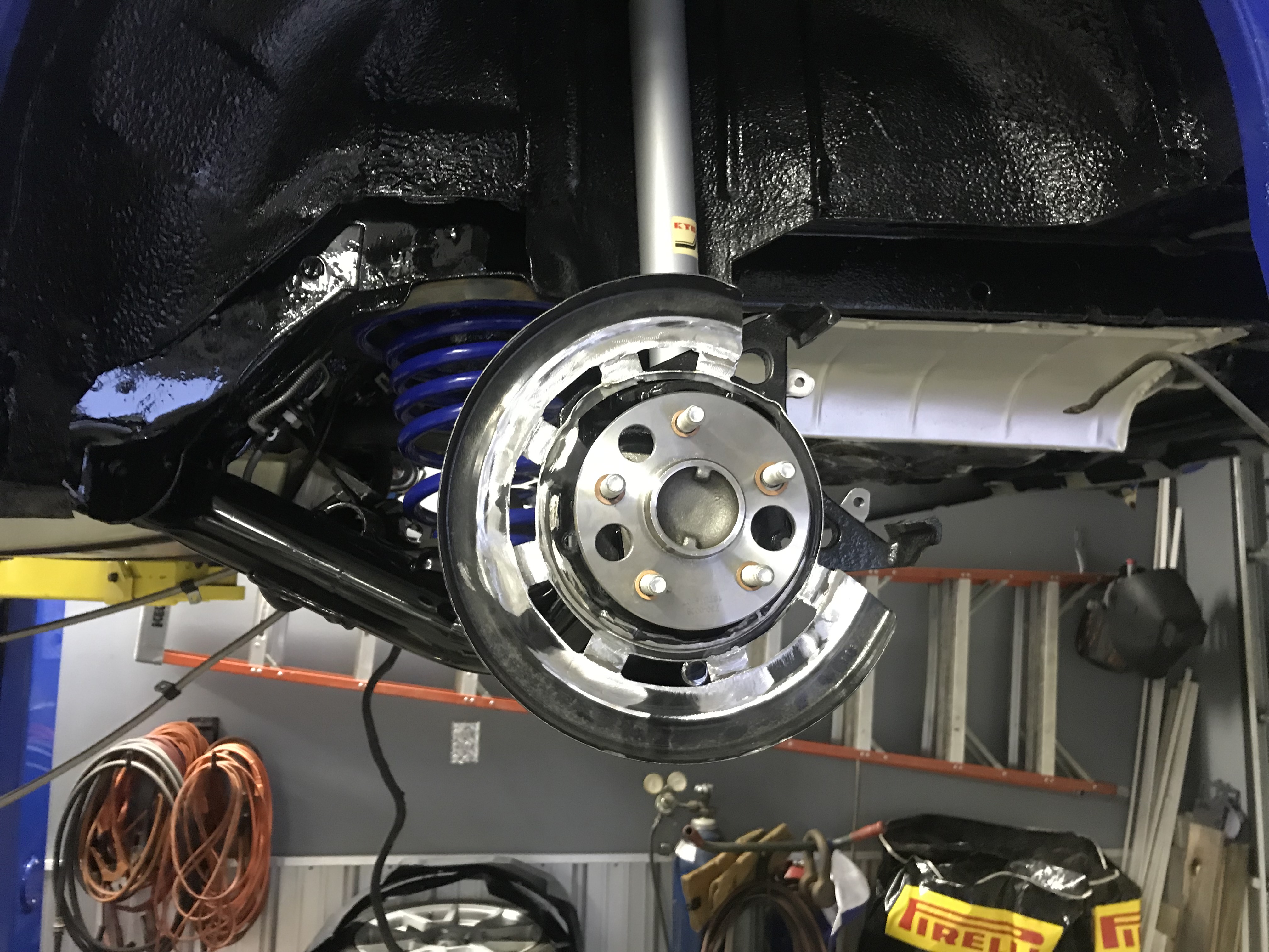

Some info for everyone.found a lot of the Chryslers cars came with the same rear caliper brackets.Mine are off a 2002 300m.Still need to machine the brackets the same as a neon.I modified my backing plates so the rotor didnt have to be spaced out with washers.Cause my wheels are already in the
edge.
