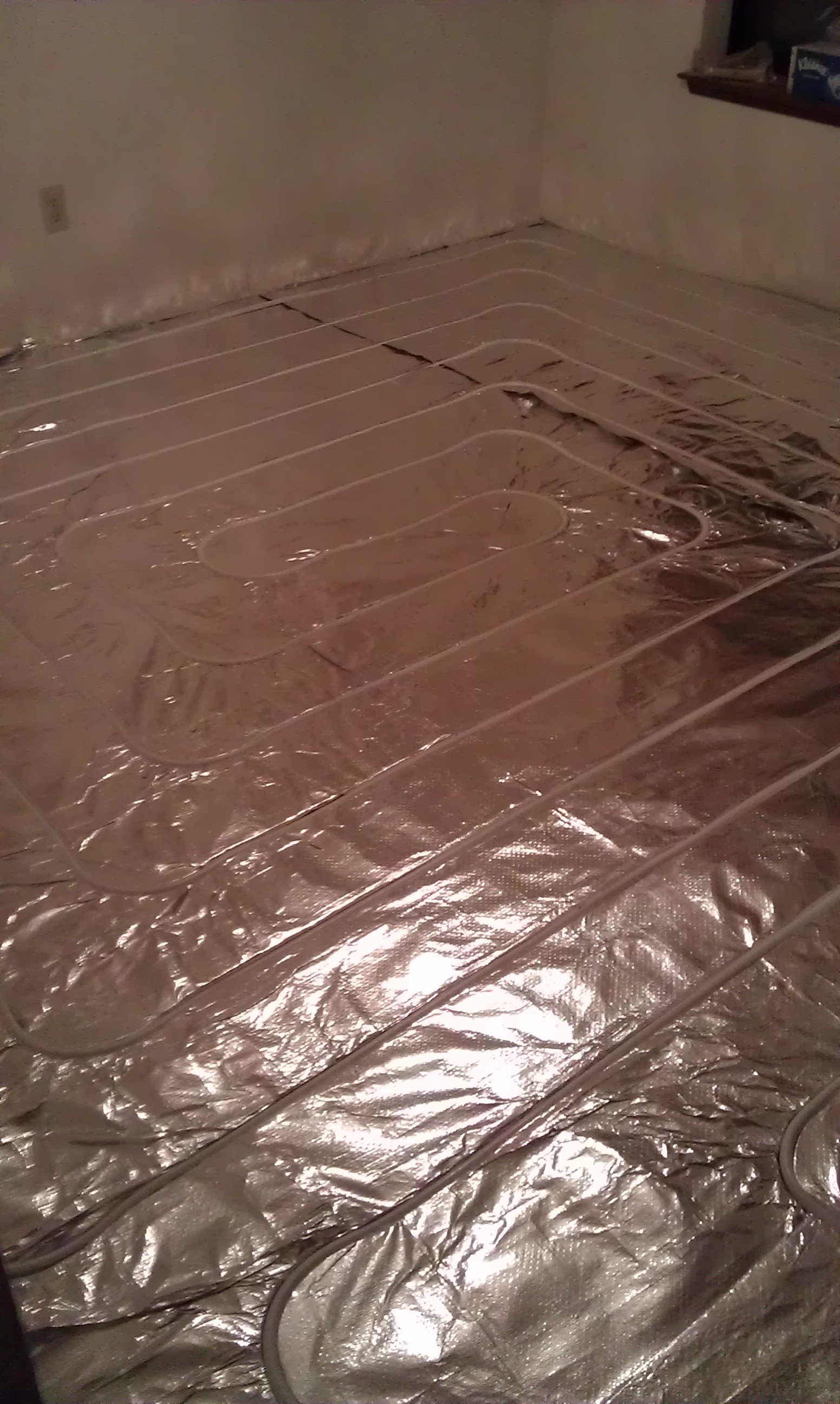

Second layer of 3/4 subfloor paneling -adds strength, rigidity, and a place for a 5/8-inch deep channel...
Ready for beam-up!  It looks like a space-ship in here... Or the insides of a giant refrigerator, but either way...
But this looks much nicer!  Feels great just to walk on it too.
This was the first room I did, I'm just going room-to-room redoing as I go. The living-room has three separate loops (pretty big room, but I could have gotten away with just two) and is 2/3 done now with the sub-surface stuff. It is taking a lot longer than I had hoped, but it will all be worth it in the end, I think. I've been learning the fine art of making more spare time in the day, so I could use it on this. So far, I am up to about 25.7 hours in each day, :crazy: but I've got to get better at it so I can get this thing done.

Looks like you did a great job on the floor. I personally don't get heated floors. Maybe for floors on a slab.
Does it heat the room or just keep your feet warm?
Pardon my ignorance but then I have carpet in my dining room. haha

ifixalot wrote:Looks like you did a great job on the floor. I personally don't get heated floors. Maybe for floors on a slab.
But seriously folks, I know I have a lot of updating to do in my home.
Thank you, it is a lot of work, but is coming out well. I enjoy projects like this, knowing I did the work myself. Of course, I take that too far... :roll:
The electrically-heated pads that get used in front of bathroom vanities and such only keep your feet warm, and are a comfort item that cost a lot both to install and to operate. I don't really get those either -put some socks on for crying out loud!
But, a full hydronic system (hot water or other fluid) like this actually IS the primary heat-source for the room (or whole house). They are considered one of the most efficient heating sources currently available, and the technology has come a LONG way recently, making them even better. I am installing a 7-loop system, so each loop (or 'zone') can be individually adjusted for need. One catch on hydronic systems is that you can't just flip a switch and turn it on and off -especially with hardwood floors you can do some damage to them that way, but since this will be heating 90% of the house, I don't want it getting super cold at any time anyway. Each loop can be controlled thermostatically with electrically-operated supply and mixing valves, I'm not sure I am going that route. Right now, I am setting-up for a mechanical system, the distribution manifold I have is adjustable for both pressure and flow-rate, so I can fine-tune it for need with a heat sensor. I am in a pretty temperate climate now, so the system won't be over-worked at all, and can use a low temperature fluid-supply that won't be able to hurt the floor even if I 'forget' to monitor the system for minor changes. If it is too much effort, I can easily retrofit the electronic 'zone' controls.

I need to update the radiant floor system that is in my (current 3 season room) to control it better... It's a three level concrete floor room with 3 separate loops that all tie into one circulator... It was installed in 1972 when that addition of the house was built. It needs the 3 slabs isolated as well as the slab temp monitored so it can maintain that temp and not allow the slab to cool off to much, that slams the furnace when it would start up to maintain room temp... Went through way too much oil last year trying to keep that room warm till after Christmas Eve... That wont happen this year, lines are all emptied for now.

Radiant heat is really nice. Even and comfortable.

As for the heating, I've actually had to turn everything down a couple of times, it was getting too warm in the house. I bought a high-efficiency three-speed circulation pump, and everything is being regulated mechanically at the manifold valves -no electronics needed. It hasn't gotten really cold here yet, but we still have our fireplace if we need to boost it up a little, and I've got safely at least 20% higher supply temp I can go on the heater, and watching the cycling, the heater isn't being stressed at all. So far we haven't wanted to go even near the fireplace after turning the floor on. I got a great deal on a Watts accumulator, and found a good company that sells brass plumbing fittings for a good price, so virtually the whole system is made of aluminum-layered PEX tubing and brass fittings, no actual 'pipes' anywhere in the system, and as few fittings and joints as I could manage to minimize leak potentials.

Just a quick update to this for anyone who may be curious. After comparing our electric bills for the past few months to those from last year, our heated floor is costing us about $200 per month to operate in the colder months, but is SAVING us nearly $100 per month in propane heating costs. Our house is overall a little warmer feeling (it is actually quite cool, but doesn't feel that way at all due to the more efficient heat transfer), and when we visit other houses without heated floors, we find we are spoiled rotten -everything else just feels uncomfortable and cold, no matter how warm their house is.
