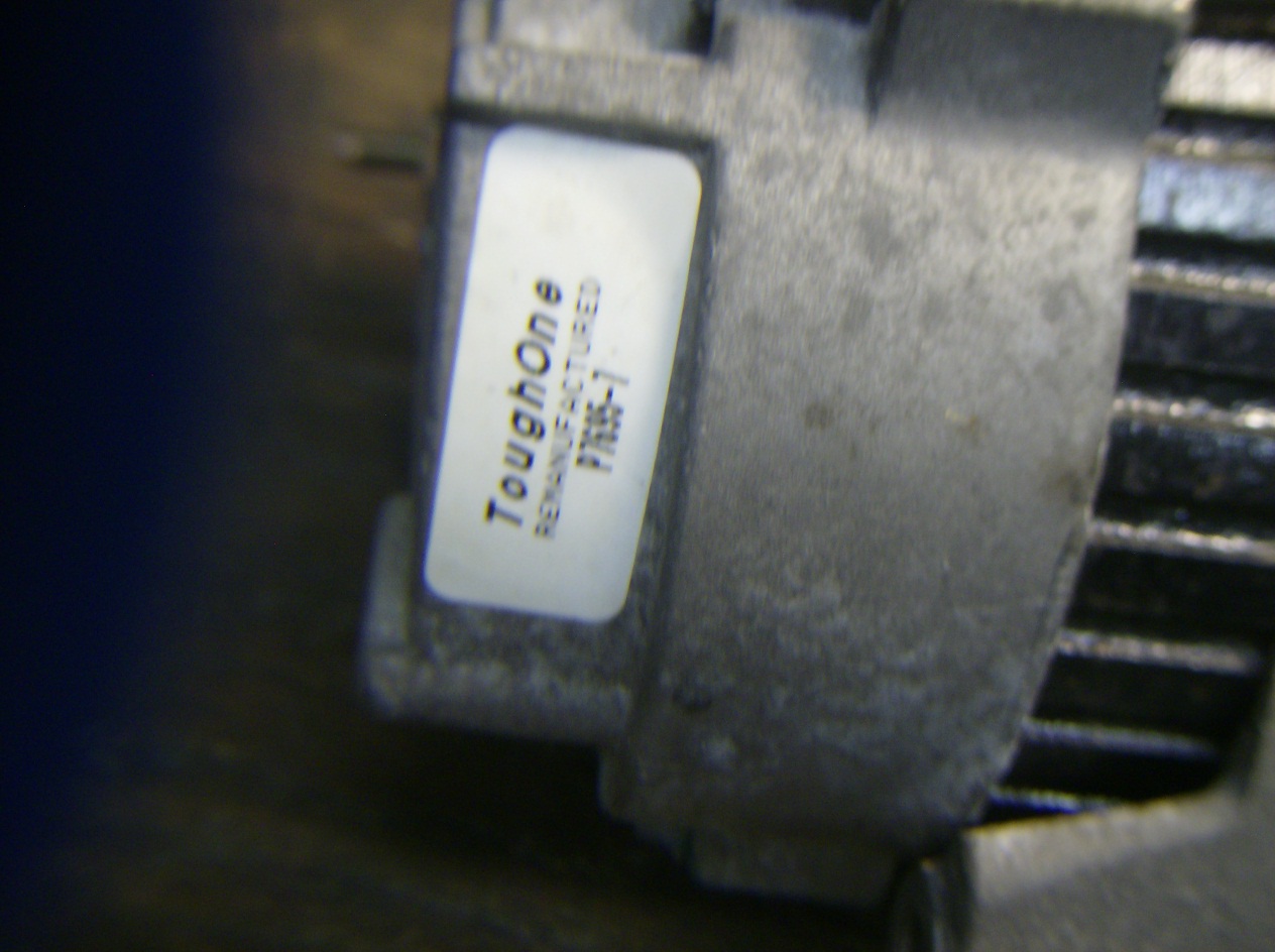

Next day I'm driving the 88 and I look at the volt meter. It's above half way so I think all is well. BUT, I didn't have the AC on.
So I turn it on and the volt meter goes down to below half. But nowhere near the warning marks on the meter.
I decide to check voltage with a good digital meter when I get home.
With no AC on, I get 13.4 volts but with AC on and fan on high, I get 12.6 volts even while revving the engine.
So it turns out, this alternator is not putting out enough.
I swapped it with a good used one off my mini van, swapping the pulley. Now I have 13.4 volts with the AC on.
When removing the bad alternator, I see it was a rebuilt unit. I wonder if it was bad after the rebuild or died in service.
I've had aftermarket parts go bad after very little use.
