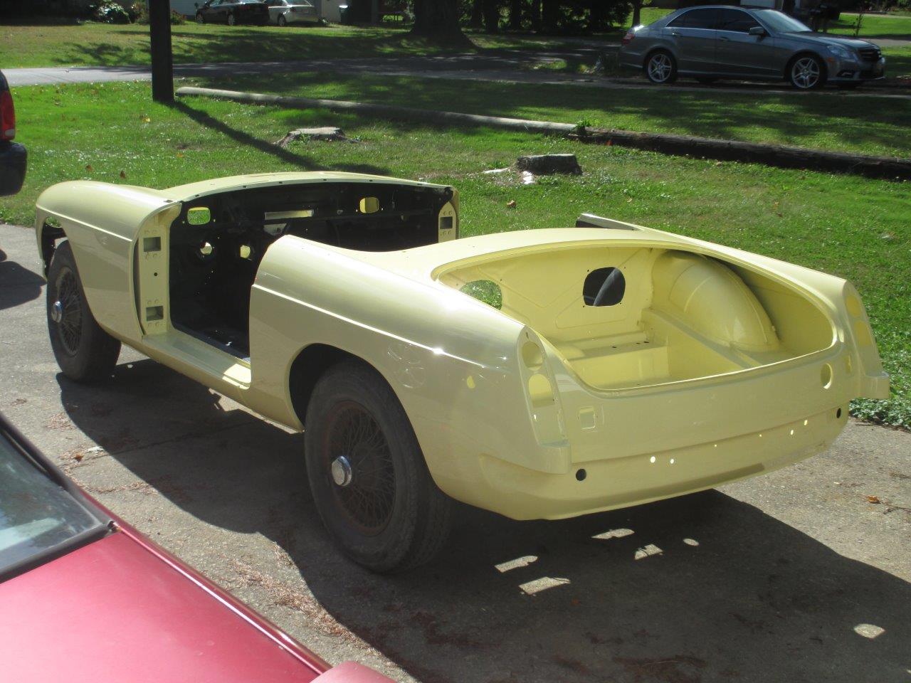

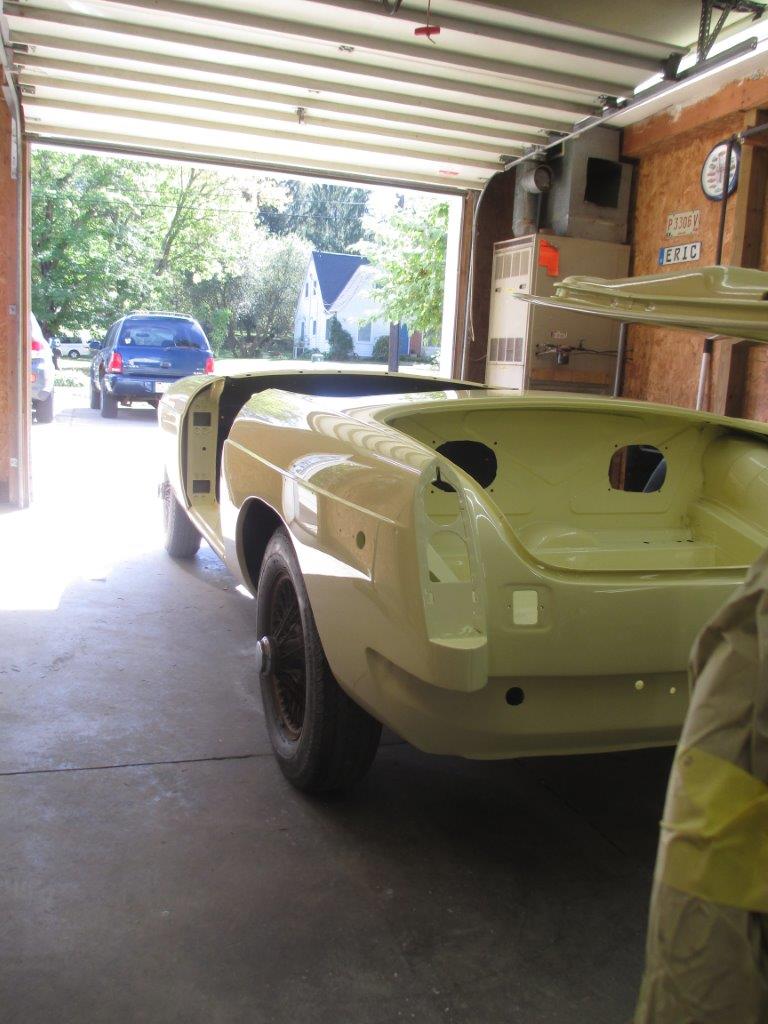

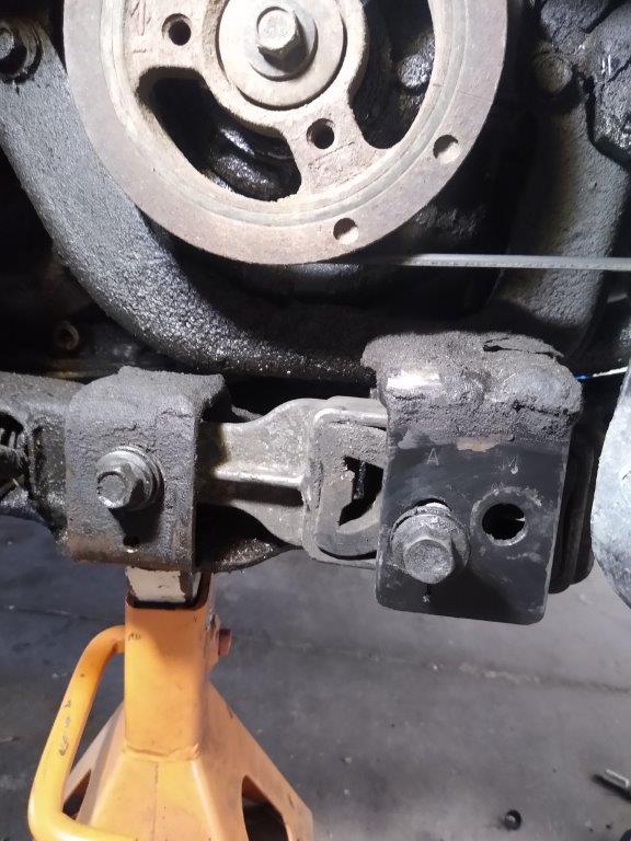

Finally have finished the resto on my MG, so the Beretta gets to share the garage with it! The Beretta is still running great, just oil changes. The only thing I've done lately is the lower dog bone. It had a crappy Anchor one I had put on when I first bought it. It had about an inch of play in it, so I put the OEM one back on. I noticed that I've been driving it for years with the front bolt in the "M" hole instead of the "A". Oops! Or maybe it was like that already and I just repeated the mistake.

Can't see much of it from that shot, but what I CAN see looks like a really clean little MG! Must feel pretty good to see so much effort turn into so much progress towards the end and finally turn a corner on it. I don't know if I ever do look at one of my cars and say, "Well, that is done.." Congrats!

I didn't show much of the roadster since it's non-beretta, but thanks it's been a long time coming.Rettax3 wrote: Yep, gotta watch out for those "A" holes. -Sorry, it is late, I had to do it!

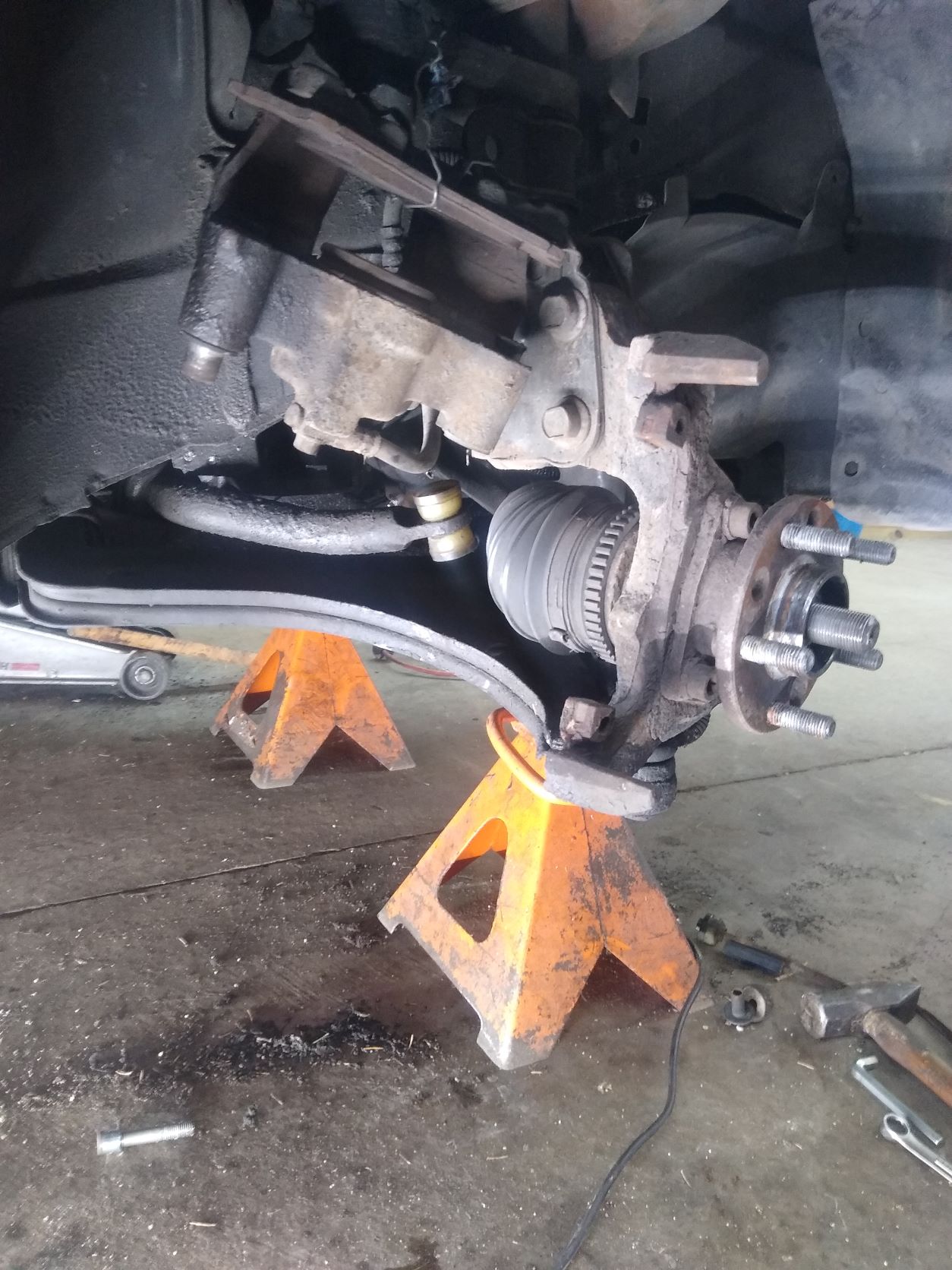

I decided it was time to investigate the extreme vibration/shuddering that I've been experiencing which hasn't gotten any better..
I recently changed jobs so now my commute is all highway. This issue is worse at 70mph or so. Before I was pretty much country driving so it wasn't a big deal
Anyhow first I took the wheels and tires off and took them to get balanced. Same issue. I got the idea that it was something with the CV axles, and I found there to be some lateral (I think that's what it's called) play, which they shouldn't really have in my experience.
Ordered some closeout cardone axles from RA for $25 each, figured I could always put the originals back in..
Same issue. I moved the front dog bone back to the "M" bolt position where it had been for a long time, same issue.
The trans mount is OEM AFAIK, and looking in the engine compartment it appears that the drivetrain is slanted toward the driver's side when looking from the front.
I haven't messed with the mount yet because all you can get are the crappy anchor ones, and I can't get the center Allen cap screw in the mount to budge.
I still think it's a tire/wheel issue. The car came with 17" wheels that seem way too heavy for the suspension on that car, I sure wish I could've got the crosslaces with it. Plus I cheaped out with the Summitomo tires, so maybe one is bad.
This weekend I am going to risk my life by putting the 29 year old donut spare in one position at a time to see if I can eliminate one. I can get on and off the highway in 1 mile, so if it blows out my wife can get to me quick, lol
