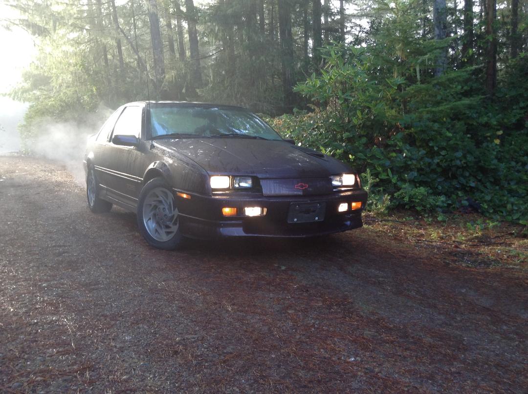

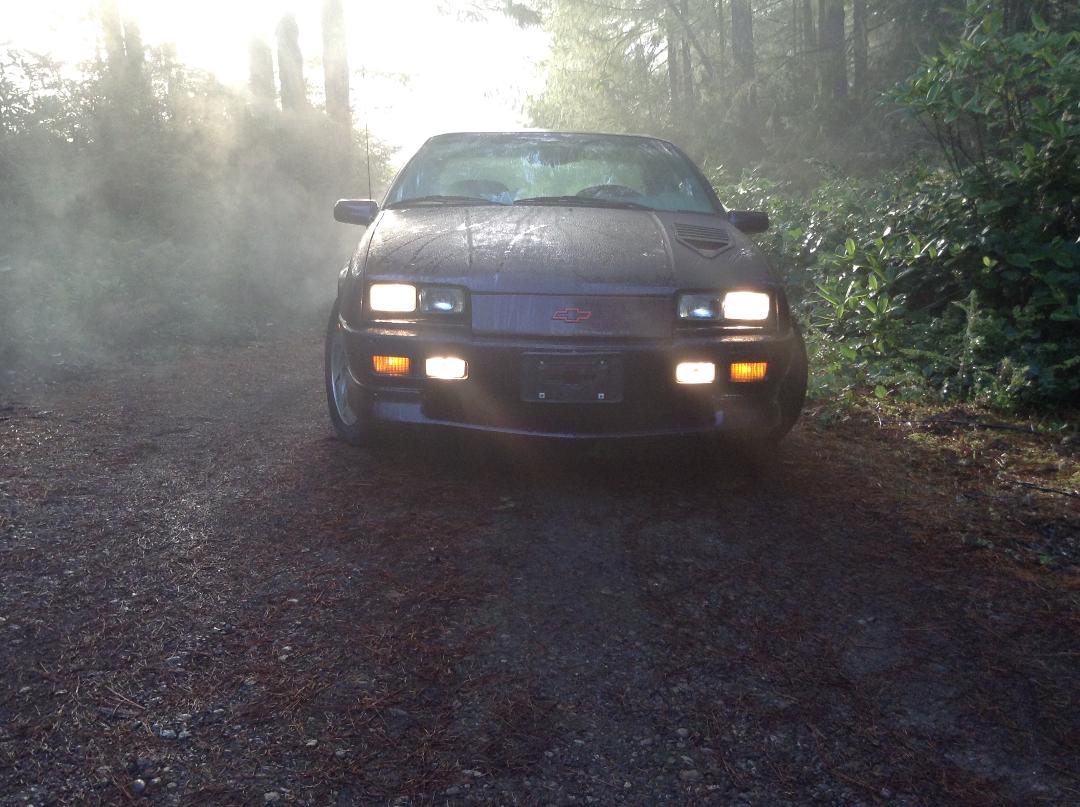

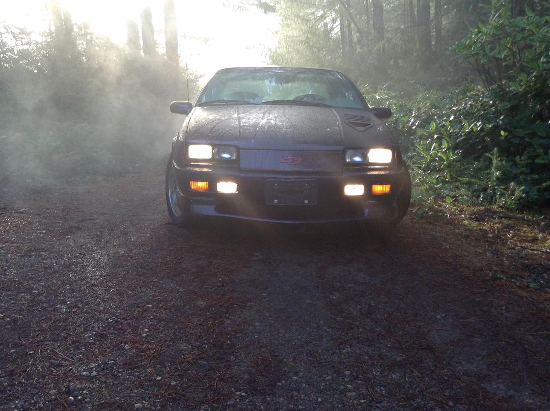

A little update on the car. A few growing pains along the way, finding there is enough drivetrain weight and torque to break the transmission mount and crush the original TPS on the brake master cylinder for instance, but overall doing well. I have finally gotten some OBD1 tuning equipment, so I'll be able to (eventually) get a proper tune on a chip for this thing and can start pushing the envelope a little.
I swapped on a correct-color junkyard hood in really good condition (the original is PERFECT, and I couldn't bring myself to chop a hole in it) and grafted-in the NACA-style hoodscoop to supply high-pressure air to the intake area and provide air extraction for the intercooler -I'll likely also duct some air over to blow on the turbo itself too, a LOT of higher-pressure air gets in that area. I also fabbed-up some Euro-type headlights using the non-composite option from an '89 pickup. A little trimming on the brackets and a major chopping of the Beretta's header panel was needed to make them work, but they do fit in there okay, and once the headlight surround 'buckets' are built, should look like a factory Euro to the untrained eye. I can still put the original Beretta headlights back in too, without having to replace the header panel with a spare if I want to, as the panel wasn't butchered beyond use for the Euro lights. The speedometer quit working in my other '95 Z a little while back, so I installed a GM HUD (Heads Up Display) from a Pontiac Bonneville (so cool!), and will eventually take the silver-face electro-luminescent gauge overlay and stainless steel instrument bezel from that car, which will match-up to this car's silver-faced boost-gauge and stainless steel shift-knob very nicely.
Not much else on the to-do list for it now. Fun car, fast, sounds good and looks good inside and out (and underneath too) -can't say it was easy to get here, but also can't say it wasn't worth it. Loads of time but right around $1000 for everything there. Cheers!
