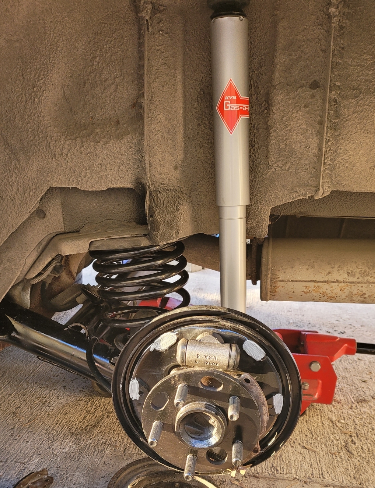

I completed the rear install of Eibach springs and KYB shocks. It was a very easy and straightforward install. Use a car jack to hold the rear subframe from falling when removing the old shocks! The old lower washers from the stock shocks will not work on the KYB shocks. I used just one washer that was included with the KYB kit and placed it between the strut and the upper rubber mount. That was the only way I could get it to work. I have seen a Monroe kit available for this situation but did not have that information at the time. The old stock top washer that's sits inside the trunk in the rubber mounts work fine. May order a Monroe kit in the future. Ignore the picture attached showing the stock washer on the struts. As mentioned above this has been addressed.

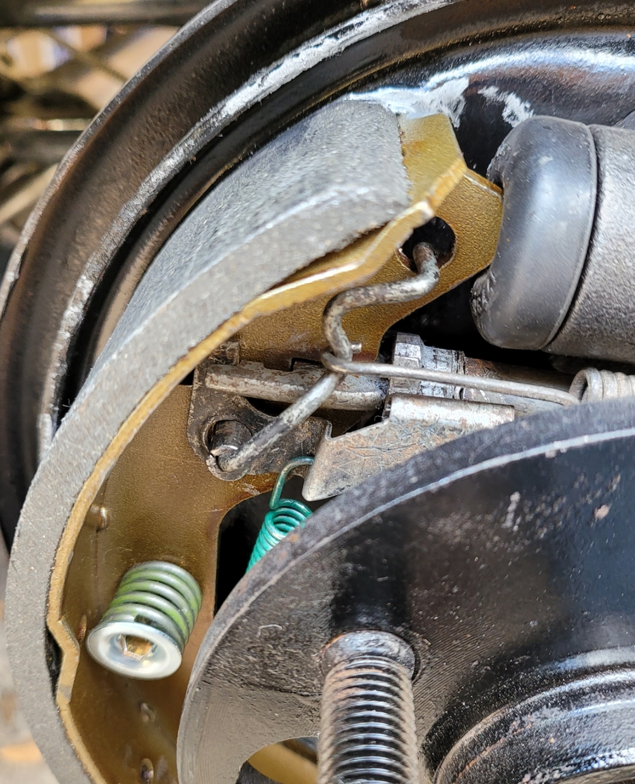

Now, drums were the hardest part of the rear.
Drum brakes are a hassle! Seriously going to consider the Neon rear brake swap! And to think I had a Srt4 for parts at one point.
Posting images of how the drums should look once completed. Once you do one side the other side is a breeze. Soo many springs and brackets!

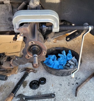

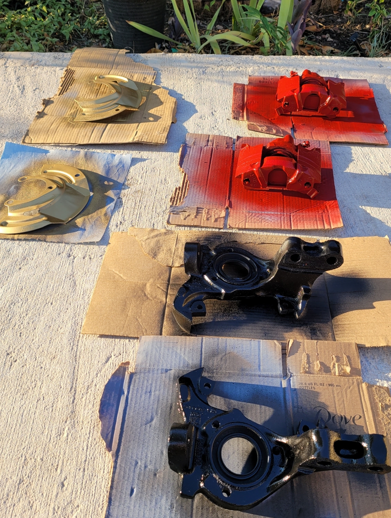

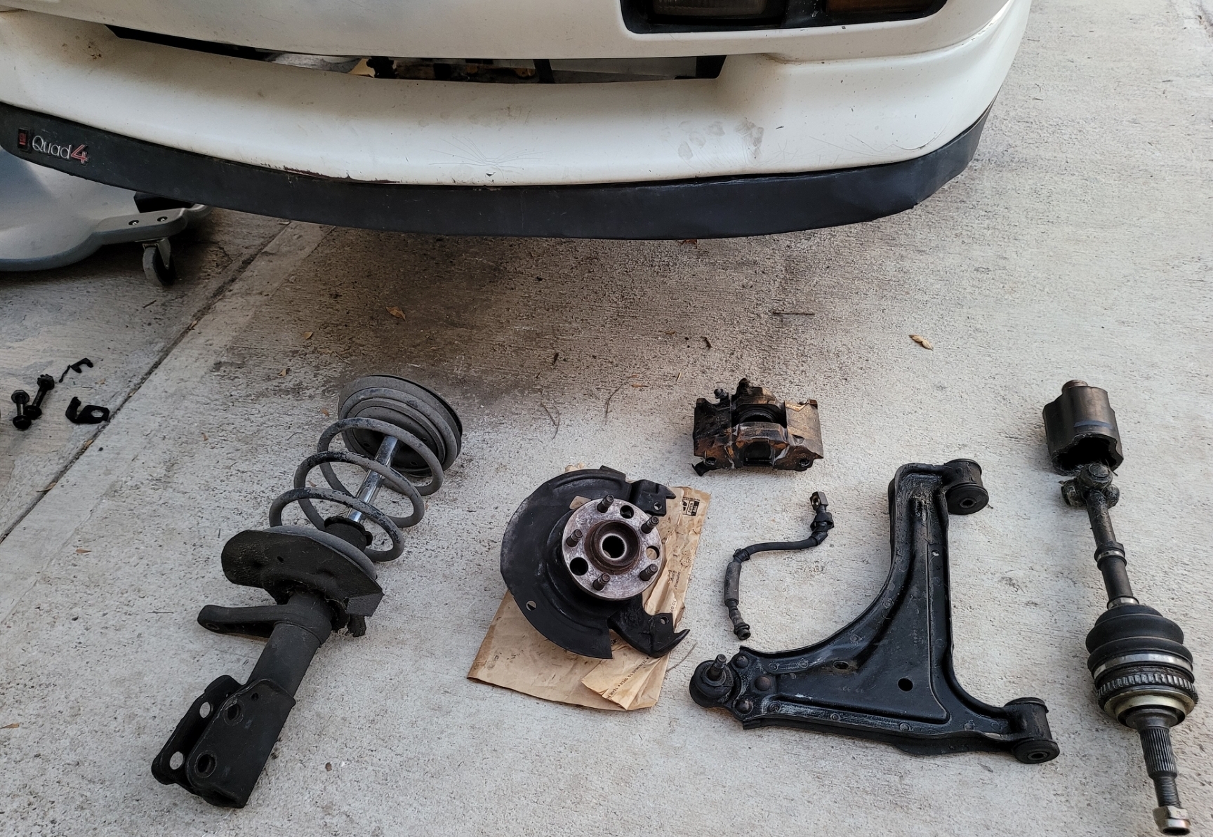

Well removed ALOT of parts! Got them cleaned and painted. Stripped one of the bolts and had to get my tool welded to the bolt to turn it!
If anyone has the part number for the transmission seal please let me know!
Thank God for someone making this tool. Removing the bolts on the struts and knuckle were not coming out until I got this tool!
