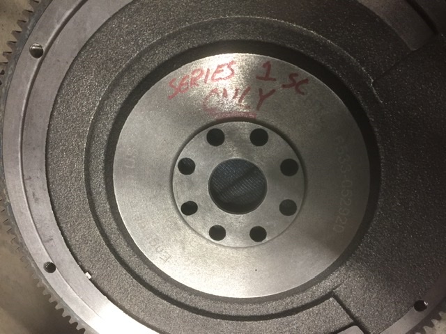

All 3800sc engines are externally balanced due to their stronger connecting rods (than NA version) and the rotating assembly requires use of the flywheel to balance it all. Ignoring this by putting a neutrally-balanced (new) flywheel on and the vibration will be significant enough to notice in the car and will trash crankshaft bearings and that $13 rear main seal that you’ve so proudly replaced when the transmission was detached. So let’s not do this and save some frustration and hard learning.
Supercharged series 1 and 2 differ in flywheel imbalance; 2 and 3 I don’t know. This is largely unimportant because to start this endeavor, you MUST have the flexplate from its first life when it was mated to the auto transmission so that the new flywheel can be “match balanced” that is, to match the imbalance of the flexplate so that the rotating assembly spins as smooth as silk, or Amsoil if you prefer that.
If the sc engines flexplate or imbalanced flywheel (if you’re on your 2nd flywheel) is unavailable, the crankshaft must be removed and balanced as a rotating assembly. You probably can’t buy a series 1 flexplate from a local parts store to buy your way out of this problem. Engines were made at the factory en masse (not individually balanced). Therefore, all series one flex plates have the same balance. All series 2 flexplates will have their same balance.

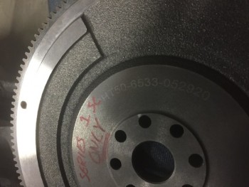

Here we have a number of options to source a flywheel to get the engine to talk to a manual trans. (Source Link here: http://pontiacperformance.net/TechArtic ... 00-V6.html )
A summary (Quote) of the link above:
Flywheel
Why not use the Stock Fiero one? - the V6 flywheel has 6 crank bolt holes, 3800's need 8. You can't use the stock Fiero flywheel without extensive mod.
Option 1: modify a F-body Flywheel: The F-body flywheel (p.n.#24503285) is 1.110 inch thick. This needs to turned down to .840 inch to match the V6 Getrag flywheel thickness. Options? - rebalance the flywheel to match the flexplate removed from the engine...
Option 2: Modify a stock V6 flywheel. Due to lack of information on the 3800 imbalance this is the 1st method I chose. I would not do it again. You need to fill the 6 crank mount holes then have the solid plate drilled to match the 8 crank holes on the 3800. They are NOT evenly spaced - 1 is off by 3 degrees to act as a key.
Option 3: make a new flywheel (installation currently in progress) Cost wise, this is not that much more. $350-400. Prints can be found on the web page below. I will be using a bolted on imbalance weight to create the balance required. This setup will be installed in less than 1 month and I'll post results then. This print can be used as is for properly modifying the crank bolt pattern on a filled and drilled stock V6 flywheel. The print will be updated with backspacing details after I know more.
Option 4: Use part of the above options, leave the flywheel neutrally balanced and have the engine balanced so that it does not require external balancing. More $, better at high RPM. As with all high performance: How much $? answer: How fast do you want to go?
Option 5: By the ACE kit. They use Option 4, but their own design. Seems to work fine in the installations I have seen. I do not like their engine mount method but it seems to work for the few people I have talked to. I don't know how hard they drive their cars. I don't see how they properly support the front of the engine. I think they only use the forward tranny mount.

If you are rebuilding your engine and have easy access, give the crank to the shop from harmonic balancer to flywheel, match the crank threads to the larger diameter and stock v6 camaro bolts and have them balance it. You’ll have the truest results. This has been done without problems. Enlarging the wrong wheel drive 3800 crank mount holes may be too large, so I recommend the M10x1.0 conversion.
Our own Rettax3 spaced the trans and engine 1/4” instead of milling the stock near 1” camaro flywheel to .84”. .84” is simply a number that has worked in the Fiero community despite our flywheels coming new at 0.80”. This spacing solves porosity issues that arise in turning a flywheel down so far! A fiero guy had a flywheel milled to .84” and revealed porosity on his AMS brand flywheel. I too have an AMS brand because they are the most forthcoming in their spec sheet. Let’s hope that mine is good. Hat tip to Rettax3. I like this.
SPEC has dropped the ball. Their aluminum flywheel made for (us) the 3800 exclusively, has >3/8” bolt holes and will be sloppier than seen in this video. Their flywheel is 1/4” thicker. SPEC provides no guidance on crankshaft-flywheel attachment. They do not sell bolts. Washer use is unknown. (Think steel wheels vs alum wheels and the bolt seat angle of aluminum vs the more flat base of the steel’s lug nut and that this is absolutely imperative to have handled). Loose bolts have resulted from heat lessening the clamp load as the aluminum creeps it’s way inward on the mount holes. Steel spacers could fix this but my 6 local machine shops don’t like this idea enough to work on my stuff. Bear in mind that good aluminum loses almost half its strength at 400F deg. How hot does your clutch get?
West coast fiero sells a billet steel flywheel to avoid the porosity issue scare mentioned above. Bolt size is custom (tell them 5/16” bolts will be used for 5/16l bolts and get smaller than 3/8” holes) as they take your old one and provide the service of match balancing. My local machine shops don’t want to touch a cast one for fearing of compromising it. They will however work with a billet one. The series 1 could have 5-8 holes to mount it. When you see the pic of the billet series 1 from west coast fiero, it lacks a bolt circle so that it WILL work with any series 1 - 5 bolts or 8 bolt types. Late series 1 (my ‘94) and later have 8 mount holes.
Pertaining to option 1 above, using an oem (cast) ‘98-‘02 v6 camaro flywheel and milling it down to 0.84” thick measured from the crankshaft flange face to the clutch mount surface, we are left with more to be desired. The mounting holes are 3/8” diameter and the crankshaft of (all 3800s?) is 5/16” diameter. The crank uses 5/16”-18 bolts. We then see the result (slop) in the above video. ‘FieroRog’ makes flywheels for all series with balance. Hat tip to you and a public thank you! FieroRoger made my flywheel.

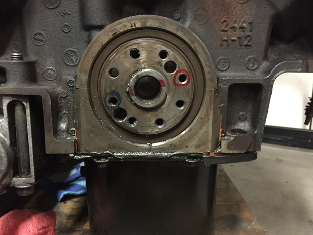

What about tapping the crankshaft to use 3/8” dia bolts?
Upping the bolt size to 3/8” dia DOES interfere with having the 5/16” threads. (Source ARP... sourced in thread link to follow) which means, that in recutting the threads does not give 100% material to use due to similar sizes. They overlap. However, a metric size does allow the conversion without overlap.

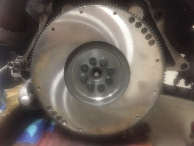

Now with all that on the table, let’s keep going. Am I willing to risk using 5/16” bolts on the “serrated death wheel” spinning close to me housed by a CAST (brittle) aluminum case and then thin unibody sheeting? I may race. I may (absolutely will) tach it up just having fun. The car doesn’t know the difference, so I’m hoping for something better.

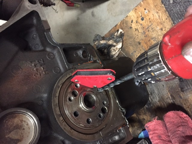

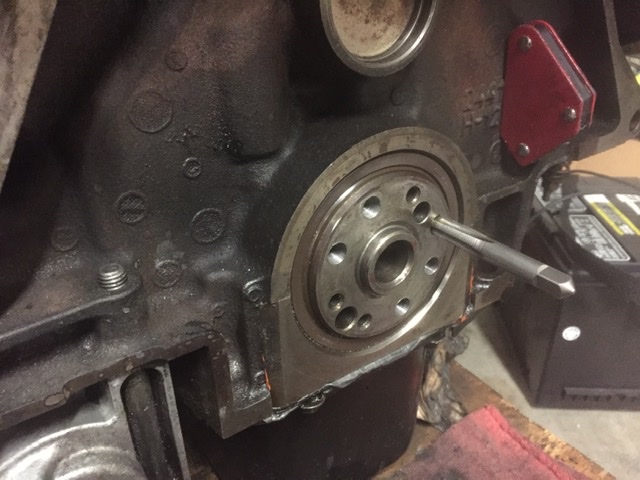

The next link shows a mod of converting the mount setup to M10-1.0. These have a larger diameter and as of this writing has withstood years and miles with more power than I’ve seen.
Let me reflect on this thread: http://www.fiero.nl/forum/Forum2/HTML/137293.html
This shows how to correct the slop using a larger diameter bolt. This is where I am gravitating toward being the right answer.

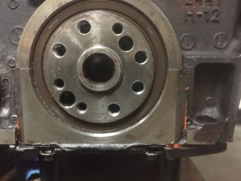

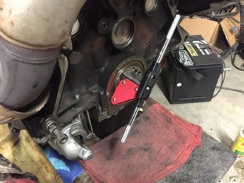

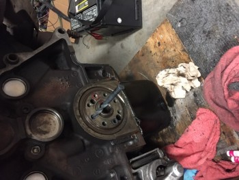

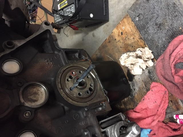

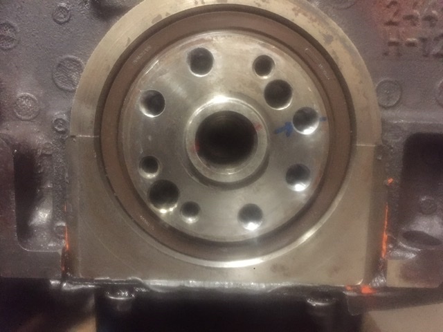

Coupling the idea of min sidewall thickness of the crankshaft flange concern with the existing large non-mounting holes in the flange, I have decided to drill and retap the crankshaft partially - meaning that I will use the 5/16-18 factory bolts where edge thickness is thin, and convert to M10 on the remaining holes. This also and perhaps most importantly minimizes risk of me messing up the drilling and tapping of the crankshaft by hand with it in the engine.
Yes I realize what I just said.
*************(Post the pix doing this here)*********
Here is my version of the above link performed April of 2021.
Thanks for the bandwidth.
Andy

Drilling/tapping in-engine... Wow. Looks like you did a great job on it too. Probably a lot safer for it than handling the crank around a garage with power-tools and metal shavings. Thanks for sharing your experiences on this. :good:
