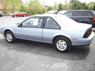

Has anyone ever heard of it happening to one w/ a 5 speed? I found one w/ 150k on it. It's a 96' light blue and in amazing shape. It's on a used car lot here in p.a for $1995. If you go to cars or autotrader.com and search for Berettas you will find it. Theres like 20 pics of it. Tell me what ya think and if anyone's ever heard it happen to a 5 speed. If nobody has i just might buy it, not for that price though, I'll try for like $1300-1500

engine would'nt get beat on as badly. I was pickin' up a rim and the guy who works at the place has a 93' base w/ a 2.2 5 speed w/ almost 200k on it and he has never had a problem with the head.
I got the guy who has the 96' on his lot to settle at $1500. I'm gonna get it i think and just hope the engine holds up.

Here it is
