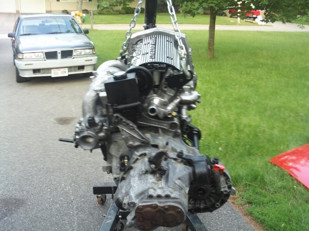

Here's a picture of my 94 Quad Getrag trans for mount location reference in comparison to this trans.
I'd personally only pay maybe $100 for one of these "new" transmissions for parts alone. IMO it's way too much work for MOST people to make these work in your car.
