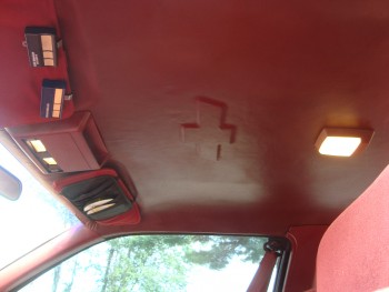

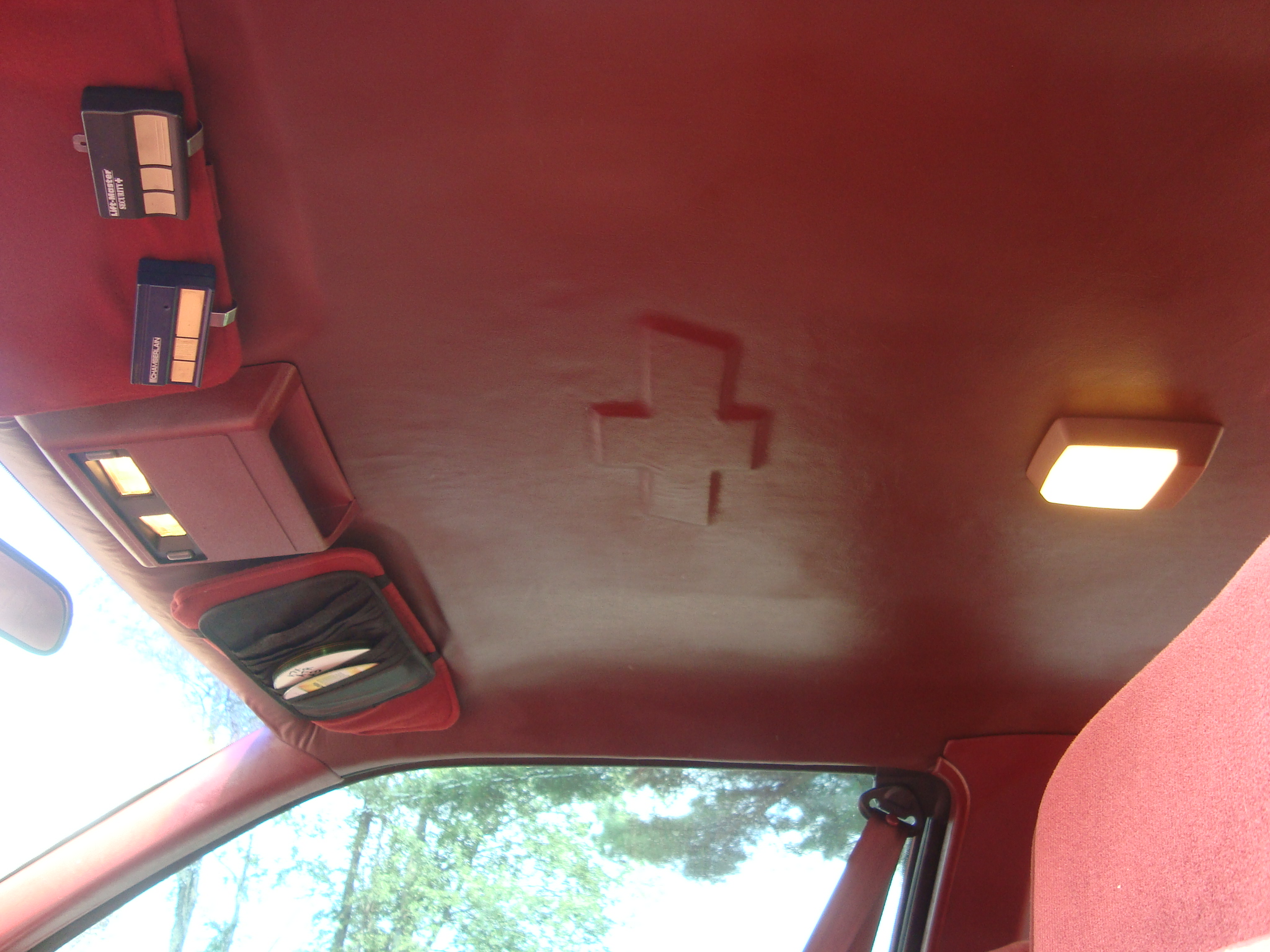

Re: How To: Re-do your head liner
Thanks for the guide barry, i think mine turned out great, just so happened that my local craft shop had 7 colors of vinyl and this was one
Very cool chevy symbol. Did you cut it out of foam?
Yeah two layers of some cheap walmart craft foam with the sticky backBarry wrote:Very cool chevy symbol. Did you cut it out of foam?
