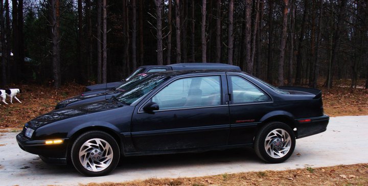

This is car #1
This is car #2

Well just a small update...Still pretty much at square 1.....I had a friend come out today to hook up his scanner to car #2...(black one)...and it pulled up a bad O2 sensor(took care of the richness) and MAP sensor....replaced both those along with the PCV valve...and NOTHING...starts,seems kinda louder than usual though,but the minute you give it gas....it dies out. You can still hear a miss in there as well.....so as stated..STILL AT SQUARE 1....as for car #2,it's still in the shop,had new ICM,CPS,Rail,and still nothing...it has good fuel and oil pressure,so that's not the issue,but same thing...will start,run 10-15 seconds,die??? He's now in the process of checking wires and whatnot......THIS IS MADNING!!!!!!!!!!!!! %) :cry:
