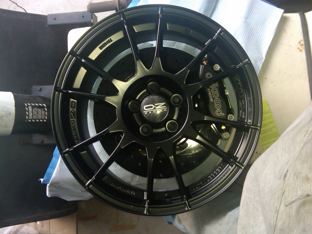

Got to test fit my rims for the wilwoods and powdercoated the timing cover.

Is that a Wilwood J-body kit?88_GTU wrote:Got to test fit my rims for the wilwoods and powdercoated the timing cover.
Thats a very nice option for those who want to keep the 5x100, use a 16" rim but want 12" rotors.... weighing a measly 10.8lbs... BUT you need to put up 1k for the drilled and slotted kit.
It is the j-body kit. It fits the 92-up knuckles perfectly. I will have to get custom stainless brake lines made but that was the plan anyway. I was really hoping they would fit under my GTU rims without much of a spacer but that didn't happen. They do however fit quite nicely under the 16" OZs that also happen to weigh 7lbs less per rim than the GTUs so I'm not really complaining. If you can get past the steep pricetag they're actually a great mod.

The kit doesn't come with brake hoses. There is an option for the cavaliers for another $150 iirc but I'm not positive that they have the same ends as the beretta. When I look up the part numbers for the 99 cavalier front brake hoses they are different from the beretta part numbers. I havent taken the time yet to stop at a parts store to compare the 2. I'm also going to be running an FE7 front bar so I'll have to figure out the routing for the hose. The caliper and rotor part numbers were the same between the 2 cars so I knew the rest of the kit would fit. Do you happen to know the offset for Roberts cavi wheels? our stock 42mm was not even close to working but the 35mm OZ clear perfectly. There may be about a mm of room to play with there but not much more.

Why was the stock 42mm not working? did the rim face hit the caliper? If so that would probably be more of an issue for his since I know they seem tighter in, or they are probably the same 42mm, if not 45mm.
Cavi guys say that they can still use stock rims on this setup though, so thats what made me think it could work.
Not sure what end your hard lines have but you could probably do what I did...
I did these fittings on all 4 corners and just got steel braided lines, -3an to the right Banjo for the caliper and used those. The fitting is a 989534ERL Brake Adapter 3an to 10mm x 1.0 Female NOT Inverted Flare, aka bubble flare.

Yeah, the 92+ knuckles are needed. thanks for the advice on the fitting Modified! I'm going to have all 4 lines made as I'm working on the neon rears also so that helps greatly! As for the wheels, with the GTU and GTZ rims it was the face hitting the caliper as these are 4 piston and much wider than our stockers. I'll try to snap a pic if I can find one of the old calipers layin around.

Here's 2 pics of the setup. Notice how much further the caliper sticks out from the rotor hat. It's a pretty large difference from the stockers.
