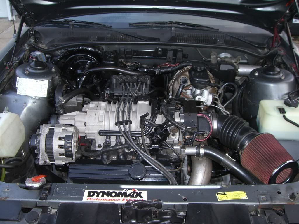

Mine was a 1994 Supercharged 3800 engine that I installed in my 88 Grand Am. I ran it with no EGR and had no issues.
