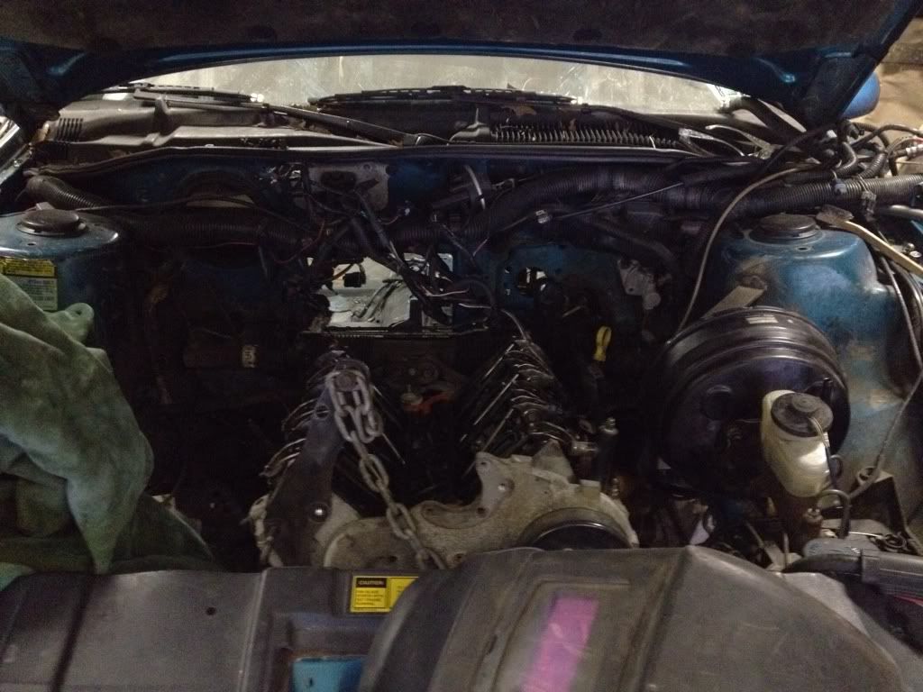

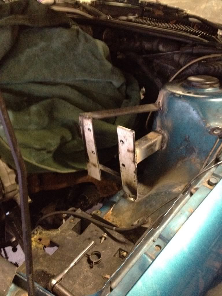

Supra clutch master cylinder mounted. Has a resivour on top... I may remote mount it for more space depending on how the brake linkages go
Supra brake booster mount
All mounted up.
I went with supra stuff because it has decent sized brakes right from the factory. That way I can upgrade my front brakes and not have all the bias issues I had when it was FWD.
I have a bunch of shafts and bearings and heim joints that I am building a proper brake linkage for. Its much better than the "bent rod" manuver that a lot of the bimmer guys are using.
I am going to adapt the supra slave cylinder the the camaro t-5. The stock gm plastic crap is just begging to become an issue.
