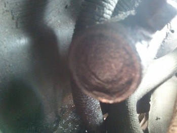

sounded like a bottle of champagne popping open! then the lack of power assisted steering... i thought it was worse and a tie rod broke or something! really glad i can still tone up my arms with the 'armstrong steering'!
i'll get a better look at it in the morning, but looks like a cap on the passenger side end of the rack has popped most of the way out... hoping i might be able to reseal and flush it out maybe... i'll try that before replacing the thing... dont have money for that really right now.
i have had hard steering, mainly in the winter, and a fresh slight leak just started a few days ago, i hadn't got to fully looking at it yet, since it as just up on the jack stands for a full brake job last week! figured it was the cooling loop that was rotting out...

I had this happen, you won't be able to reseal it unless you weld it.
I made a heavy plug to fit and mig welded it in.
That area gets rusty.

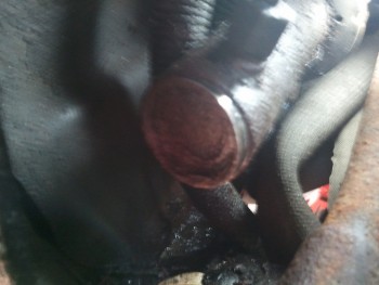

well, got to it today... so this is the passenger side of the rack... there is a cap that popped partially out, and blew all the power steering fluid out with it... (surprisingly the power steering pump is very quiet when there is no fluid going through it! on the downside, i may need a new one after driving it dry a few days...)
i tried quickly (and without damaging the 'sealing' surfaces) to pull the cap right out, and take a look inside, and add 'coldweld' inside then hammer the cap back in... but it fought. so i just hammered it back in, and then a bunch of tack welds. until i ran out of wire! (please excuse my globby welds!, i should have turned down the wire feed a bit... then i might have had enough to finish...)
so i finished it up as best i could, then painted it up quick. added fluid and started it up. adding fluid while it's spitting back at me... and then about full, and turning the wheel to work it through, and there is some spots that didn't seal up on the cap... seeping out very slightly. so i put the layer of coldweld on the outside... wait for that to dry and start it up again in the morning and hope the pump quiets down a bit... we'll see

also when i shut the engine off after filling it up, it overflowed quite a bit... quite frothy currently, so when i start it up tomorrow, i'm sure i'll deal with more of the same.

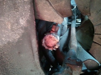

so i ran out of welding wire after my excessive glob tacks... and then ran out of coldweld also... missed one spot right on the bottom, so got some fresh stuff today, (and after driving the car again today... not a huge leak, but a drip every 5 seconds or so when running). it's now drying after another coldweld bout... hoping for no no more leaky, but will be fine with lite seepage... i'll replace the rack if and when i do an engine swap (with 5 spd! that's sitting in the garage waiting...).

well, this is so far... i did get all the way around with my welder, except for a couple small spots. highest amp setting on my 110 volt mig. when running it was just slightly seeping from 2 spots before i used coldweld to seal the whole cap over.
