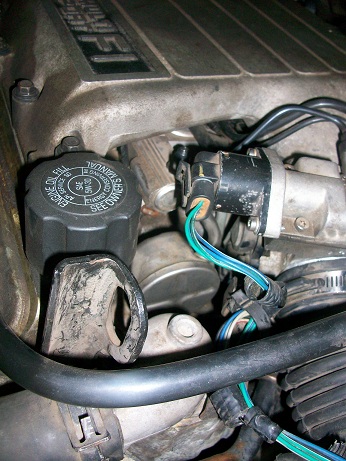

MPB, the fuel pressure regulator is not in the same spot on a 3.1L as it is on a 3100
This is what it looks like
its under the upper intake in the center
But I also agree, go through your ignition system first, there is a higher chance that's causing your current issue than the fuel pressure regulator. When they typically fail they stop holding pressure so it runs leaner, not richer. Also check into the coolant temp sensor, Have the ECU scanned to see data and see if the coolant temp is reading properly. If its failed and reading -40 the car will run very poorly and rich.

Thanks, yeah now I remember that. So what is that thing with the "+" on it? I didn't do any intake work on my old 3.1. Which I now find strange because the engine had 213K on it.
