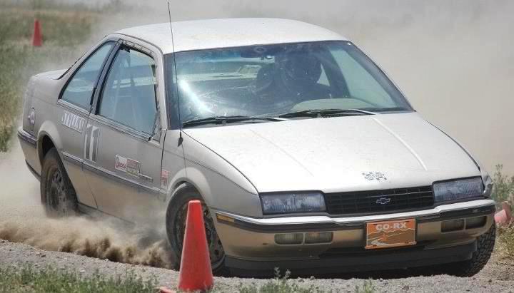

You above photo is also showing a lot of body roll... What do you have for sways on that car? That should help some by getting possibly a Z51 on there and maybe a larger front bar, but being auto-x you don't want to over do it. FE7 would be the best option for the front I believe.

To clarify, the rear shocks for a SAAB are direct bolt ins? I read over that thread once, but not in too much detail. I don't think I need the adjust ability that a custom built strut would provide, hell I'm not sure I even need it in the rear! Not looking to go crazy with the car just yet. As you can see from the above pic, I just need struts that actually do something!
As for the body roll? I have it all on there:

I have a shock tower brace en route to my house as I type as well. I think you are not seeing body roll, but the absolute lack of a strut that performs to any capability and half dead shocks. Bear in mind that was a downhill hard left turn.

And yes thats body roll.. The car is trying to go left and the body is rolling to the right... Granted yes this can be fixed with new shocks/struts if they are completely blown, but KYB is about the best bolt in over the counter option for you. That's why I recommended the Koni stuff and I wasn't sure where the rest of your suspension stood so that's the reason for the swaybar comments.
