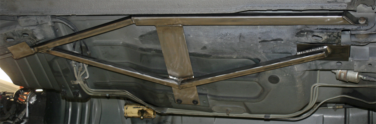

judging by the welded subframe connectors on my camaro, i see no reason as to why you cant put something similar on a beretta. as to whether or not they do anything is another story.

mine are this style...
on a beretta you could make them pretty easy if you have a welder. i think you would need something than just straight steel ran front to back. with some diamonds and triangles. would be pretty cool if someone pulled it off.

Interesting... I'll have to look the next time I have it up on the lift to see what space there is...
Just looking at woody's photo though the big problem is how pushed down the floor pans are... You would have to run below them plus there isn't really any good mounting point in the middle of the car so you would almost have to make a full X to get something out of it.

i always thought an inner cage might work better. like bracing the floor in the back or a mini cage brace from drivers to passenger side almost like what people do to put in racing seat belts.
