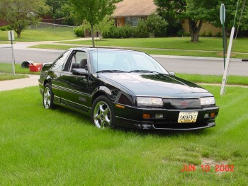

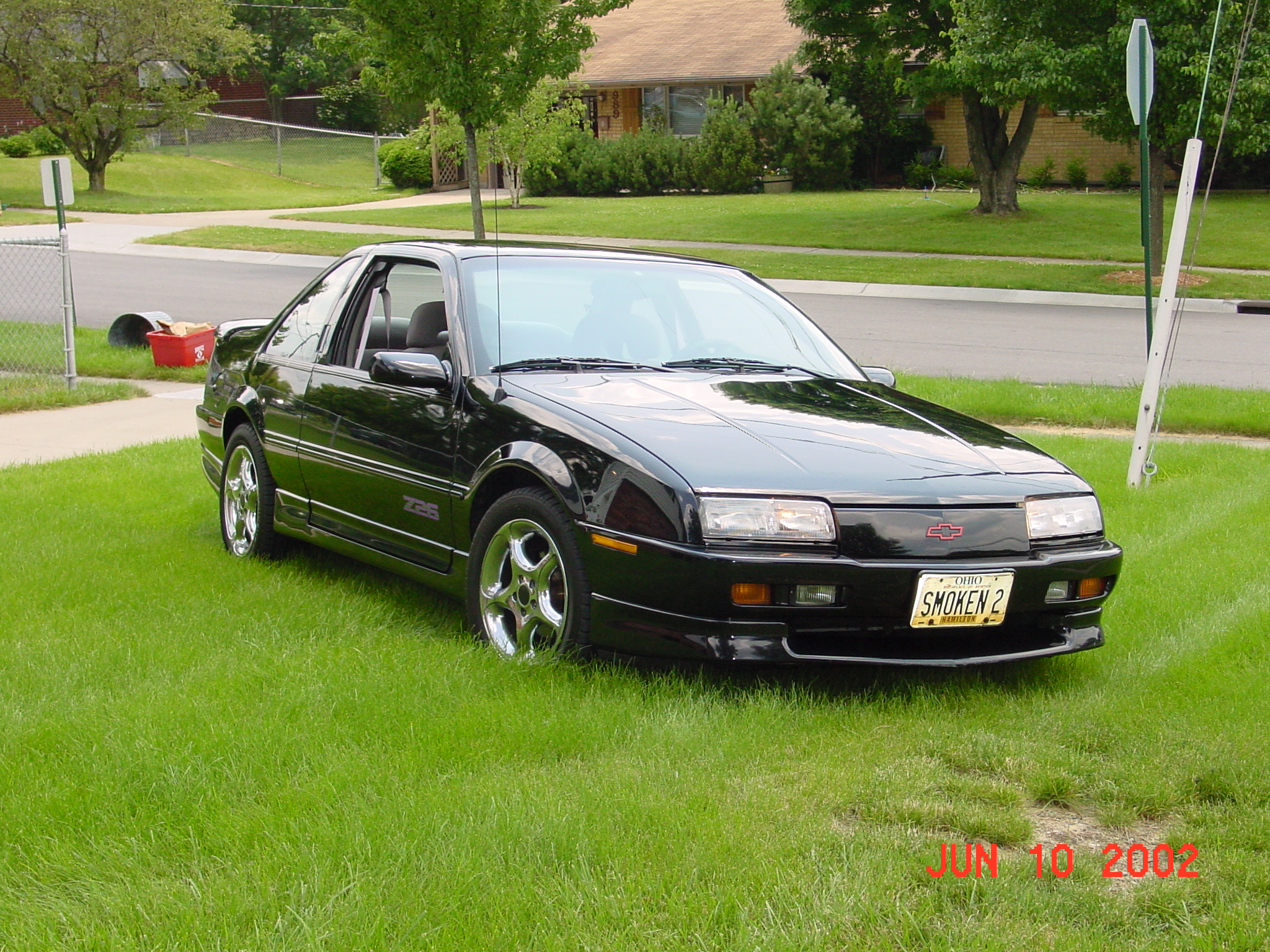

I loved my Beretta and that why I kept it all these years. It used to be my hobby and I used to be on here all the time. Well I am returning to get my old ride restored to its former glory. It has been sitting for about 6 years and I am finally ready to start rebuilding it. I wanted to create this thread simply to get help on what to do with it and how to do it. It is a 95 Z26 V6. The last time it rain the car ran fine shifted fine but had major break issues. I think the best way to do this is to list the good and the bad and take suggestions on how to get this thing to stage one which would be back to decent shape. The second stage would be to fix everything back to close to perfection. The third stage would be to increase performance. I am not apposed to doing some of stage three while going through the first two stages but it isn't the primary focus at first.
Good
120,000 Original Miles
Transmission Seems To Be Good
Car started 3 years ago no problem
Bad
Car hasn't moved in about 5 years
Rust above the front window
Rust in the door sill corners
Breaks don't work. Seem to not pressurize.
Water got in and the interior has mold on it especially seats.
Dash is damaged by the sun.
What I think it needs part wise from day one. (Hopefully you guys can help me with this stuff.)
Breaks fixed (Maybe break lines I vaguely remember someone saying this many years ago)
Seats (Especially Front)(Maybe restored?)
Dash is sun damaged
I am sure once I dig into this I will find tons more stuff.
I am open to suggestions on basically all of the above. I am trying to get this done by my ten year high school class reunion. I graduated in 2003 so I do have a bit of time. The car used to be awesome and I actually remember it getting some good recognition here when I was in high school. Please help me bring my first car back to its former glory.
Wish me luck I am going to try to get this thing running next week for the first time in 3 years. Oh with that being said is there something I should do before cranking it? I was thinking draining the gas change the oil etc. Suggestions???
Thanks
