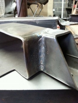

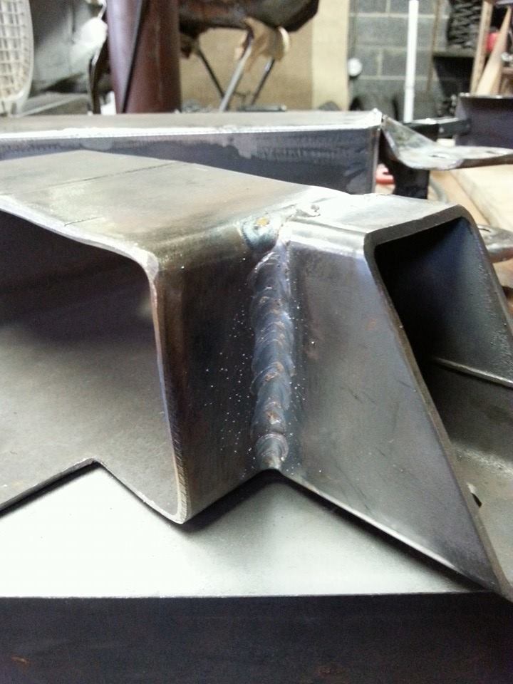

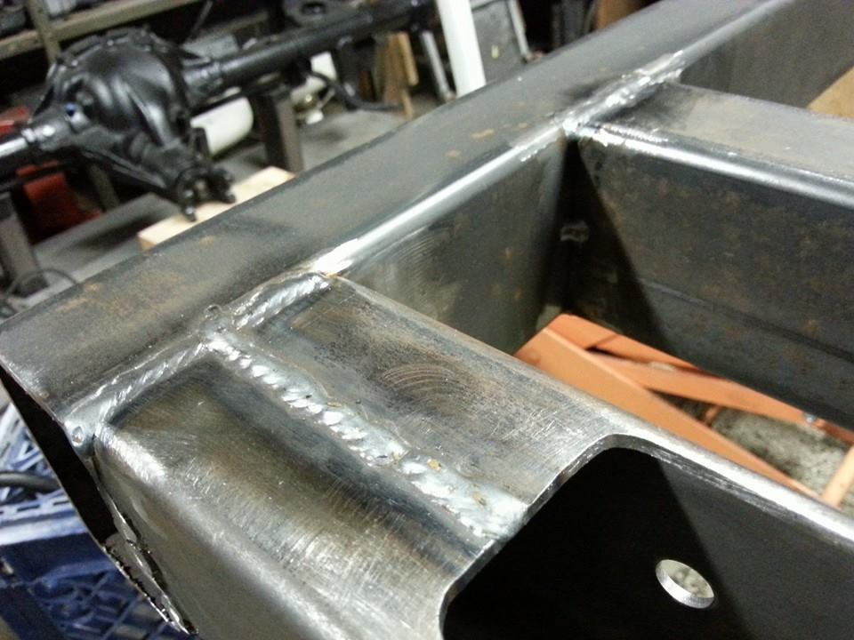

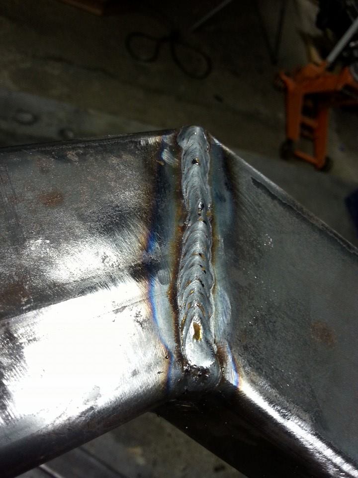

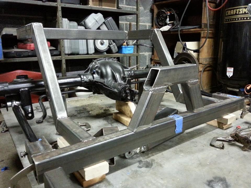

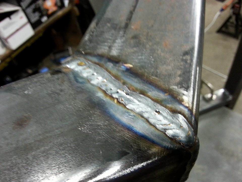

welding !!!! All rear sub accessories/suspension brackets welded and rear sub welded together ......still soooooo much more to do!!!!!!!

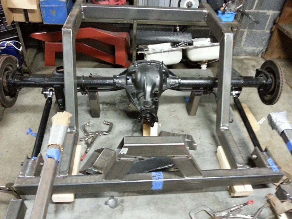

Post by jjanke »

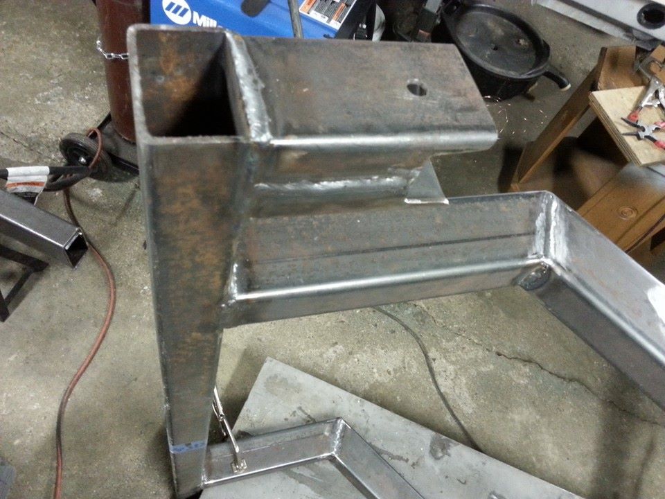

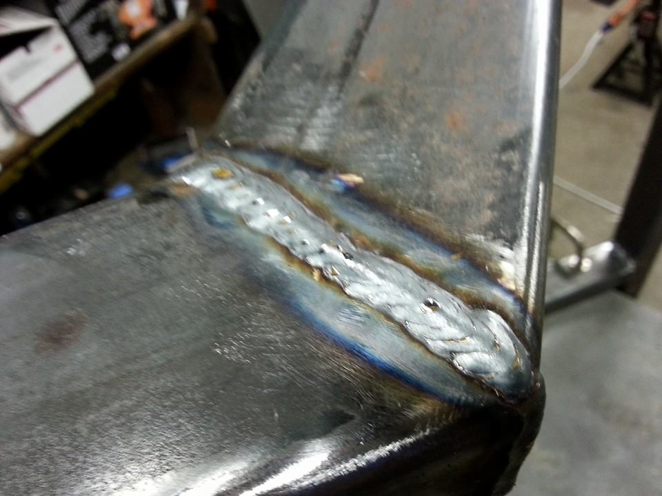

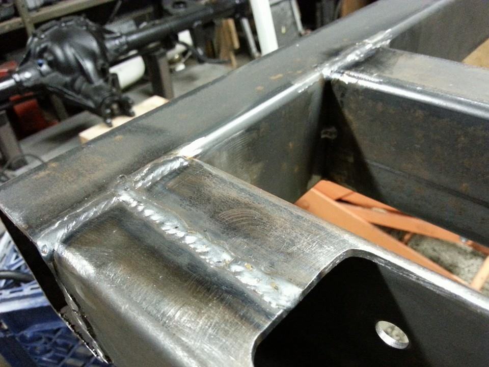

making progress

It's nice to see some really good welds on a project like this.

Looking good. I love to weld the heavy stuff...

Nice welds.

bonecrrusher wrote:Nice welds.
X2, or X3, or is it X4 now? :D Looking good.
Re: Beretta Z28
did anyone mention those are nice welds?

Those welds make mine look like a 4year old hocked a loogie on my work lol

hahaha thanks guys .... obviously i tried to photograph the better looking ones of the bunch.........the thick steel welds like butter....... plus the miller 211 is a beast.......best machine ive used....

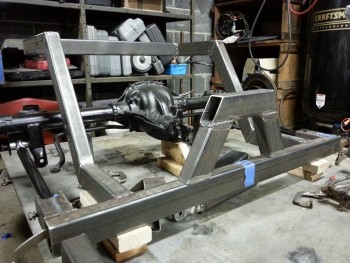

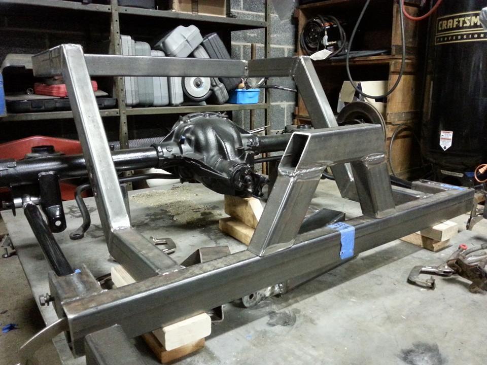

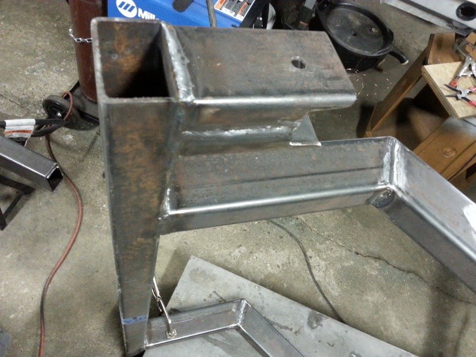

Started work on the drive shaft bump out for the rear sub cross member

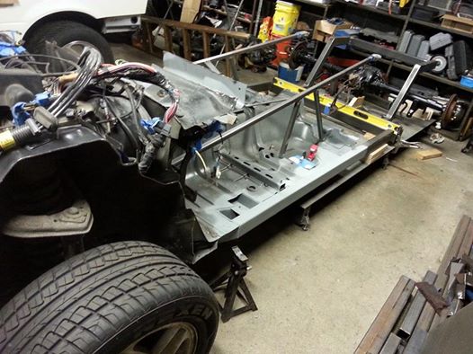

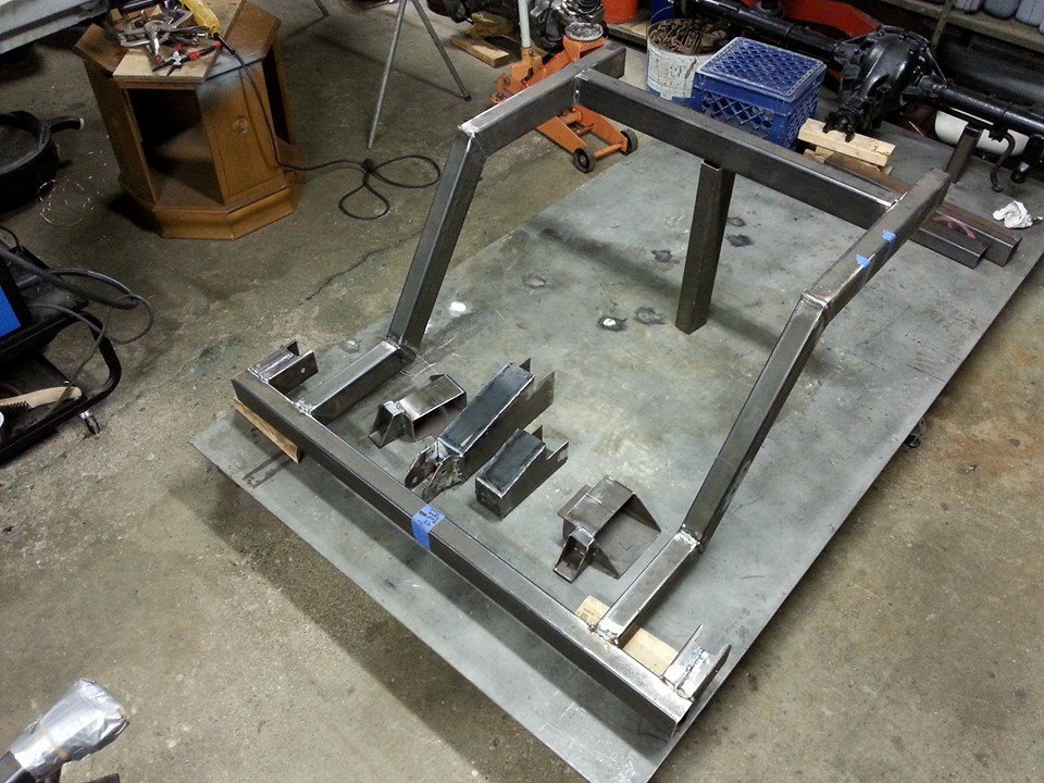

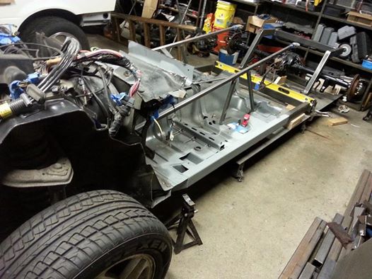

Actually set up the front and rear frames next to each other for the first time on the surface plate/welding table.....square and level to each other.........soon they will be one

Is that triangular kickup going to blend well to the floor pan?
On the LS swaps I have seen in 68-72 A-bodys look terrible because they put in this gargantuan trans tunnel not leaving much room seats/console/etc.
Its starting to come together! You going to plate up those open ends?

yeah i will seal up all the box ends.......gonna start adding the gusset plates spanning all the butt welds soon too.......the tunnel bump will encroach into the interior but only because i didnt want it to encroach into the tunnel space at all.... for obvious driveshaft clearance.......keep in mind no interior stuff is going back in carpet, trim, etc....and i will prob be making custom seat brackets to put the racing seats back in.......
