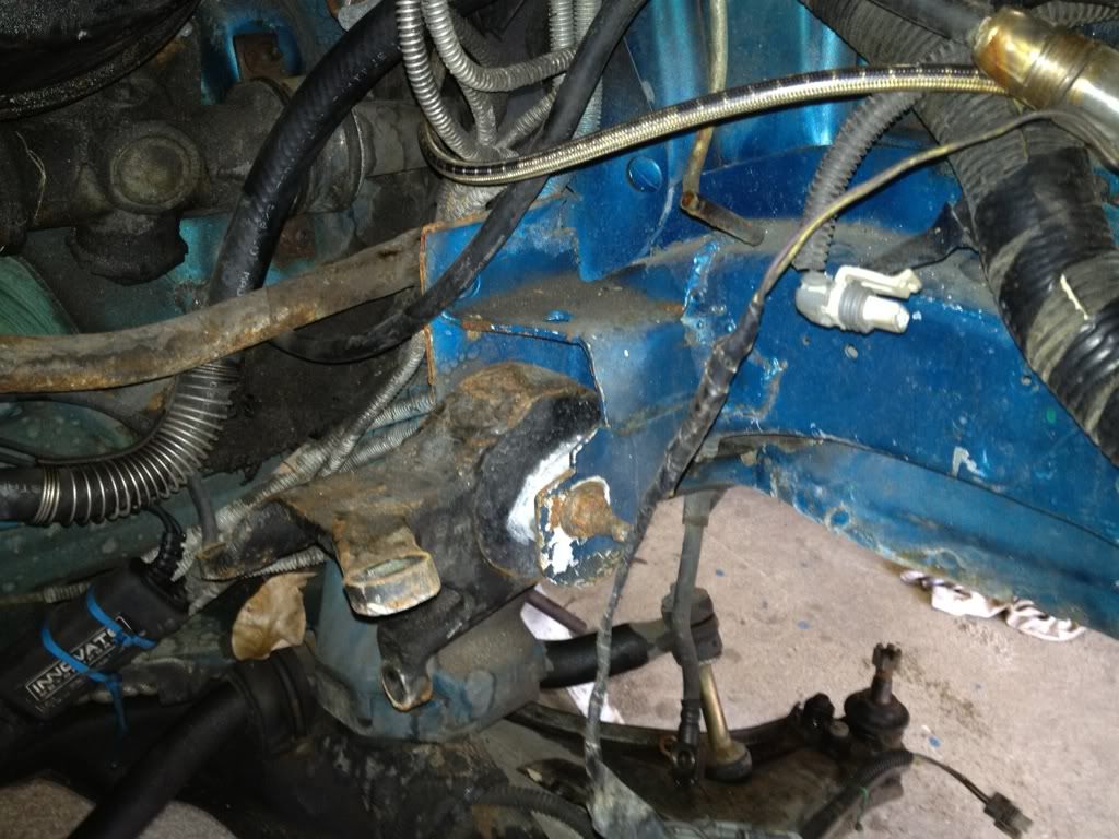

It'll test if that crossmember will flex under load and those welds.... Not trying to bash you at all with the setup i will go different in some aspects of the swap since like on facebook i just found a 240 rear end and a buddy in florida is doing the swap too, keoki? on here joined recentlly. I just dont want any unfortunate accident with that rear barring all gm converted rwd cars from maybe competing in fd events is all.....

Wow the right way you can tell from the fricken pictures that thats not that "right way" to do any of this crap. and i bet my critisism does get annoying but thats who i am so idgaf

Think about the forces that this crossmember sees. Then consider the way the subframe is mounted in the 240. It sees mostly side to side forces, in which a 22ga member would even be plenty, I used 1/8". Really the only up and down it sees is torque from accelerating and braking. I feel that that is minimal compared to the side to side forces.
Like I said I am building this car to take a beating and looks come second. If you ever build a rwd beretta you can use as much expensive fancy steel as you choose, it's your project.

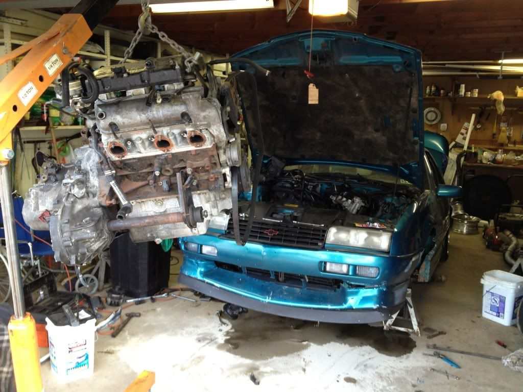

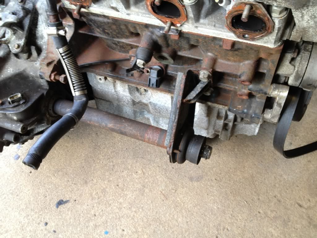

Pulled motor today. A few points to note:
I need a rwd timing cover. Was gonna modify the fwd one but it's easier to do it with a rwd one.
Our brake boosters are huge and are totally in the way. This issue sucks.
Tunnel cutting is going to be a lot of cutting haha
People that want parts please pm me everything is available now
