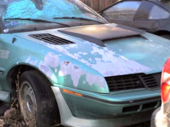

This was my first 'Retta, the '90 Turbo.  She is lying, she actually has a 3.4 intercooled turbo, not a 3.1...

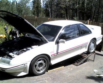

Here is my Super Charged 3800 II GTU, after the engine and five-speed swap, but before the six-speed conversion and the theft of my GTU rims (she has been wearing GTZ wheels for a few years now).

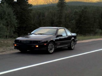

This was (is?) my '95 Z.  I don't have many pics of this car, and I have to go back halfway across the country to get her again, but I really do want to.  She has had a VERY hard life, but still has a lot of life left, too.

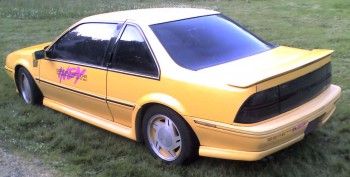

Here is the prettiest of the Berettas in my family.  So far mechanically stock (!), she is slated for a five-speed swap, and will likely get a low mileage 3.4 TDC engine I have from a Z-34 Lumina.  I might try to use the correct Muncie/Getrag 284 for that engine, which will need  custom or hybrid CV joints, or I might save that tranny for my Fiero and just use a 282.

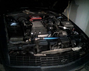

I did a full write-up on the 3800 swap back on the bstuff site, which is gone now, and I had it all stored on my old computer, which was stolen about two years ago. I can answer questions for people on it, but basically I proved the swap could be done with the tools necessary for any engine swap, a power-drill and a hack-saw (I also used a MIG welder and a porta-band, but they weren't strictly 'necessary'). I also made my wiring-harness as a plug-in to the Beretta's engine-bay wiring, so there is nothing permanently modified on my GTU, except for two holes in the right sub-frame, and one ground-wire from the fuel-pump was cut and spliced. This was not strictly necessary either, as I ran the 3800 on the GTU's stock pump for about a year before swapping in the 3800's multi-speed fuel-pump control and a Bonneville SSEi 3800 SC fuel-pump. I also cut-out some of the ground effects, where they were cracked anyway, for the exhaust-outlets, one on each side. I do have some more pics of the cars on here, I think I have some in the 'Members Rides' section.

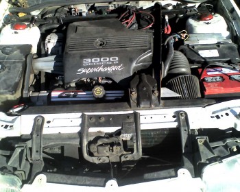

Here is a fairly recent pic of the GTU's engine-bay.  I have since replaced the missing 'u' from the valve-cover though.

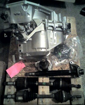

Here is the six-speed I put into the car (before modifications).

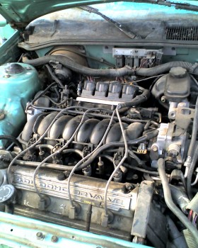

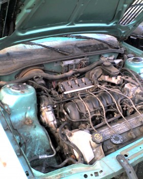

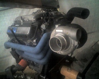

My '90 Turbo was upgraded with a 3400 block and ported-out 3.1 MPFI Turbo top-end, modified for roller-rockers and 1.5" primary headers feeding a new Garrett T-4 externally waste-gated turbo-charger. I've been fighting chronic oil-leaks from the turbo's supply-lines, and have been playing with different instrument clusters for it, so it hasn't gotten much run-time since the swap was finished.
It took two tries to get this engine working right in the car.  I bought it from the salvage yard for $60 with a 'blown head gasket' that was actually a blown-out LIMG.  I didn't know that it had already spun the rear main bearing, so it developed no oil-pressure once warm.  I pulled it out, and later re-built it into this.
In the car now.  It runs like a monster, and makes almost as much torque as the 3800 SC (pushing 300 foot-pounds, or more).

The Z-26 was also lying about her displacement -but the other direction. She actually has her original 3100 block, but with replacement heads and a 3400 intake and TB, modified to clear the 'M'-code 3100's taller valve-train. EGR will never be functional on this car again, but the PCV was actually hooked back up once the elbow was replaced.
Not much of a 'swap', but neither is a full-on 3400 conversion, IMO. :pardon: At least not into the later-model cars where it bolts right in. In all honesty, it would have been easier for me to just swap a new engine into this car than to pull the engine apart inside the bay -it need both heads replaced, and one piston had impacted a valve after the head was so badly over-heated that it dropped the valve-guides out. Pulling a 3X00 pan while the engine is still attached to the auto-tranny sucks, especially in sub-freezing January temperatures in the middle of the night! :wink:
