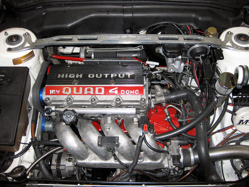

The car is now back together with new lighter valvetrain and 224/430 cams.
Also got rid of the narrow band o2 emulation for ECM, and installed heated o2 for it. And added the wbo2 to ALDL mod using A/C input on the ECM. Excellent idea, who ever first thought about that...
Sorry no pics, no need to since it looks the same as before?
After changing coolant and break-in oils, I'm going to do cam break in run of 2500rpm @ 30min, also need to buy ZDDP additive for that first.. If the fuel from 2009 is still usable
Let's see next weekend.
After the break in is done, i still need to adjust few things here and there, but it's drivable again. In case nothing breaks.
I am getting rid of the crappy summit breather catch can, that thing is a total failure. Working on my own design to replace it.
Also I am running this car without power steering as a test for now, i hate how i could steer this car with one(1) fingertip, as the black car needs whole hand for some reason, i like it better that way. Only difference in the setups is the fluid cooling loop on black car?
I may also swap the fuel pump and add relayed power for it.. and those rear axle bushings, let's see

Minor changes in engine bay, removed power steering, build new breather catch can and steering fluid expansion tank from stainless steel. I did not cut the power steering lines yet, in case i will find the steering too hard, i can put the pump back in.
I also have idle video on Facebook behind this link, you can see it if you are friend, or friends friend of mine, that should cover most of the old school members. I am not putting it to Youtube. (don't ask).
